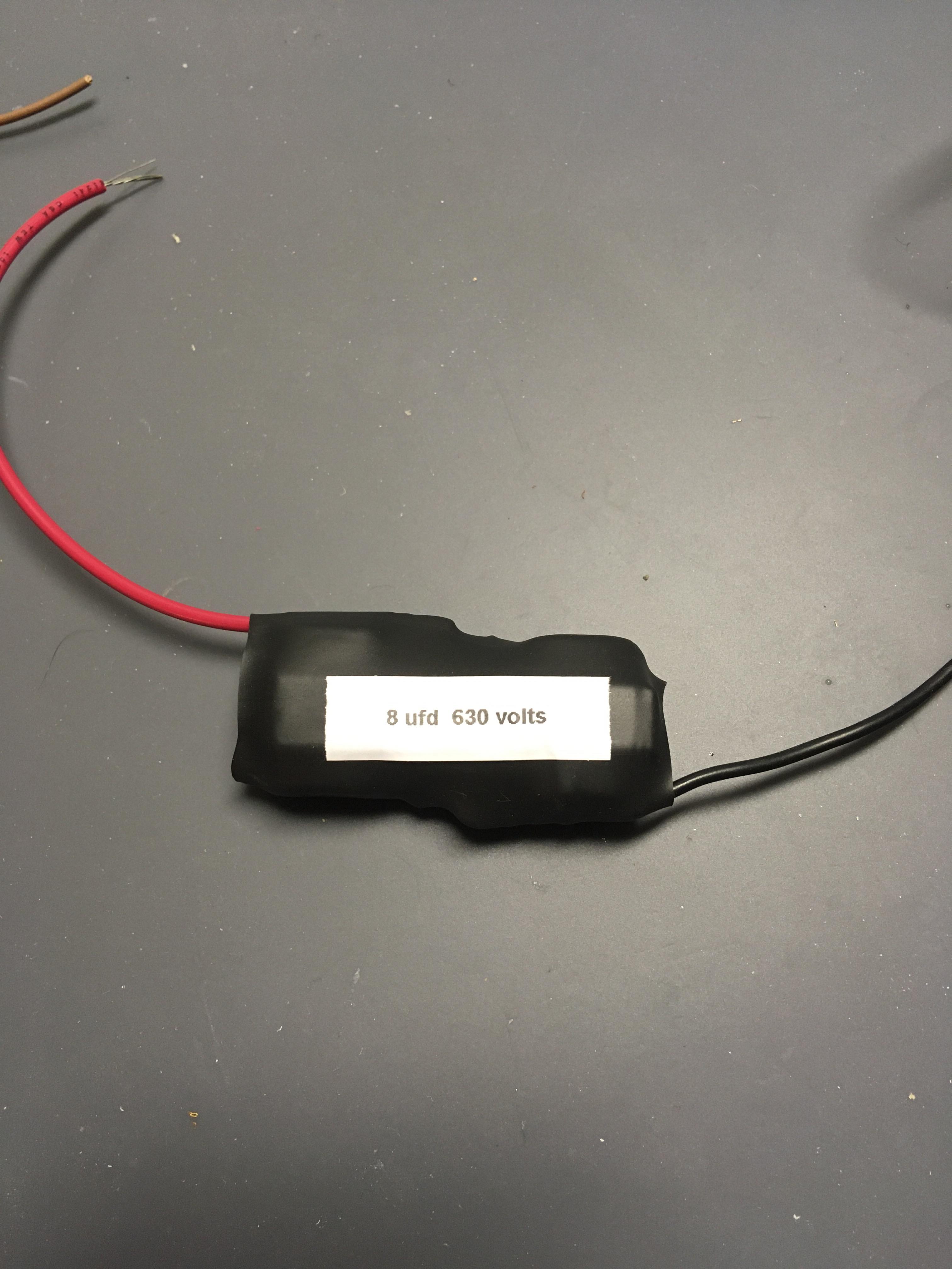

Well, I am currently working on my Philco 610b after about 20 years the original electrolytic capacitors that I installed sprague Atoms one went bad so I decided this time to use Film capacitors .
I replaced two of the 3 capacitors they were 8 ufd so I used two 3.9ufd at 630 volt.
Well the question is The 3rd capacitor is a 16ufd electrolytic anyway I was planning on using 3 4.7ufd capacitors in parallel doing so it would add up to 14 ufd would you think I would have any issues with using that value .
Here is my neat little package that i made up to fit into the original 8ufd electrolytic cans .

well, the cost is not the issue and as Ron said they will outlast me this great since some of radios might only be used once a month this prolongs the shelf life and the stress on the set there is no loss .
So Ron 14ufd Should do just fine then because their tolarance is fairly wide like MrFixr55 pointed out.

Anyway I ended using 4 3.9ufd film capacitors in parallel for total of 15.ufd
