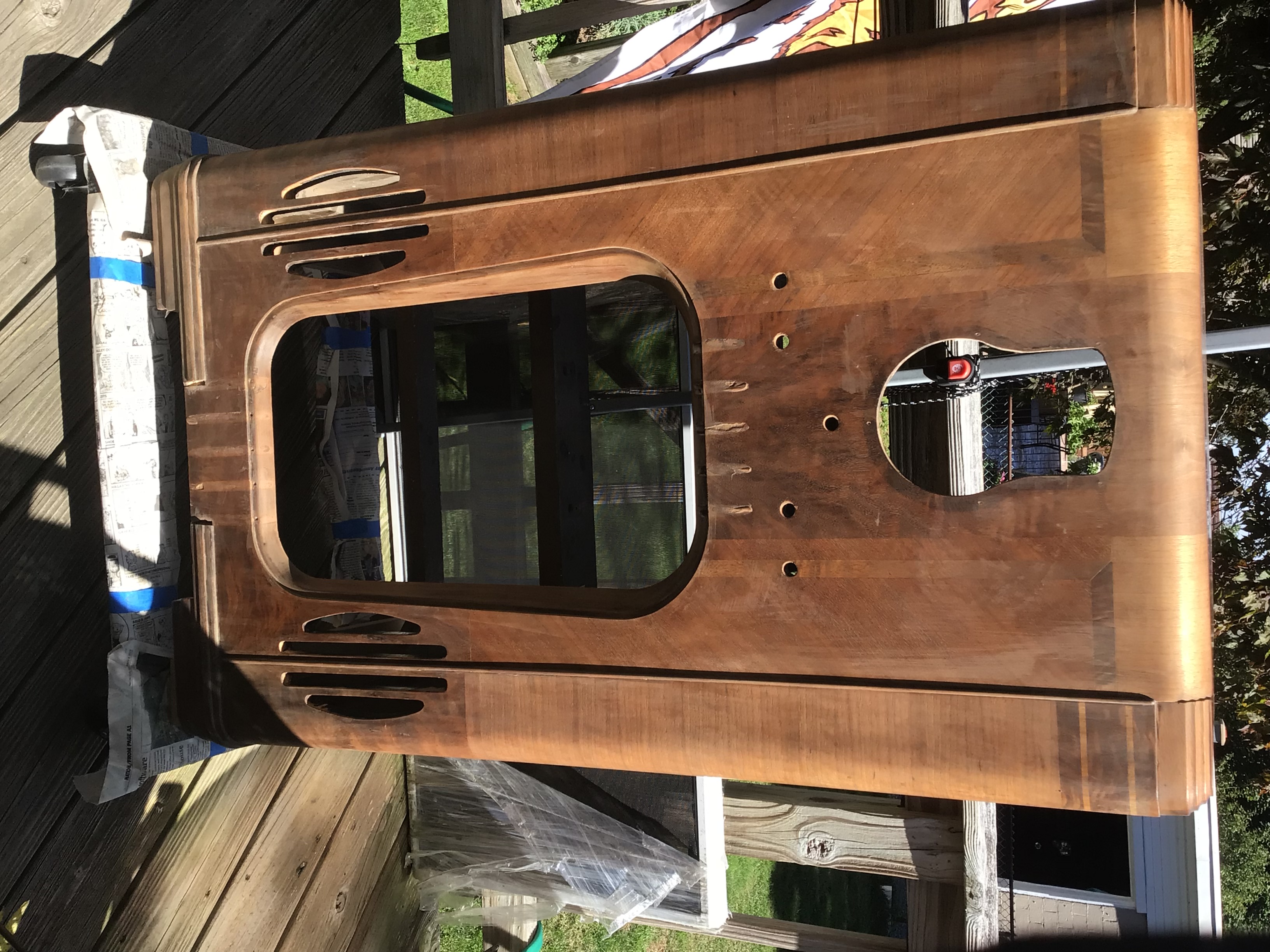

Hi All, well I put this off long enough. I drove 6 hours round trip over 5 years ago for this Philco. I had the chassis done long ago put keep putting off the cabinet refinish because it’s not my favorite thing to do and I have no spray equipment. So I have 2 questions..#1.. anyone know what color toners to use and #2.. is it possible to do a decent job on a big cabinet using rattle cans.
I have it stripped and while using OMS on it, the grain and color really pop on it. So much so that I’m considering just hitting it with sanding sealer and 3 coats of gloss clear lacquer. I did similar on a Majestic I did earlier this year and thought it came out great. I would like to do the base trim and around the top with some color for contrast. Anyone have a guesstimate on how many cans of clear I might need. Thanks for any input..

Would go w/ 2coats of sanding sealer. This will give you some perspective on how it's going to look and what areas need attention before you proceed. Give it a light sand w/400g paper w/a rubber sanding block.
Grain fill w/walnut colored filler. This will make the grain standout. If you grain fill over bare wood/veneer it tends to stain the wood but by using the sealer 1st the grain gets filled but the wood doesn't get stained.
Another coat of sealer. The filler leaves it really dull a quick coat of sealer will let you know how it's coming along. Light sand.
Toning. Overall medium walnut or perfect walnut are good. For the base, top, and spk trim ex dark walnut or van Dyk are good.
Bear in mind over the last 80yrs the toner on this cabinet has faded. I was surprised when I started disassembling my 16B tombstone. Under the dial bezel the panel was almost black vs the rest of it which was a milk chocolate color. I had thought it was the lighter brown but apparently not. It may look a little darker than your use to but it's probably closer to its original color than you think.
For the clear coat I've been told that most Philco set had a high gloss finish. Personally, I'm not a big fan of high gloss. I think on this set it would look good. As for coats well maybe 5 or 6 depending on how much you like buffing.
In terms how many cans I have no clue. I know it gotten awful expensive. When I first started buying it it was $5.50 a can now it's abt $11. I'm tempted to buy in qt's or gal's and use my hvlp sprayer. I not sure what the shelf life is for these sorts of products. Would want to have a bunch of projects lined up and ready to go. Maybe next Spring...

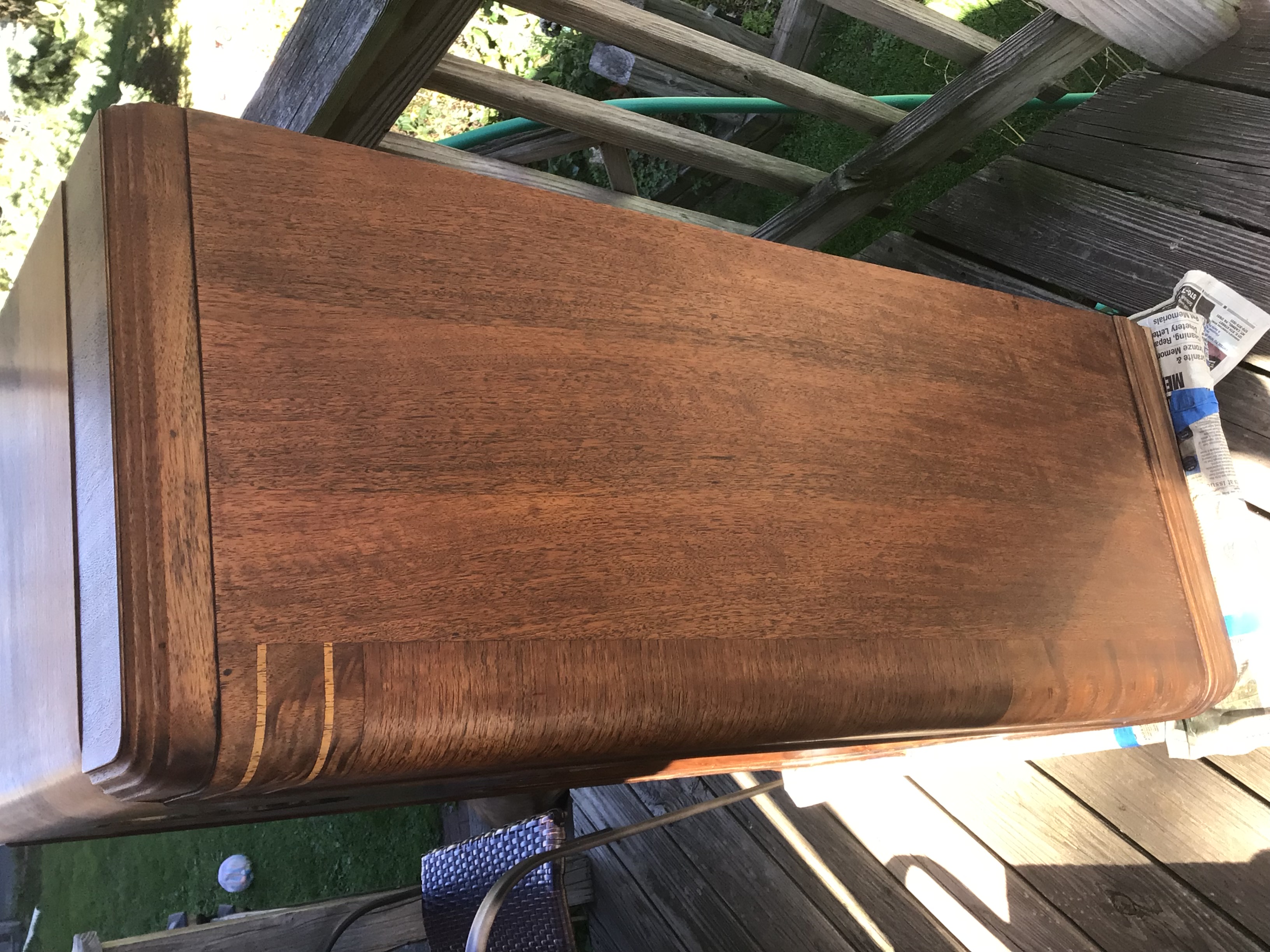

Thanks Terry. I have no spray equipment at all and don’t foresee me getting anymore consoles. When I applied the mineral spirits to wash off the residue it really popped while wet. I think if it turns out like that I will be happy both because I’m afraid if I try to tone it with rattle cans I might mess it up and also because there is still original color in the wood. I’ve done this method on a Majestic earlier this year and was very pleased with the outcome. I did add toner to the trim work only on that radio and then sanding sealer and 3 coats of semi gloss clear lacquer. Before I stripped the Philco, it had a sort of greenish cast to me, kind of like ginger ale. I’m thinking I will order more sanding sealer, grain filler, clear gloss lacquer and the toner you recommended for the base and top trim! Running out of time here, all finishing work has to be done outside on the deck, the Mrs has no tolerance for fumes!

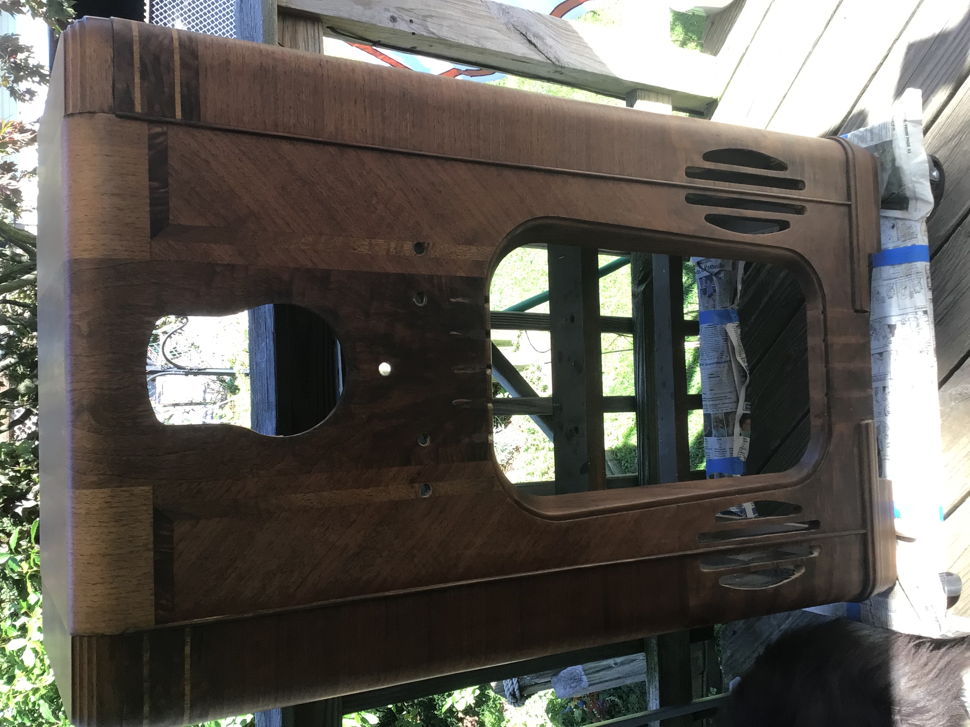

Just a quick update. I received my order from Mohawk and started the refinishing as I already have done the stripping process. I did the sanding sealer first and then the grain filler. Lightly sanded then more sealer. I’m ready to start spraying colored toner but flat ran out of time. This past week the weather was great here but now took a downward turn and since we are heading to November, I pushed the limit. I will probably resume in the Spring unless we get a fluke of decent weather again.BTW, thanks Ron for the suggestion on the spray nozzles, they worked out great. So far using rattle cans isn’t too bad!
