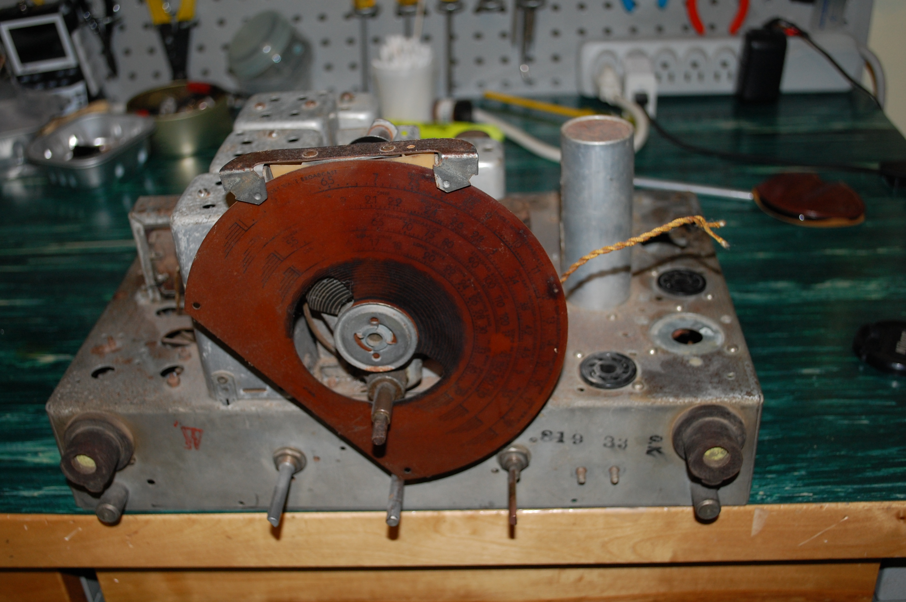

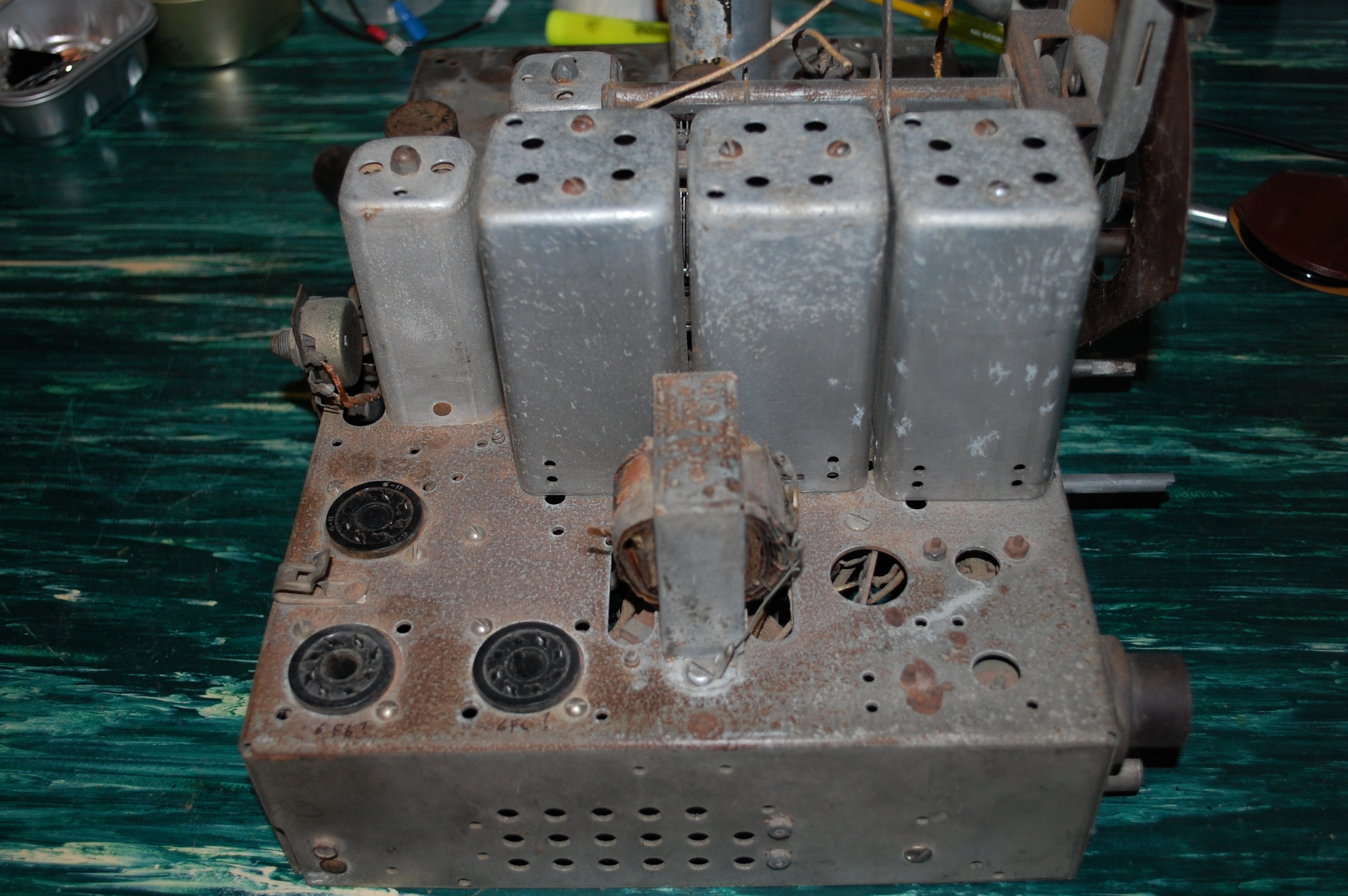

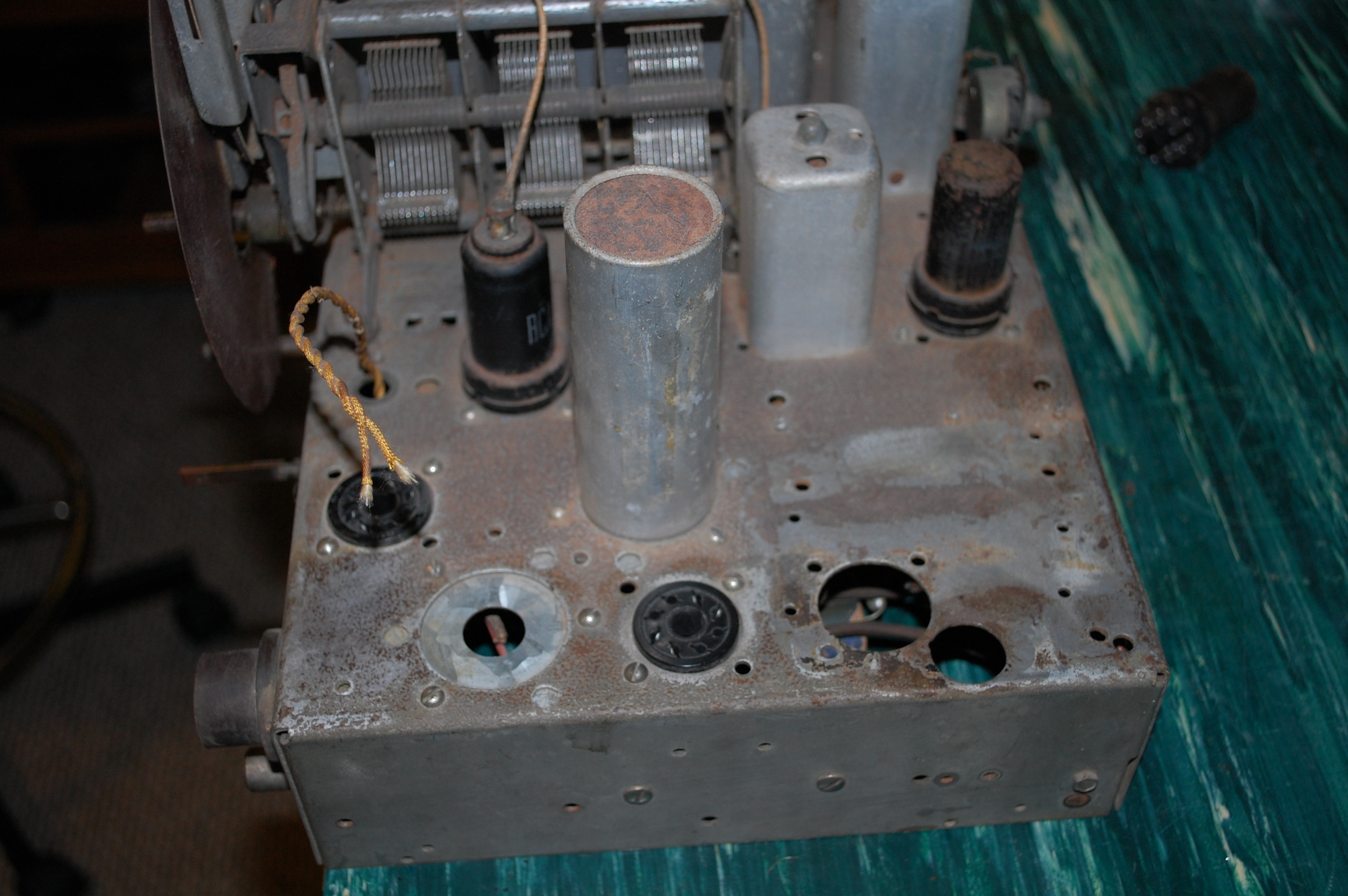

I'll give the picture attachment a try. The wiring on this chassis looks original and factory. The no. 1 pins on all of the tube sockets are grounded
with exception of the rectifier tube which would indicate to me that it was a metal tube set from the beginning. If it was retubed and modified
later, it was a professional job and I would say completely rewired. The output tubes are wired in pushpull and are along the left side of the
chassis. The audio driver transformer is located on the bottom of the chassis. The IF transformers were made by JW Miller, another possible
indication that it was rewired at sometime. It had 8 tubes originally, some were missing. The set included a 5U4 Rectifier, 6K8 Mixer, 6SK7
RF Amp?, 6SG7 IF?, and a 6SR7 det/amp. Looks like the output tubes were 6F6s. Thanks for reading my post.
Some observations:
1. Philco did not use metal tubes originally. Philco was feuding with RCA throughout the 1930s. RCA was a heavy proponent of metal tubes. For this reason, Philco refused to use them, instead having Sylvania (who made their Philco branded tubes for them) make glass octal tubes with ST or "taper-top" glass envelopes.
2. Radio manufacturers did not attach tube sockets with screws; they used rivets.
3. Philco used phenolic wafer sockets when this chassis was built, not the black bakelite Amphenol sockets.
4. The IF transformers are not original.
5. Philco did not use octal tubes in their 1936 radio models.
I find it very odd that what is obviously a 1936 Philco chassis would be inside a 38-643 cabinet, unless (a) the chassis was stuck inside backwards or in a manner that the control shafts did not protrude through the front panel; or (b) the front panel was redrilled to accommodate these control shafts.
Can you post photos of (A) a top view of the chassis), (B) an underside view of the chassis, and © a photo of the cabinet, please?
I think the chassis is a heavily modified model 640. It has four bands on the dial scale, and shows evidence of once having a vertical mounting power transformer. It is probably not worth restoring - in my opinion.
