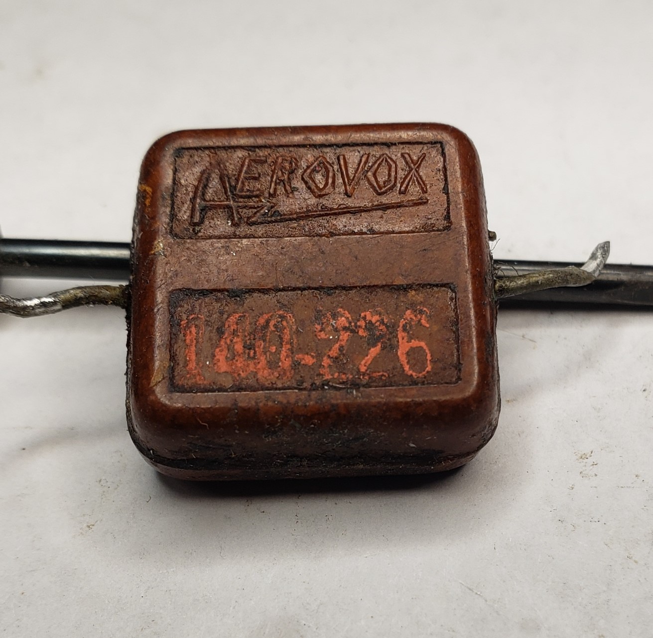

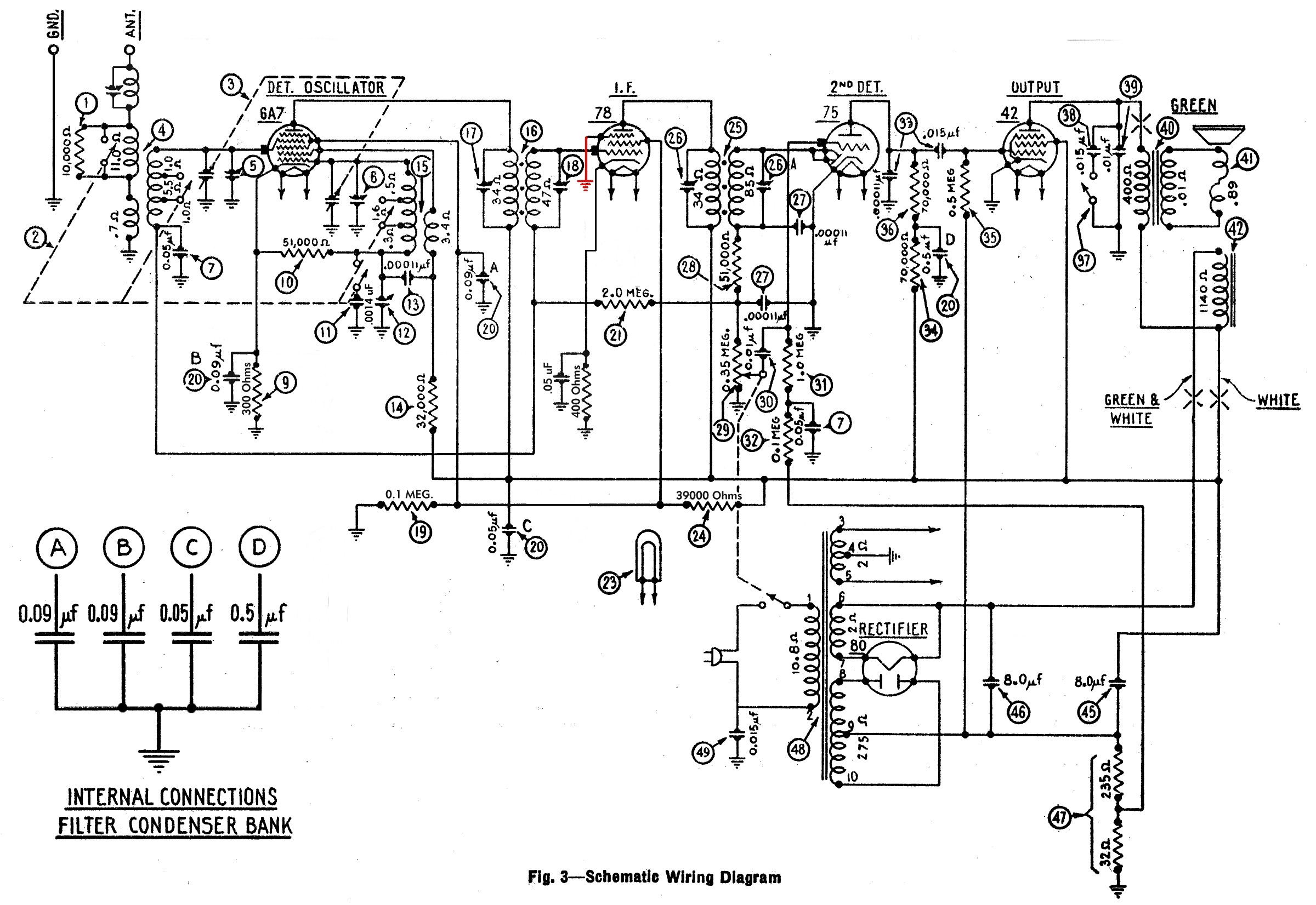

I'm puzzled over an Aerovox Mica Cap on this set and it's correct value. I attached pictures of the device and the schematic. It is Item #13 across the Oscillator Coil windings, shown on the schematic as a 110pf. The value has remained the same over the range of different Run's.

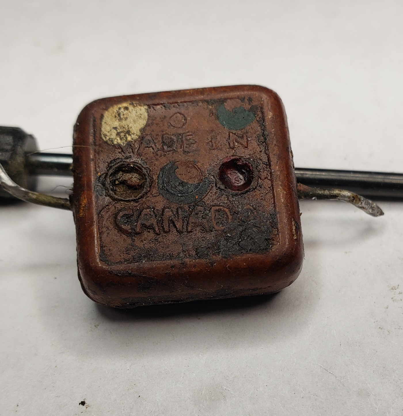

In the picture, the Part Number appears to be 140-226. Colors across the top, L-R are, White & Green. Colors across the middle, L-R are, Unknown, Black & Red.
On my DVM Capacitance it reads as a 0.00112mf, BUT I don't trust that on old leaky caps. My EICO 950 Capacitance Bridge reads approx. 0.0014mf. Both are reasonably close, however, the schematic states 110pf!! Off by a factor of 10.
So, I think I should keep the original one, since it appears to be OK, or replace it with a new 0.001mf. But 110pf seems to be questionable. The original does not appear to be leaky. And I am not proficient enough to decode the color for the stated capacitance. I couldn't find any references to the Aerovox Part number.

I doubt it is the original cap. I am not sure Philco would use Aerovox-marked caps.
I think the correct replacement is a 110pF mica cap.

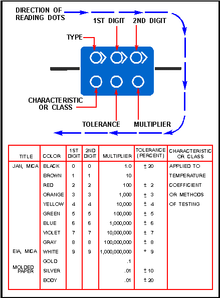

Aerovox would often apply the EIA 6 dot code to 3-dot bodies
Thus the upper left is white for EIA, the 2nd dot has fallen away and should be brown, the third is as seen, green, the forth or multiplier is also brown but could be red, deteriorated, the fifth though important is if black 20%..

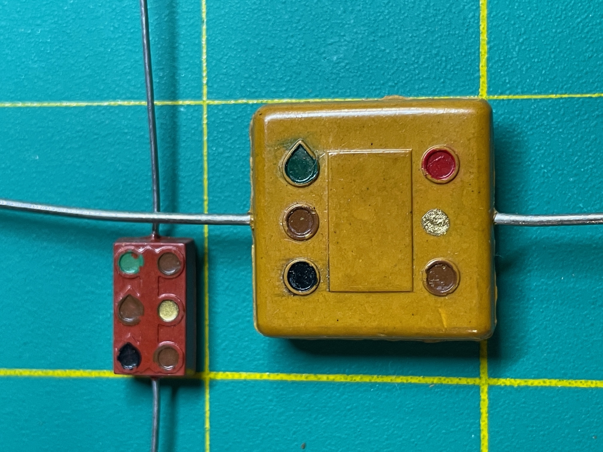

I have been reviewing a 25# box of new 30's era mica caps (yes, thousands of mica caps). Most are very accurate but some appear to be coded as if to fulfill a required quantity. None the less release agents if not removed from the body will cause the paint dots to fall away.
This cap will effect the calibration in the center of the band, so its value needs to be roughly 10% of stated, it should also have a negative co-efficient, generally N330.
FWIW take a look again at setup to read the value on your Eico bridge... The fact that the bridge gives a null, indicates the cap does not have excessive leakage. I have found that accumulated dirt stuck to the body of the molded mica cap contributes to leakage as read by some instruments... Sometimes the multiplication factor on the scale control knob becomes confusing, bad enough that the dots are too...
I keep a couple of known good marked caps that are in the center, more or less of each range, sanity check near my bridges...
Note how much smaller the 150pf is over the 1500pf and the examples were for JAN production... Note too, the black first dot on JAN coding, more often than not, will be a cap that more likely has retained it value.

The schematic calls for part (13) to be .00011 uF, part 4519.
The 1936 Philco parts catalog confirms part 4519 is .00011 uF. (Or, if you prefer, 0.11 nF.)
.00011 uF is equal to 110 pF.
The part should be replaced with a 110 pF capacitor, not an 1100 pF (.0011 uF or 1.1 nF) capacitor.
