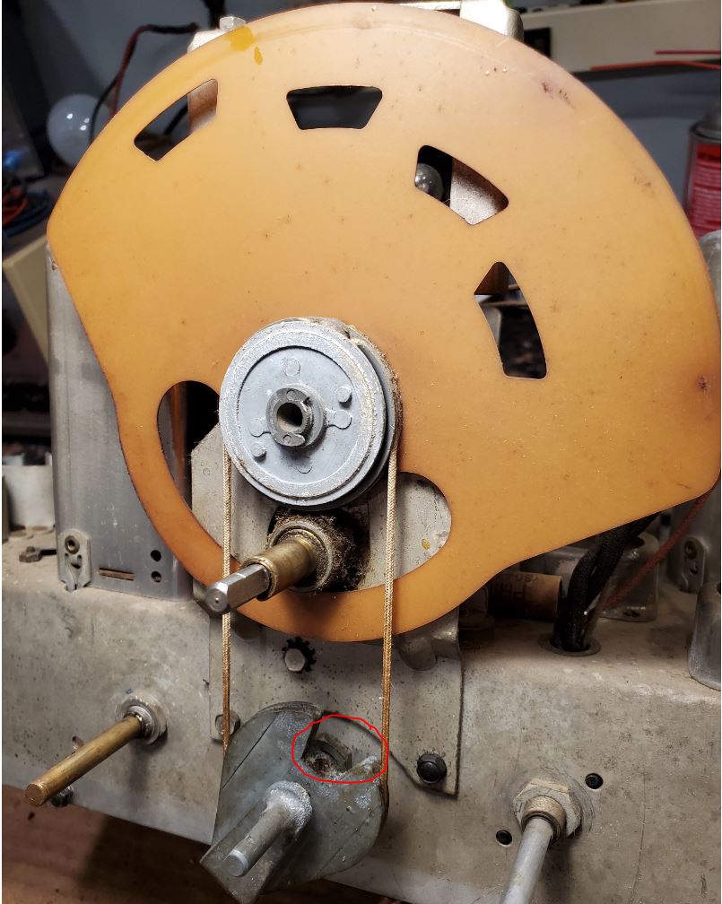

Hello, I need to dismantle the tuning mechanism in my 3650 (Canadian). I have removed the dial screen but can't figure out how to remove the shadow screen. The picture shows how far I have gone. Also the band selector has a set screw (red circle) that seems to be fused in place. Tried Liquid Wrench having no luck.
Thanks,
Dan
Perhaps this will help  Dial Drive Rebuilding – Models 116, 640, 643, 645, 650, 651, 655, 660, 665 – Philco Library (philcoradio.com) Some set screws can be tough to remove. A good fitting screwdriver is a must with straight blade not rounded on the corners. You can try holding a hot soldering tip on the offending screw. I'm pretty sure that the part is mostly pot metal so if you want to use a torch be careful not to melt it.
Thanks Terry. The link was just what I needed. I'll give the hot soldering iron a try.
Dan
Just as I thought I am missing the dial pointer shield. Any idea where I can get one. Did not find one at Radio Daze. Mine would have 4 arrows.
