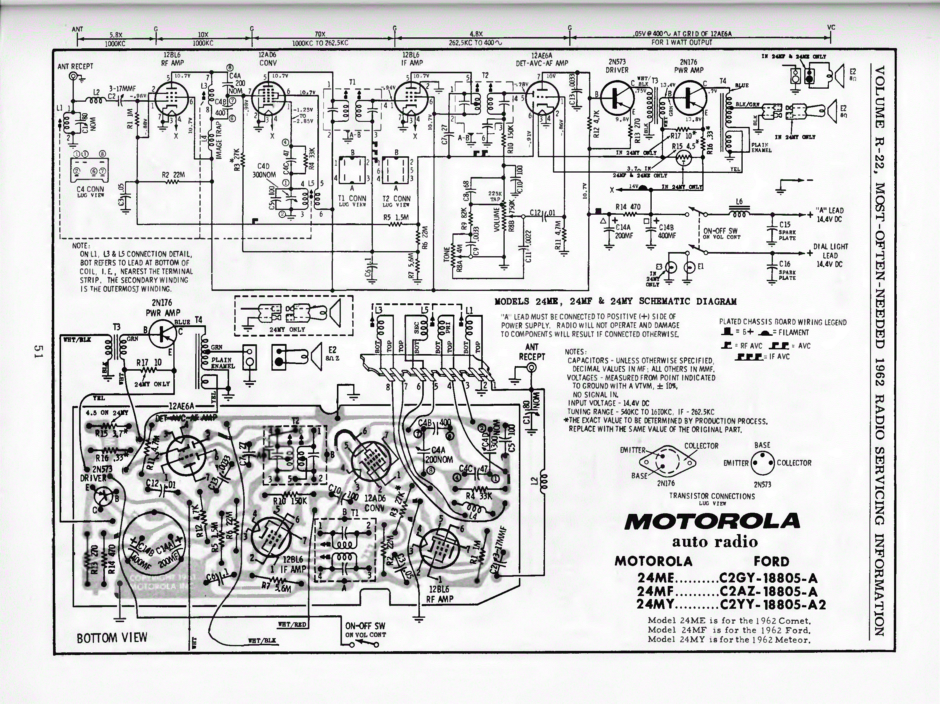

Good Morning! Can't say I've had experience with this one, but the schematic is in Beitmans volume 22.

You always find something interest to service! As Joe mentioned the service info is here on pg 51: https://www.worldradiohistory.com/Archiv...n-1962.pdf I haven't had direct experience with that model, but I have with the 12ME which is the 1960/61 version.

I do have the schematic which I got from Radiomuseum but thanks for the Beitmans reference -often there is more info there than in Radiomuseum. I will look that up.

I would try signal tracing techniques. However, first check out the radio to see if the thermistor shown in the schematic exists in your radio. If so, try bypassing it. I believe that the 2N176 is socketed but you have to carefully desolder the other transistor. Maybe the heater voltage for the detector /1st AF tube is too low, that would cause low sound and distortion. Also, check all resistors in the transistor section of the circuit. You may have to remove the transistors. The 2 Xistors are germanium, I think. You can pull the 1st audio tube and, using a cap, inject a signal from a cd or MP3 player. Don't expect the cleanest sound; germanium transistors were not quite "HiFi". Working the other way, put the tube back in, and use a cap to connect the plate of the 1st AF to the line input of a tube type amp (Phono input on a vintage radio will suffice. Good AM sound should result. If not, start swapping tubes. and checking caps, resistors, etc. These are "space charge" tubes and were only used in the 58 - 62 model years for Ford (and a lot of others). Funny, Lincoln and T-Bird had all Xistor in 1961, Lincoln had FM available in 1962. Rest of Ford and Merc went all Xistor in 63. A 63 Falcon radio would be a bolt in fit for your Comet, if the same as US models of that vintage.

I mentioned , I think , that it does actually go - only with some distortion and the volume is down.Where is the distortion and low volume ? Which side of the volume control? Well, the probe on the Eico Signal Tracer placed on the top of the volume control delivers a big fat distortion free (relatively !) signal to the tracer speaker so I'm picking the problem lies with the transistor audio amp section.There be dragons for me!The power transistor is screwed to a cast metal section of the chassis (it gets remarkably warm -that part of the chassis acting as a heat sink )with two screws with a peculiar top - not Philips ,square or normal or any of the other "tamper proof" screw heads we get nowadays but with a screw I have read about in ads in "Radiocraft" whose chief merit seems to have been speed of assembly. The slot in the head is like a circle with two little opposite facing arcs cut out. No doubt someone will recall the trade name for these screws.
