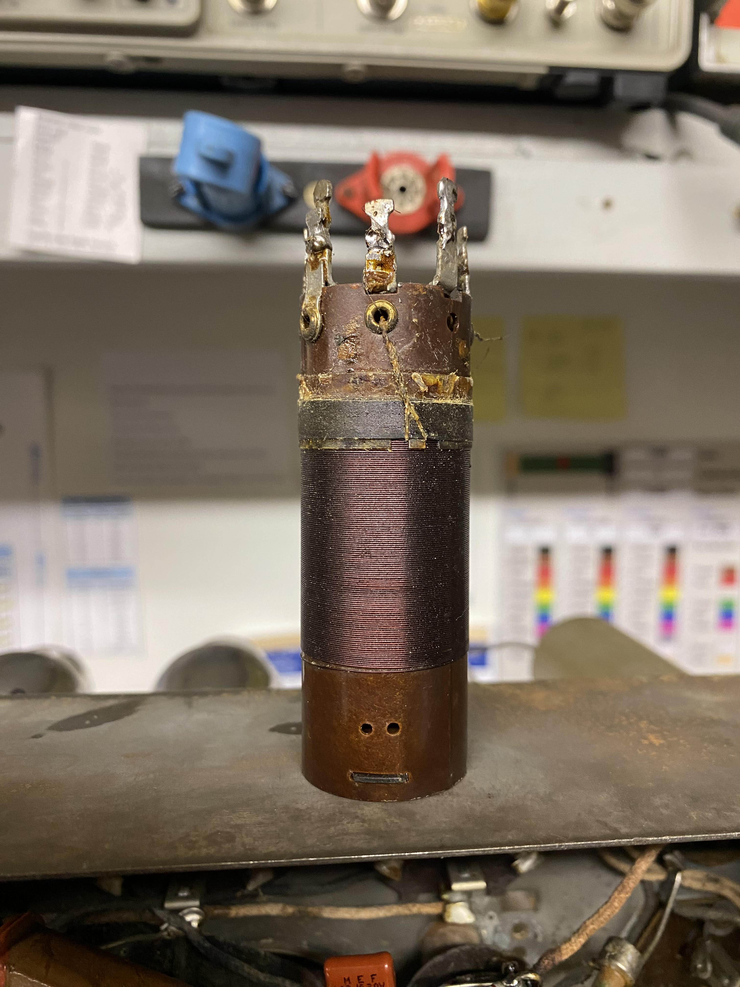

I am currently working on a philco model 71 code 121.
  As expected it has a bad oscillator coil
I replaced the electrolitics and brought it up monitoring the current which was within what was specified.
I put a modulated IF signal through it and all as ok.  Loud tone with volume control so everything is ok prior to a complete recapping.
I have a question as to rewinding the coil.  It’s a small winding.  Not sure where to start.  The coil wire falls apart trying to unwind it.  It is very fine wire wrapped around a cotton thread.  I have replacement wire that is close to the same size but slightly thicker.  I plan to measure the width of the winding and wrap it close to that dimension.  I doubt the frequency of the local oscillator will be correct.  Can I bring the spread in using the existing adjustments for the oscillator adjustment or will I have to start changing parts in the oscillator circuit.  Has anyone else tried this?
Thanks
Tom
Take a closeup picture of the winding and enlarge it so you can count the turns. Wire gauge is going to be 38. It's important that you note the direction that it is wound as the new winding must be wound the same. It does not have anything to do w/the osc frequency but it's the feedback winding. Replace the rotten film strip under it.
GL
Thanks for your input.  I thought the inductance of the winding would figure into the overall frequency but as you stated it does not.
I replaced the plastic, rewound the coil and covered it with bees wax. Its working fine and the band spread is completely correct.
Ready to replace all the caps and check the resistors to settle some of the noise down.  Thanks for your help and advice.  Your suggestion was a great way to count the windings
Thanks again
Tom
