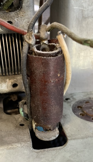

Overall it looks relatively decent. There is rust on the back of the chassis but most of the chassis is rust free. It has the usual crumbling rubber insulation for this vintage and all the tubes test good except the 6A7. All of the transformers ohm out OK except for the secondary on the antenna transformer. The 5 ohm section between lead 3 & 4 is open. I'm not quite sure what I'm going to do about that.

Looks as if no one has been hacking around in there, so that is a help, good luck.
Bob, yeah. The secondary is critical, as it is part of the tuning.
Is it a simple bobbin, easy to rewind, or one of those "cross-wound" wax-dipped jobs?
I’m not sure Mike. I think I’m going to have to take apart to see. It looks like some kind of sleeve over the windings.
Might turn out to be not too bad at all. Looks like a regular one-layer coil. The sleeve..I guess you'll find out when it's off. Could be of some simple mechanical purpose.
When I get back to it I’ll let you know, thanks.
