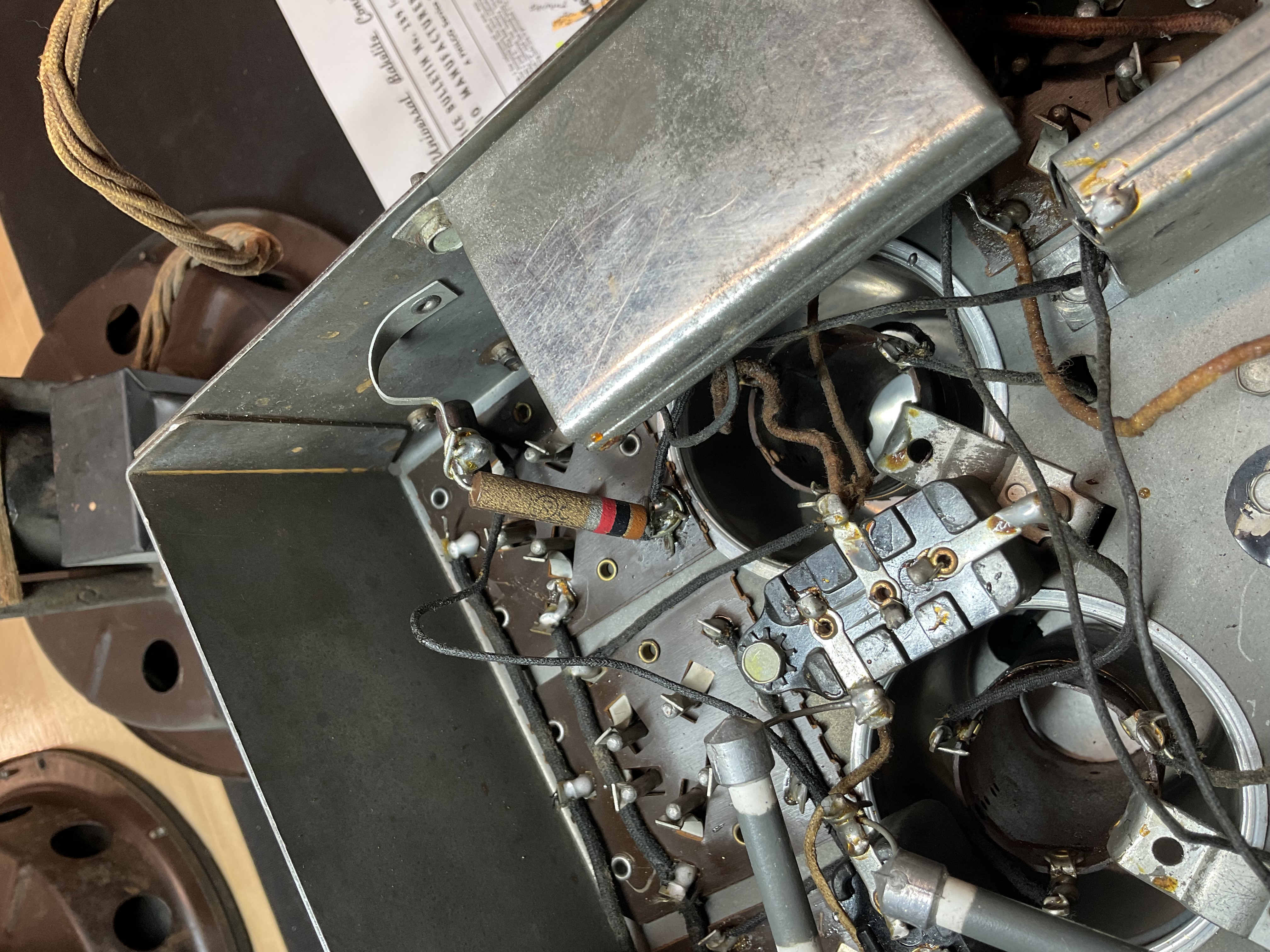

Attached is a pic of the resistor installed. Brown-black-red, assuming 1K?

The resistor in spot 12 is marked as 1K and measures 1.2K. But schematic says 50K. I can easily replace it, just wondered if anyone knows of a reason it would have this value, particularly with the notes in the RTH. Thanks.

As you could see, the resistor there is Orange, and the document will say "12     50,000     Orange"
Good deal, thanks @morzh. I’ll replace it with a 50K. Appreciate all the input.
