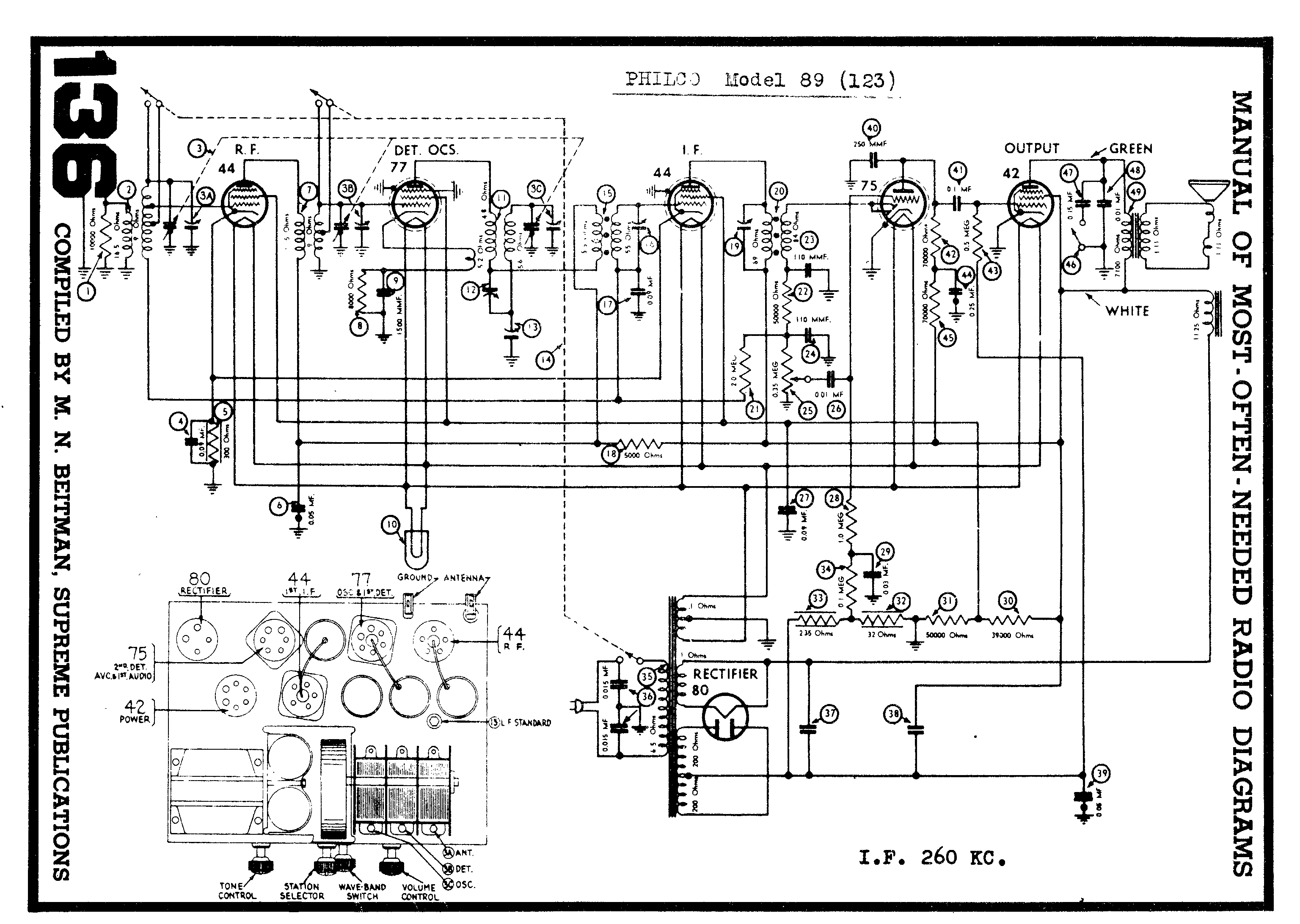

need nelp I have a philco 89 model 123 with the short wave
I have a open interstage transformer (2) coil between rf and oscillator coil and can not seem to locate the spec of the primary side of coil ,
mine is very corroded in one spot and open with almost every turn
does anyone have specs on this coil ie number of turns and wire size ?
kinda new to this hobby I have some magnet wire but prob not correct guage
... please any help you welcome to email me not sure if this is allowed Westerngardener@msn.com or KB7KP@usa.com
thanks Art-
Never worked on a 89 but have some info that might help. Beitmans list ohms for the coils so can guess at length of wire. Link to the Philco library.  https://philcoradio.com/library/  Plus a sch from Beitmans.

If you are talking about the primary of the ant coil #2 I would go w/20' of 38G wire.
https://philcoradio.com/library/download...20146B.pdf
