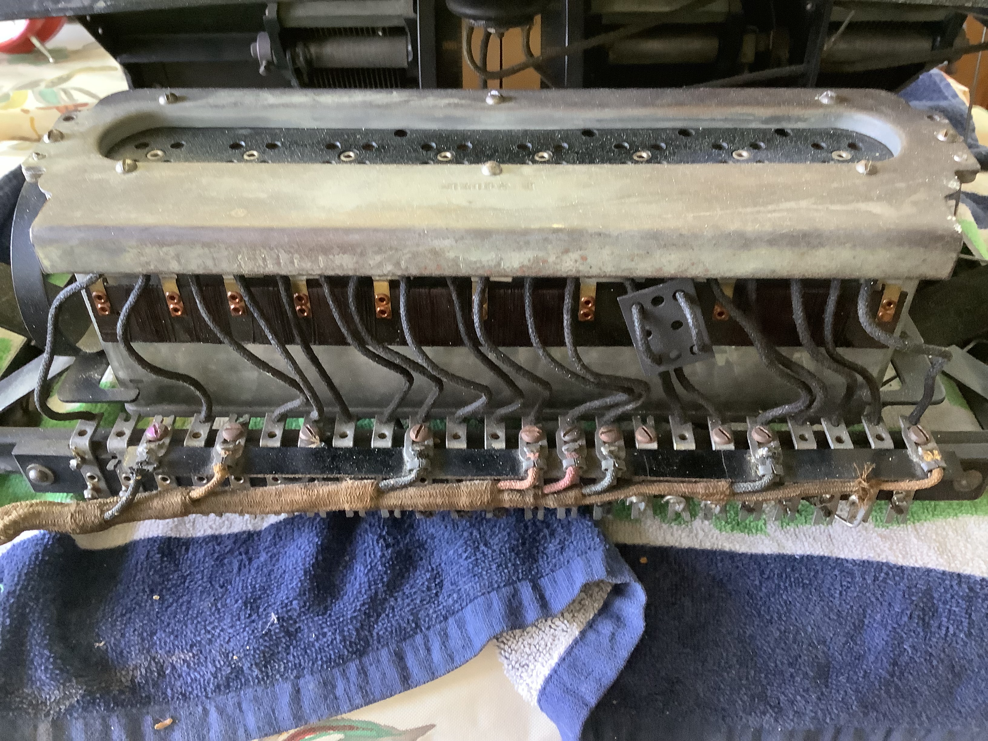

1. There’s no cap bank in the battery box.
2. Is the neutralizing condenser connected to the end variable cap? If so it’s there.
3. The voltmeter connections are intact.
4. A picture of the cat is included (hopefully).
Sorry- I got trigger happy with the photo!

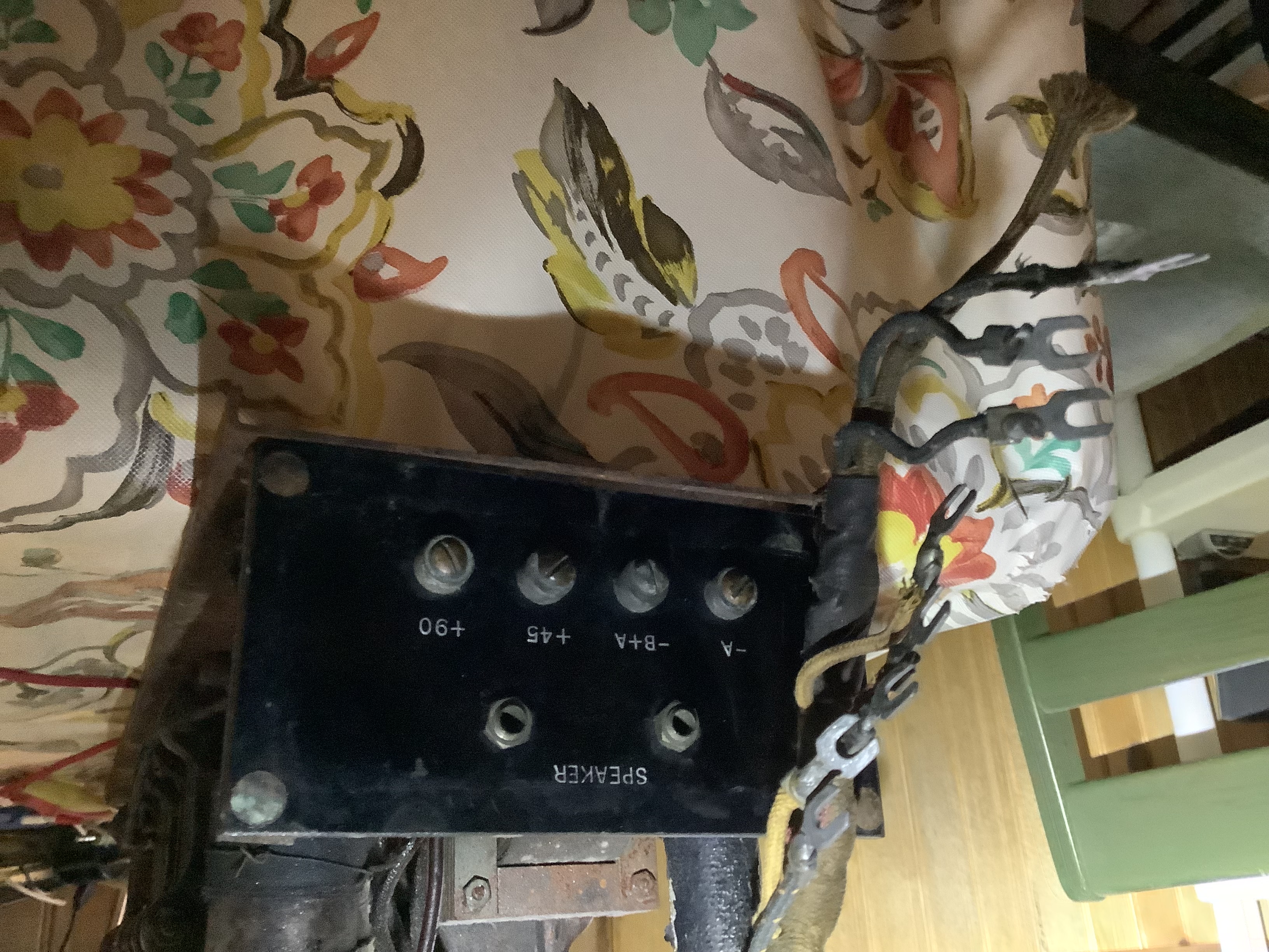

You have a power harness... I cannot be sure it is correct for battery operation. Usually, the harness is backed by a long phenolic strip that holds all the spade lugs in the correct places.
Do not remove the harness, there is information there. Compare the harness with any of the schematics to find out what the terminals are.  Look up and under the edge of the cat there should be numbers molded into the composite socket array next to each wire (whisker). There are no markings on the long terminal strip but between the harness, and whiskers it should be possible to find your way around. Refer to the socket numbers and pins.
Then, do the continuity test using a VOM 1000/ohms/volt is best. A DVM will not show correct continuity reads especially when working around the transformers.
No need to record actual reading in ohms, it is irrelevant it either has continuity or not. Record any error to a list. Expect good audio transformer windings to be no more than 10k often lower.
You have the resistor strip. I will have to see if I have plain jumper strip that I can spare.
It may be possible to make one from perf board, wire and terminal pins. Or, with the correct data, strip off the windings and solder jumper wires. Hate to spoil a good resistor strip though.
Look at page 12 of the PDF this is the correct drawing for the DC battery version. Note the darker wires across the center, that is the jumper connections...
As you become familiar do not remove any connections unless they are confirmed with the schematic. It is VERY EASY to get lost in the 28.
Do confirm that the harness can be used. I suspect that there may be different connections for the "A" supply and possibly bias because of the resistor strip series filaments. Some temp relabeling of the wires with masking tape flags may help.

Have you confirmed the loop?
The top of the cat is cadmium plated and often has green cad. oxide. This can be removed chemically with sodium bi-sulfate, pool acid, then lightly buff. Seal with a wash of white shellac and it will retard turning green again. Solution is 2 oz dry measure to 1qt warm water. Acid works when there is no oil or greasy grime so dish wash soap first then acid dip, only 5 minutes, all in plastic tub, use plastic tools. Rinse with water. excess acid can go in pool or down drain... Store any acid solution in a plastic bottle...
If the acid is used to clean other parts, do not place parts made with mixed metals, the acid will electroplate metals but poorly and blacken them.
The large round RCA 100 cone will sound good, but this radio often had the UZ-1325 hard rubber horn.

1. Yes, the correct 3 contact loop ant is present but it needs new wire.
2. I have a nice 100 speaker to go with the radio.
3. A quick check shows continuity through all tube sockets.
4. I have a Jefferson Tube Charger that I’ve used with’01A tubes.
5. The Radio Receptor 28 that came with the set seems an odd choice for the radio, no high voltage, no C battery hookup, mismatched battery harness.
6. The more I study things the clearer the picture is. Thanks for your help!
Quote:1. Yes, the correct 3 contact loop ant is present but it needs new wire.
1. You can get a very close replica of the Radiola loop antenna wire from Micheal Conrad here:
https://www.ebay.com/itm/333181108573
He & I collaborated many years ago I having braiders at the time, he also as well as having correct textiles.
Make the replacement wire as near exact to the existing length on the loop frame.
2. Be sure the internal coupler inside the 100 can pass the plate current for the 120 tube.
3. O.K. on filament connections but go through the complete list. Remember take the readings but the resistor strip is part of those readings, so a winding external can be open. The strip is going away be sure any no-go is internal to the cat.
4. Be sure the Jefferson tube rejuvenator can do UX-99's, FWIR it can do UV-99's but a V to UX adapter in the socket will allow U-99's. Do not plug a X-99 into the 201a socket, the higher voltages will blow the 99... That is possible to do with an adapter too.
5. The Radio Receptor would have been used with a "C" battery, there is no current taken from a "C" battery in "most" 20's radios, it will last for years. No high voltage meaning no 135 volts for the 120 tube. Well, use a 99 in the last audio and the 90 volts w/4-1/2 volts "C" works.
None the less any restoration of the RR supply will be a challenge too. The ARBE-III does it all.
