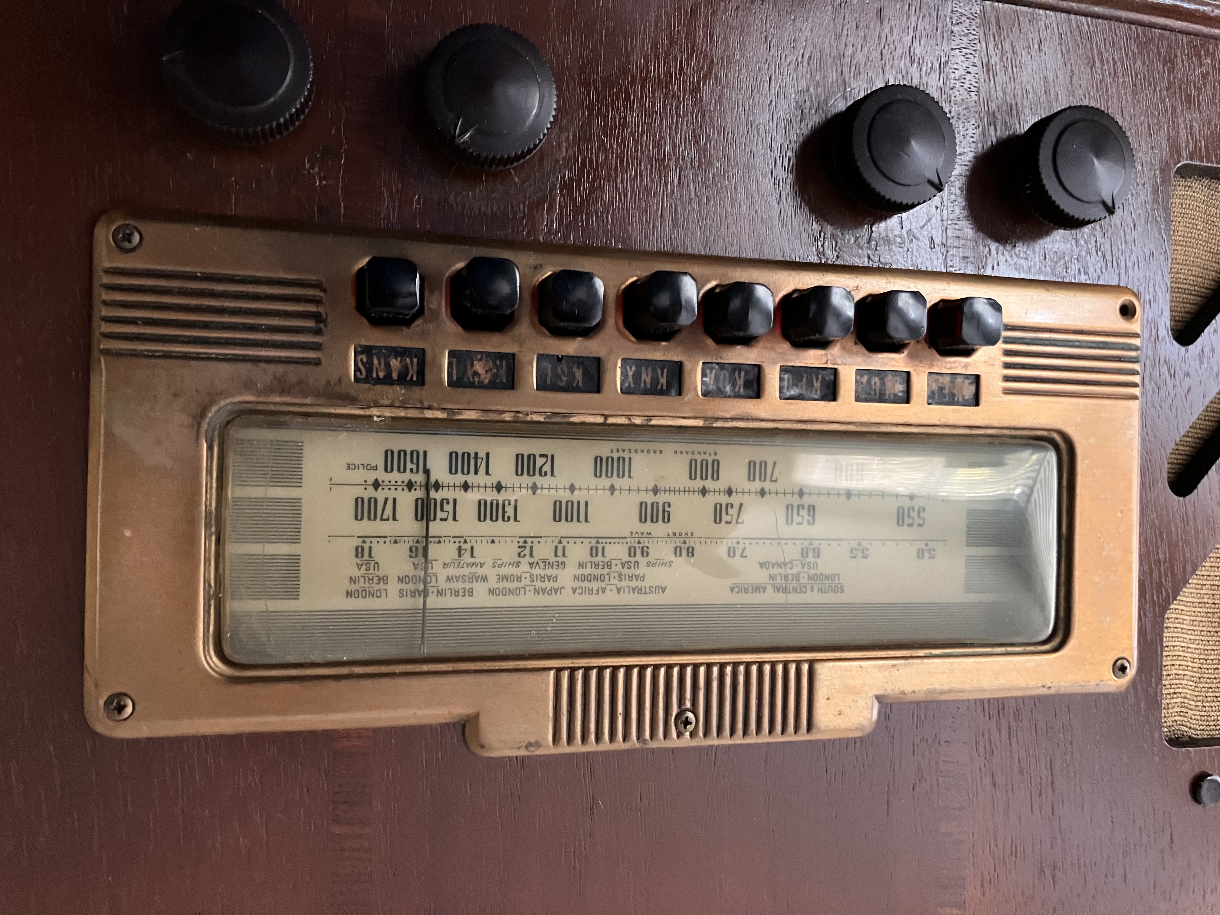

How to clean the metal bezel on a 39-25.  Bezel is just dull, what process is used for restoring to the original brilliance. How are the station call letters removed for cleaning, where can i get new call letter tabs?

Here's what I did:
https://philcoradio.com/phorum/showthread.php?tid=10018
...and here's where I learned it from:
https://www.youtube.com/watch?v=UeeViHNR...84&index=8
I suspect that it's plated steel and if you try to polish it you'll remove the plating. Damp cloth mild soap and dry. I didn't see anything for your particular set but I did see this https://philcoradio.com/library/index.ph...etter-kit/
Those escutcheons are brass I think, but try putting a magnet on it to make sure.
I suspect, ultrasonic bath with the aforementioned mild detergent or even acetone (if it is not paint) will do it good.
One way to replace the tabs is to print them on a P-touch printer with white-on-black tape. You may need to control it from a computer to get the font and size to be a good match to the original.

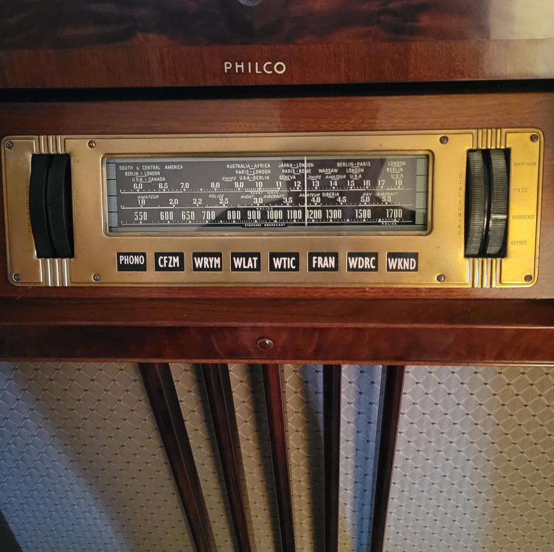

Hello guys,
I like Dale's idea I have both the label maker made by Dymo and Brother !
Anyway did you check to see if the was brass plating or not ?
Check out:
https://philcoradio.com/library/index.ph...on-labels/
These were originally for the 39-116, but I believe that the size of the tab, and lettering should be the same as yours. I photoshopped some for my 39 - 116 and printed them on presentation paper (thicker than regular copy paper) and they turned out great.
