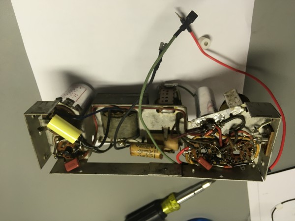

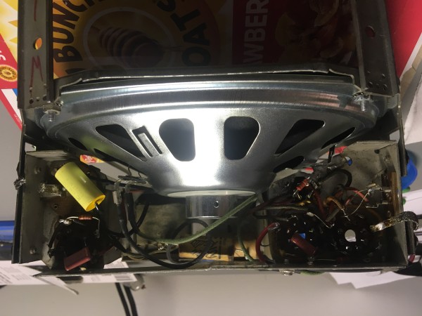

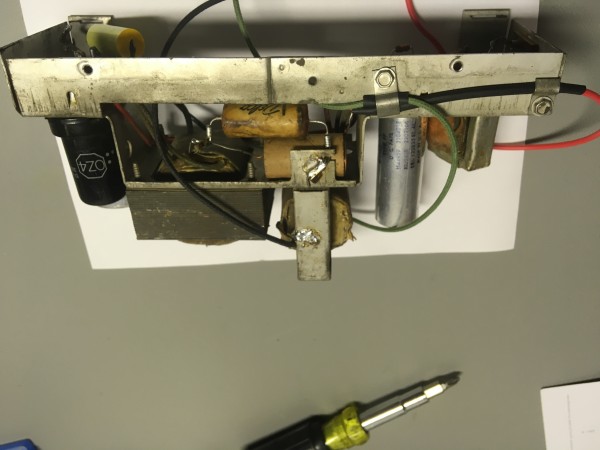

Here is a couple  photos of the complete amp/powersupply

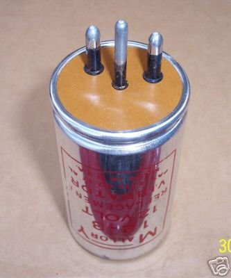

Here is the photo of the Vibrator  style I used and there is the metal spring clamp that is mounted to the socket that holds it and grounds the casing but one thing is I have not tried putting all the covers on yet .
this car radio has not been installed back into the car yet Also with the mechanical vibrator I don't know if it made that noise I can try it since I still have the almost new one that came with this radio it was bought on ebay !

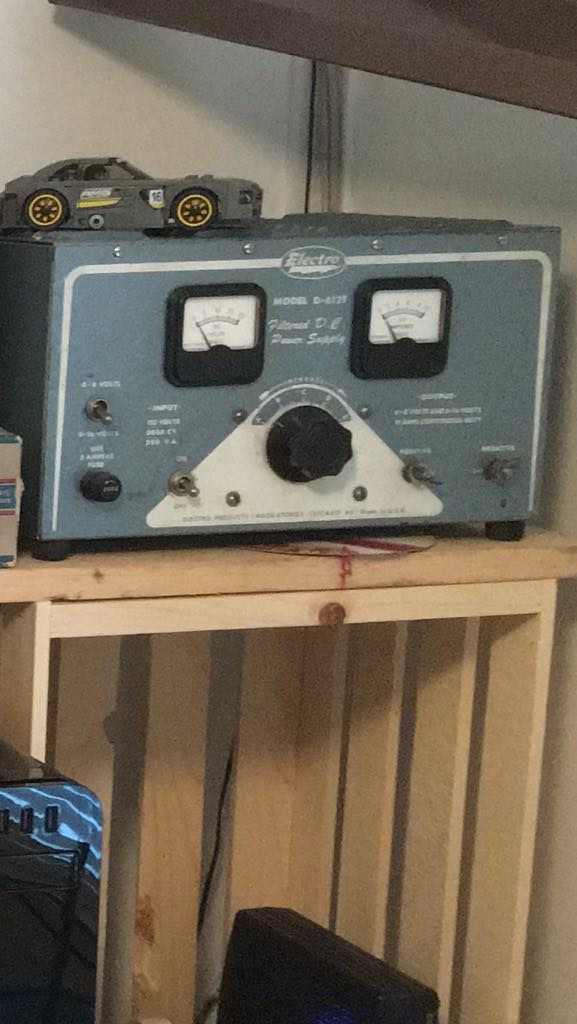

Don't laugh but here is a photo of my powersupply
Hi Rich,
Yeah, read the specs after I posted. Does it come in that can or did you package it. If the latter, Great Job!!!

No it did not come mounted in the can just that little circuit board and that Photo is of the original mallory one .
I will post a photo of the one I did yes there are "Are there fingers that grab the can?"
that is what I was talking about !
