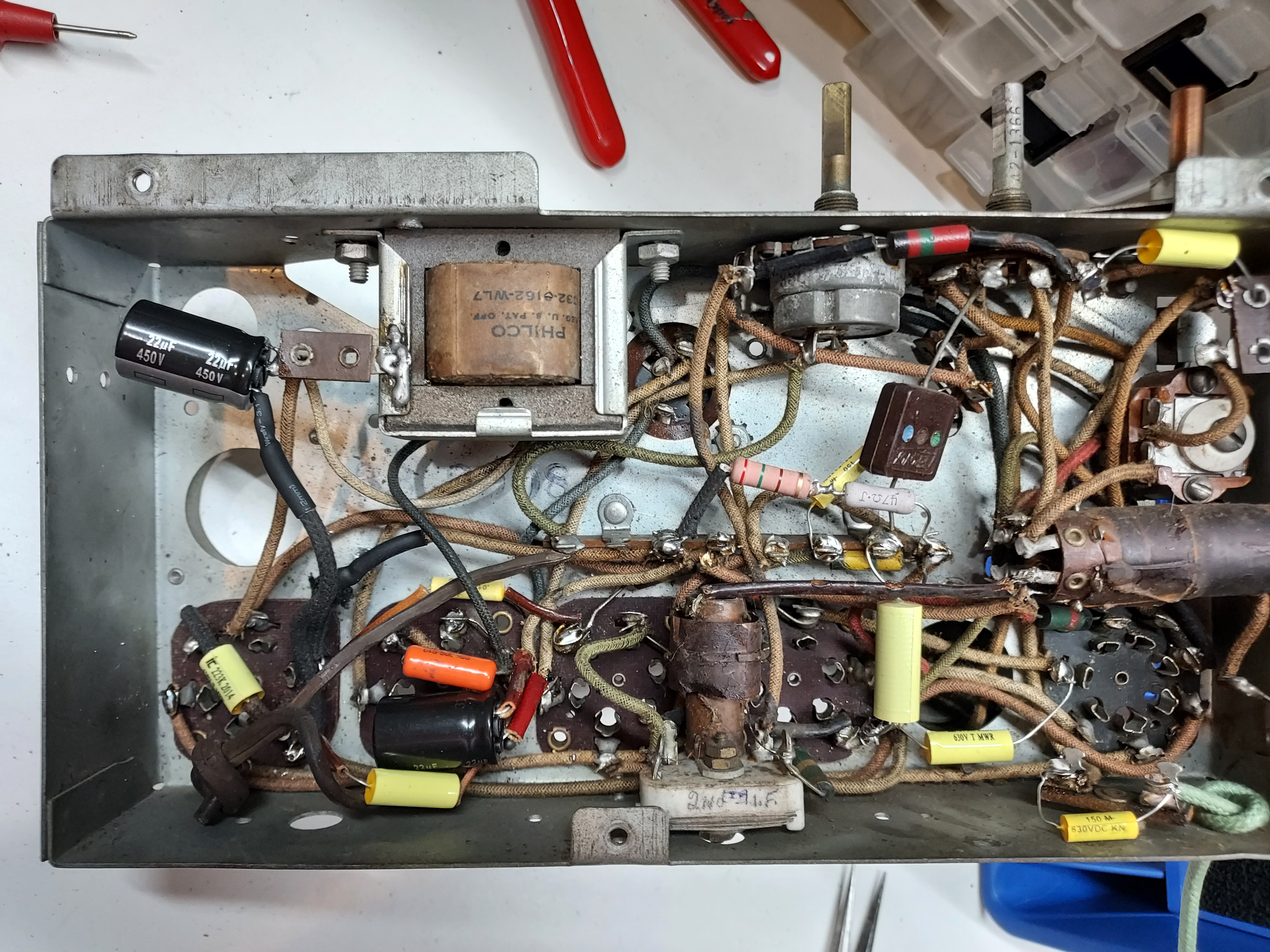

I have finished the recap. THis is how it looks now.

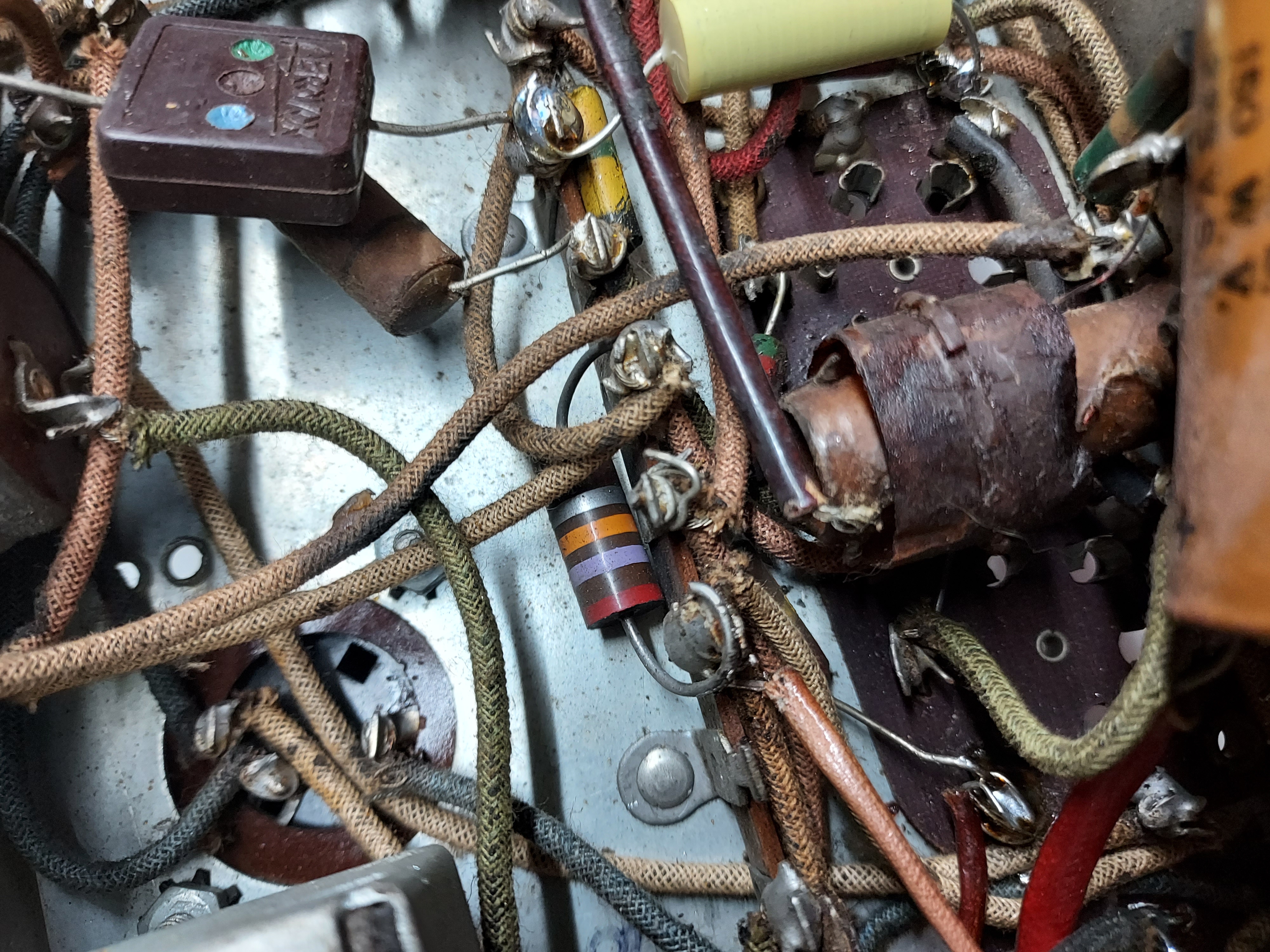

Also, a funny find: the 300 Ohm resistor happened to be a 27K one, measuring at 30K. Considering there is no obvious change in wiring, I wonder how it ever worked after that repair. The resistor is visible here. It is #31 in the sch below.

I also found in the service bulletin, that in order to reduce hum modulation the 16uF cap across the rectifier tube's output is increased to 40uF. Will do that too.
What has made things better is an X-cap before the switch with bleeding 2M resistor. I chose it to be before the switch to save the switch from sparking.
But there is still some whining between stations, and the receprion is not as good, though I got a few stations.
