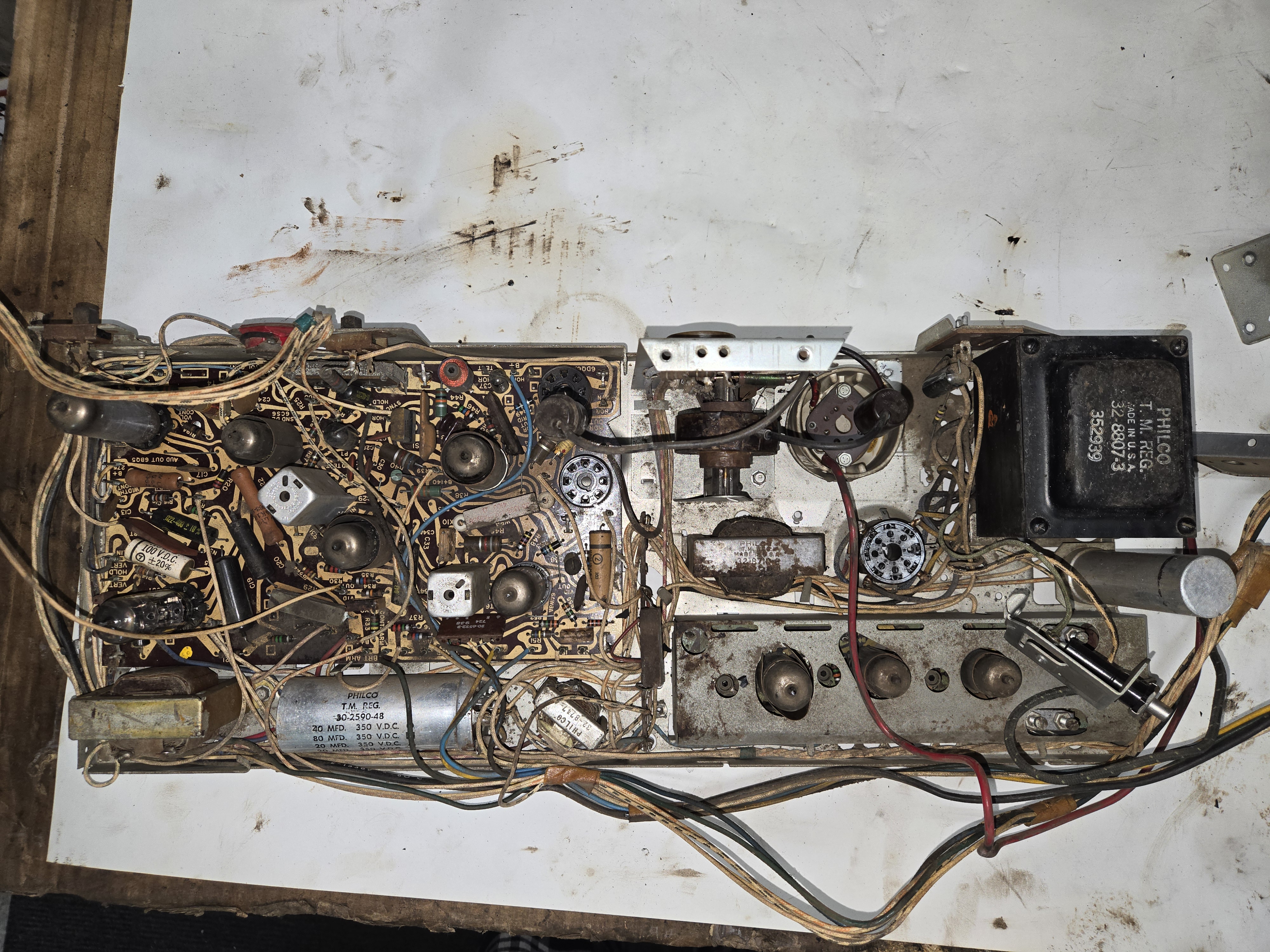

Hi everyone. First time posting here, and I'm back in the hobby for the first time since 1988! Here are two sets I'll be working on over the winter, a 1957 Golden D swivel model and a 1960 Bristol blond finish set. I'll post progress as it happens.

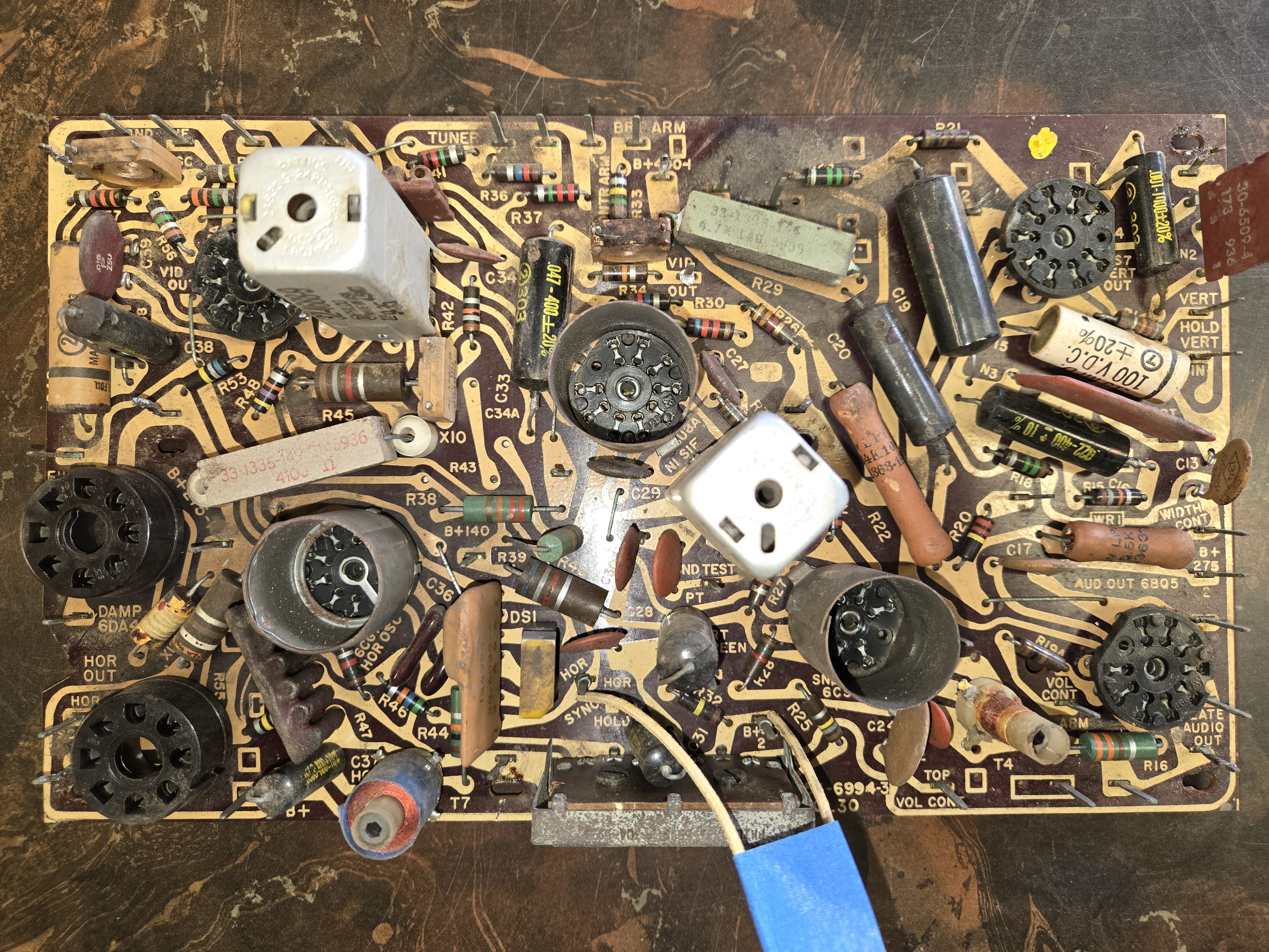

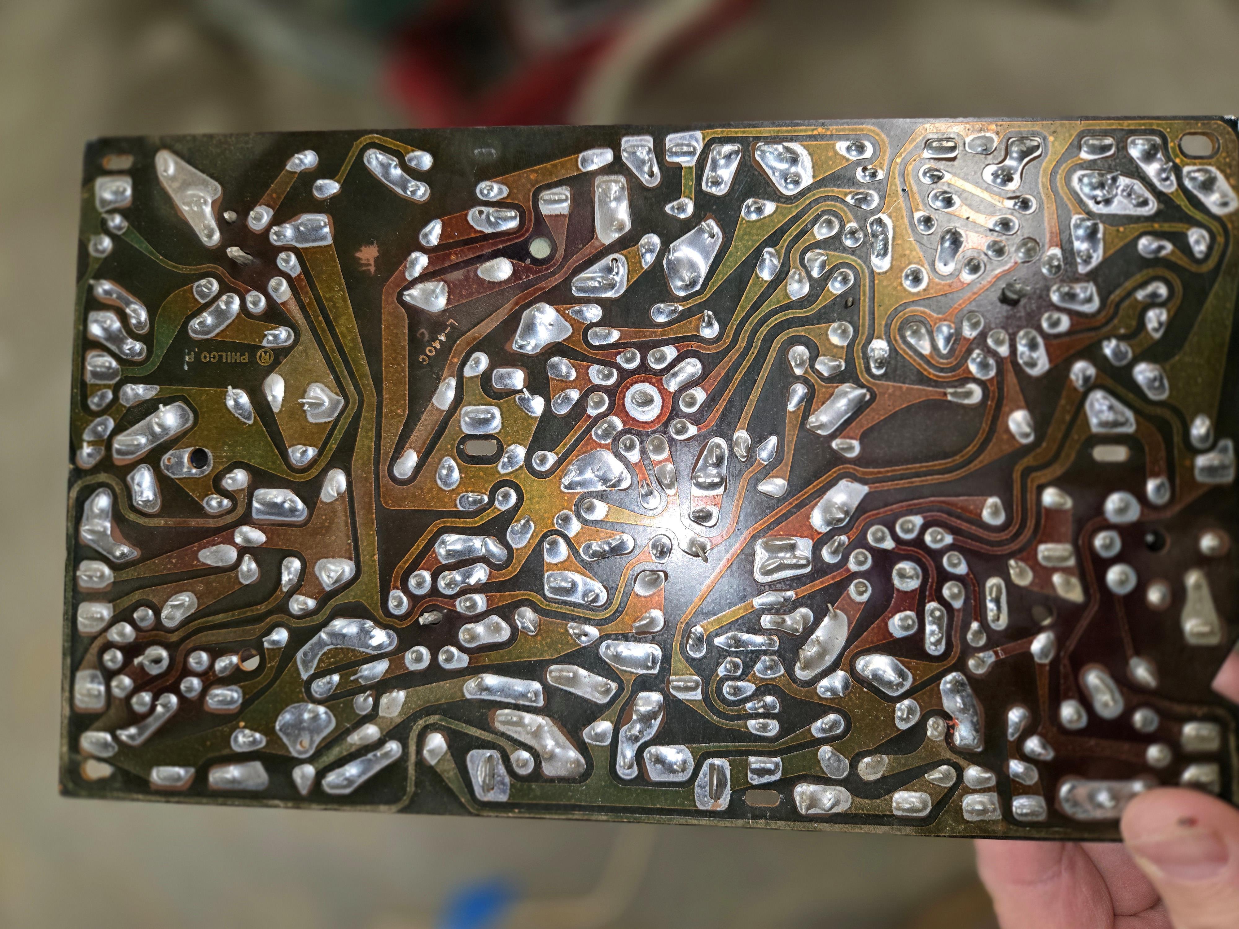

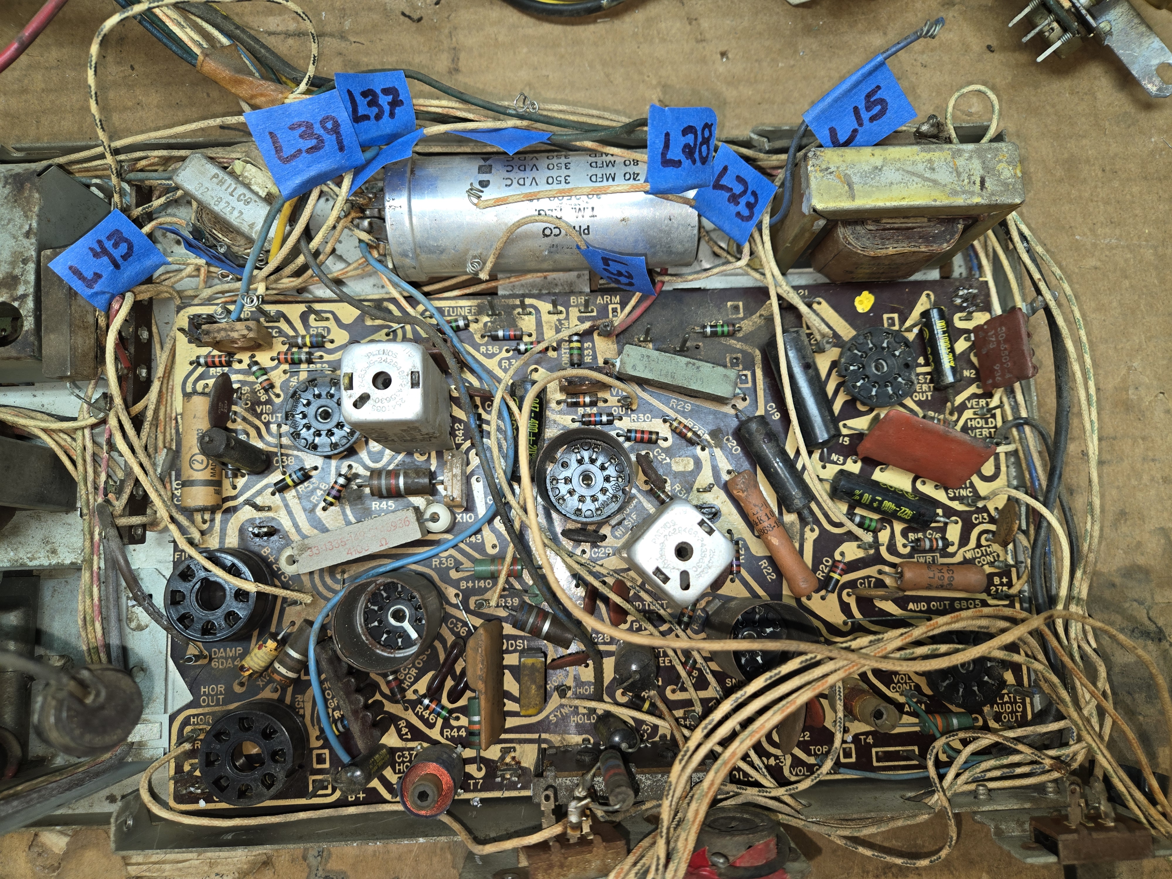

I finally have a chance to dive into the chassis on the Bristols 10L31 chassis. Ended up removing the coating from the flyback so I can re coat, it basically fell off when touched. The more I examine the board, I don't think this was a high hour set. Parts from TV Restorer Guy Crist and Mouser are here so I pulled the board a couple days back. I still need to clean it, but will wait until I remove the couplates and capacitors. I plan on replacing most resistors as well while it's out. Stay Tuned

Lots of progress now on the chassis. All capacitors and all but one resistor replaced... forgot to order one. Also two of the four wire wound replaced as they were cement/sand type and didn't test correctly. Just need to install the last resistor and clean the rosin off the PC board. Also found during all this were two resistors of a different value than called out in Sam's or Riders. There were also a resistor and capacitor missing completely but shown on both schematics.  I've restored it as it was built as it obviously worked. No notes of this were found in the run changes listed. Thanks to TV Restorer Guy for the reproduction couplate!
