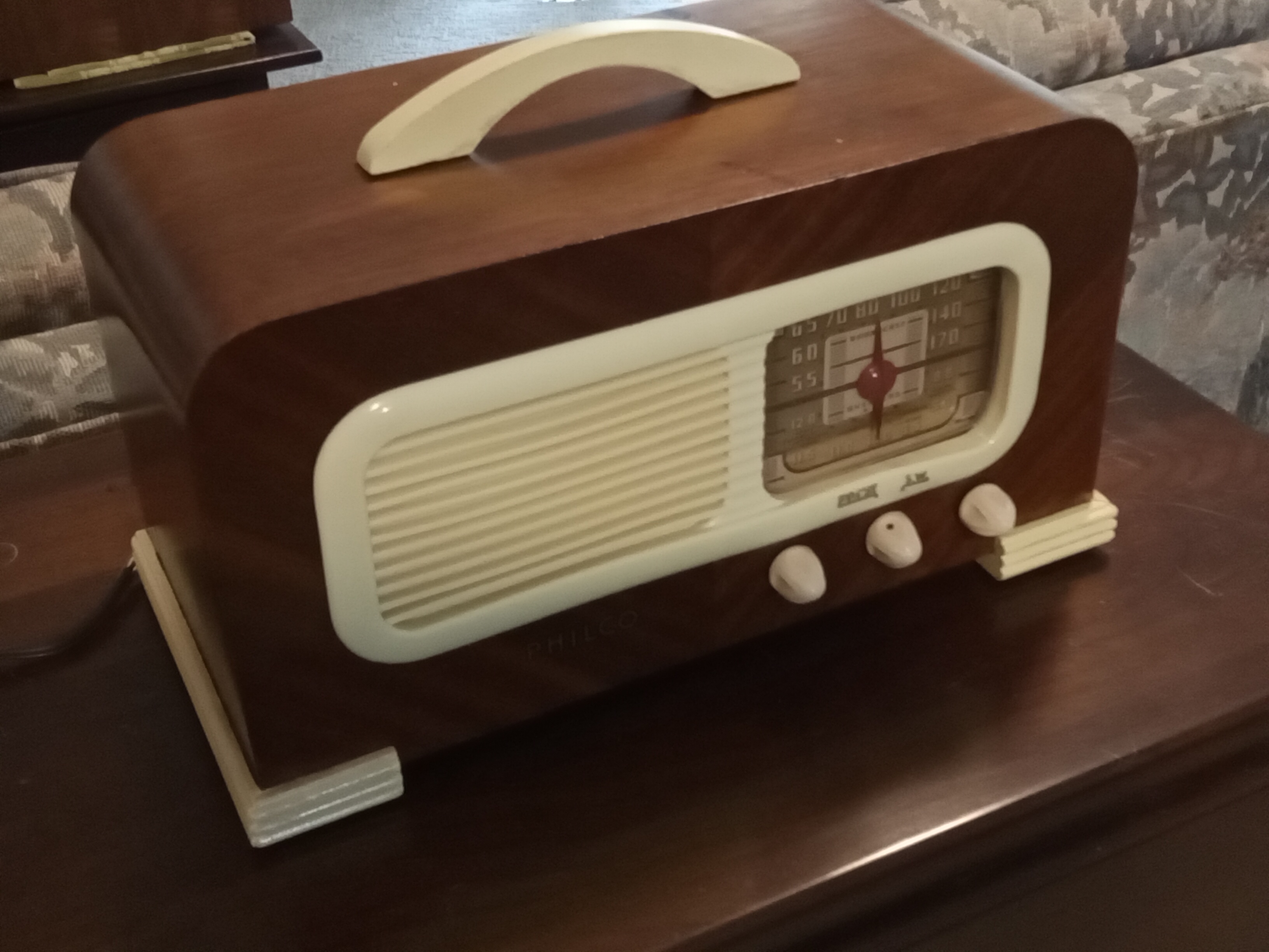

Philco 41-221 Restored
Today my grandson and I finished the restoration of this Philco 41-221. It has had all the rubber coated wiring replaced, alignment, new plastic dial cover and new power cord. I decided to keep the original finish because it was in great condition despite a couple scars on the top from a forgotten cigarette. Gives it character. After cleaning and a couple coats of lacquer it has new glory. It is really sensitive, brings in continuous daytime stations across the dial.

I always tell people that my scars give me character.  Icon_wink   Great job on the radio.  Is the grille original or a replacement?  I repaired a chassis for a 42PT94 for a friend.  His tenite grille was a total mess.  I had a 48-206.  He took my grille (different plastic that did not distort the way that tenite did) and made a mold which he used to mold a new grille for his, including the "marbling" of the original, and returned mine undamaged.  It was his dad's radio and having it back to original condition meant a lot to him.

Thanks for the compliment Richard. The tenite grille is original. A few of the horizontal slats were slightly warped so I slid corrugated cardboard between them then used the heat gun gently getting them straight again. My grandson is 23 and repairs and restores audio and radio equipment in the lower level of my townhouse. He comes in 3 afternoons a week. On this one he did the electronics and I did the cabinet. I think the capacitors were replaced with the poly red ones from Mouser.

Great job, looks good, no need to refinish to my taste.
It is rare that you see the tenite grill in these in decent shape. Most what I've seen is a total mess.
