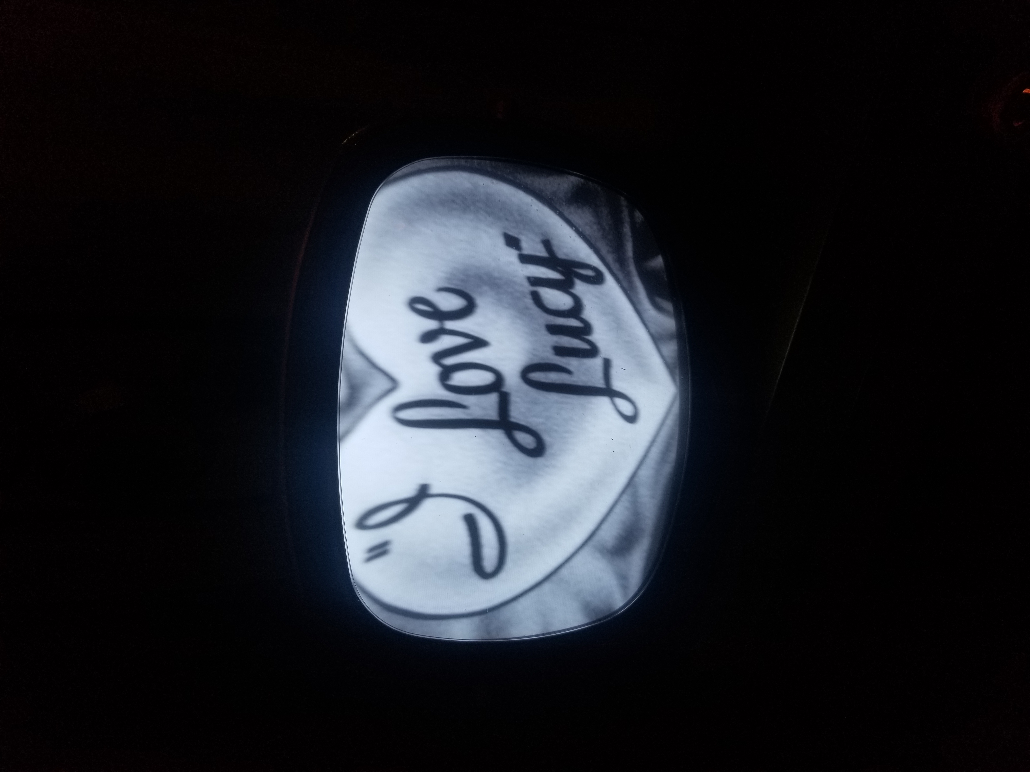

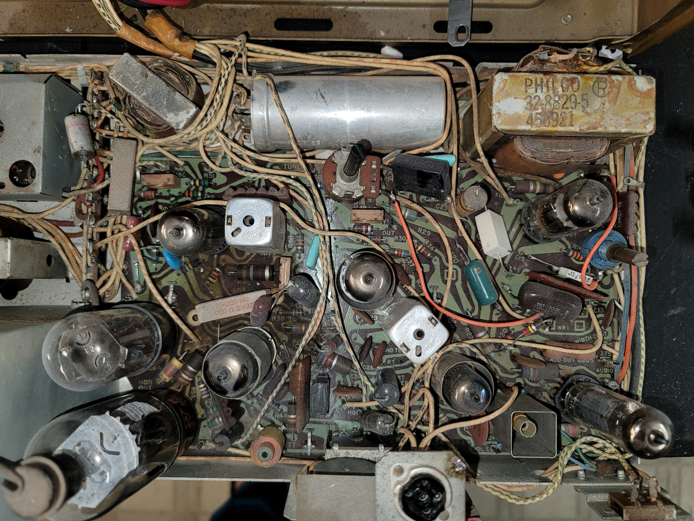

Hey I'm not sure what to look for but my Predicta's picture has been getting dimmer and fuzzy. What should I look for and what tests should I do? Ill include a photo

There could be several issues going on here. If you darken the room and turn down the brightness, does the focus get better? When you crank up the brightness, does the picture get a litter bigger as it gets fuzzy (blooming)?

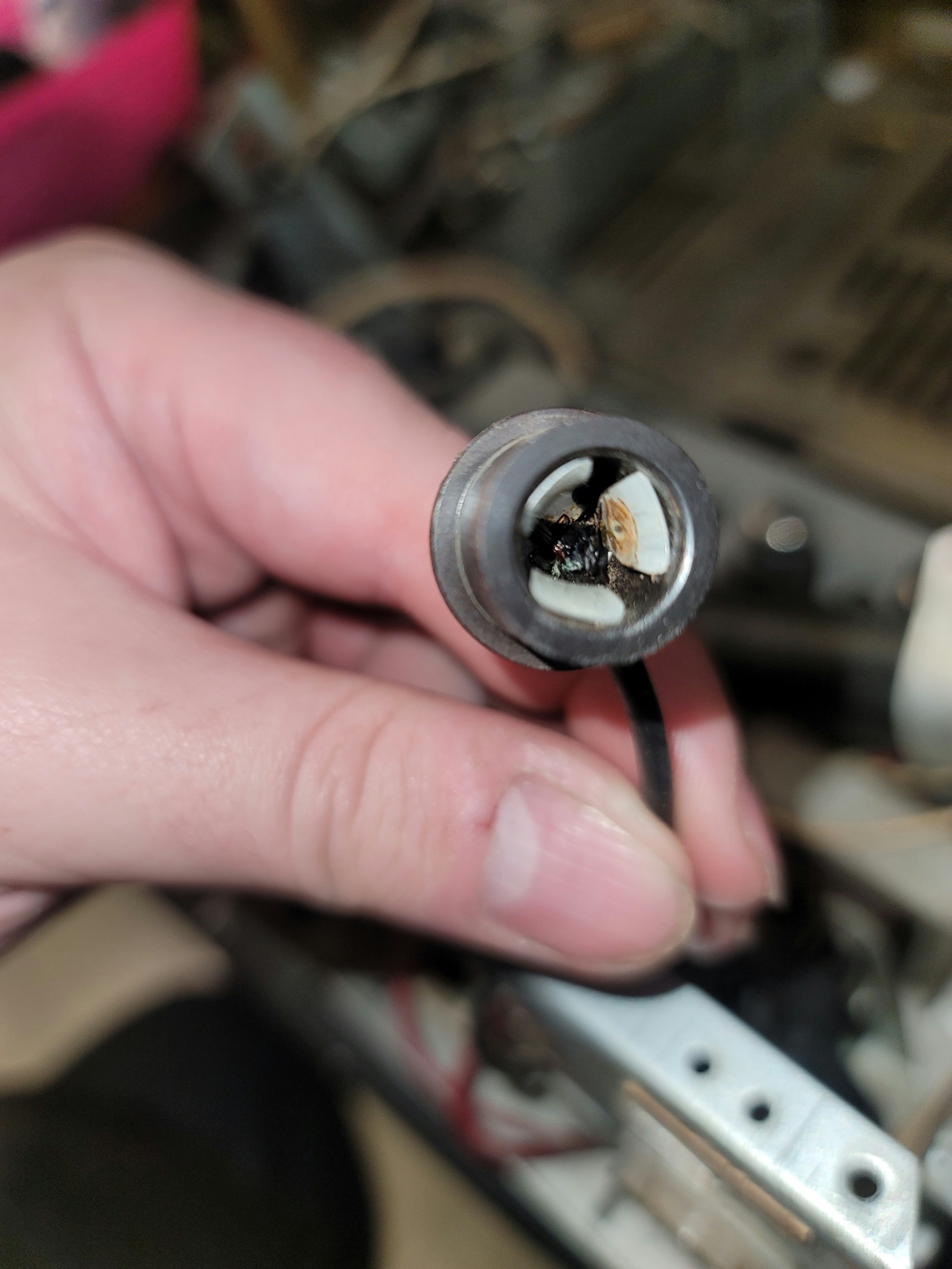

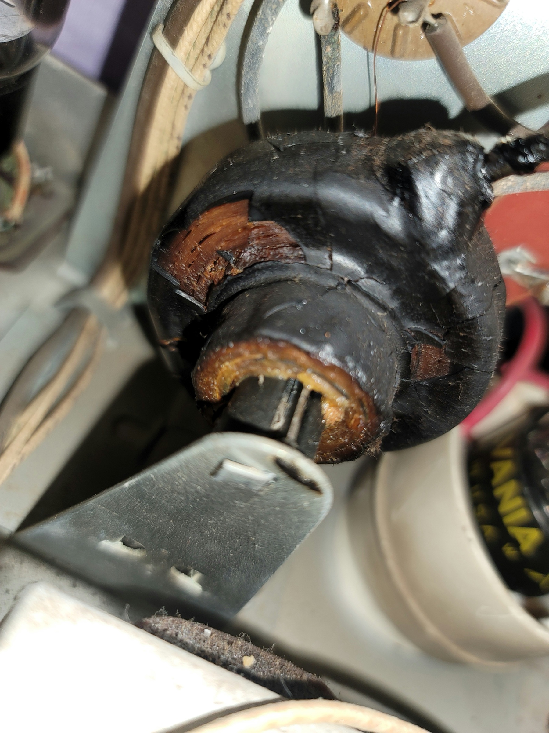

I found that the wire insulation was burnt. The fly back needs corona dope! Why would someone put that there?

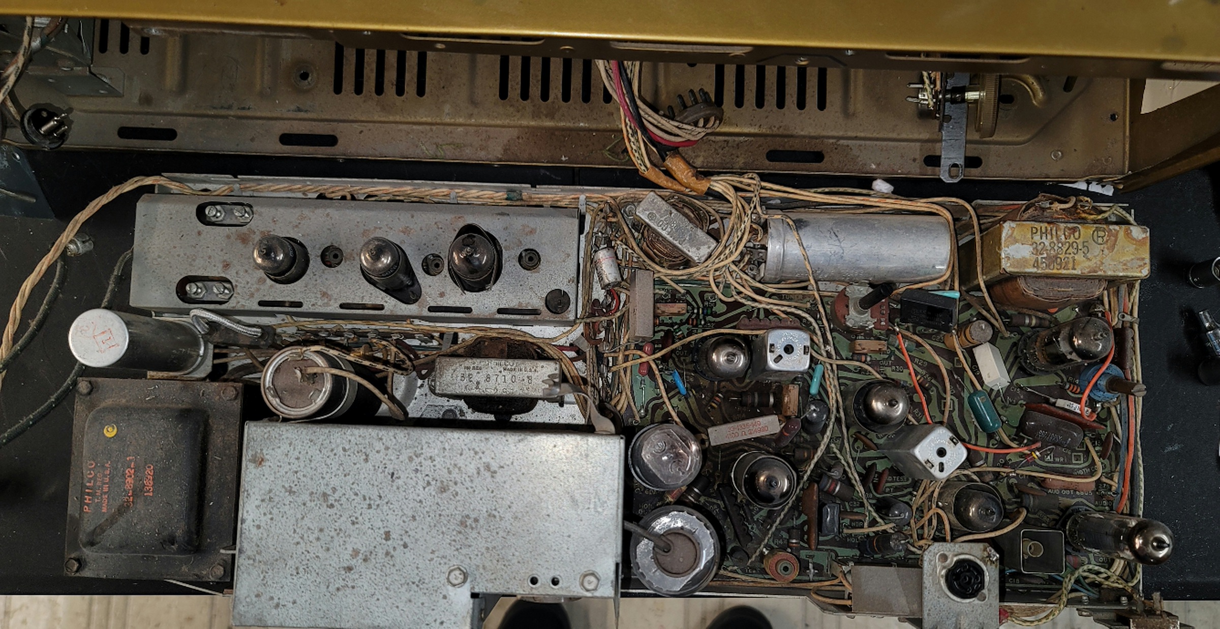

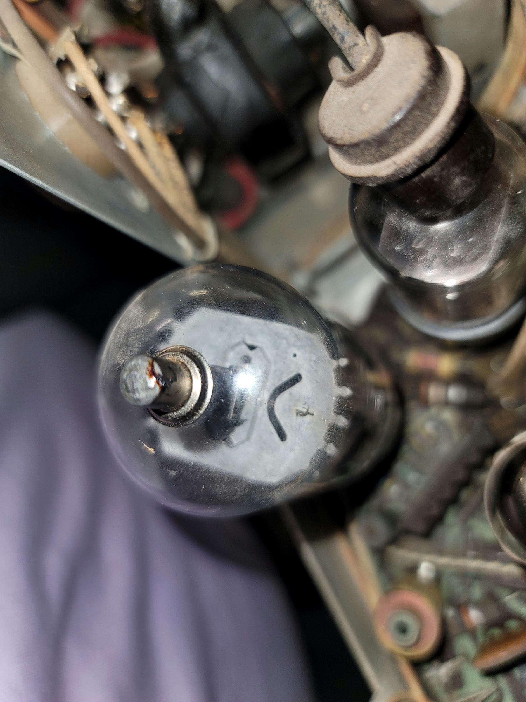

To me the picture looks "bloomed", as in low high voltage. You're probably using a set top box, which will cause the dark spaces at the top and bottom (normal), I'm also observing that it looks like most of the capacitors are originals. Those should be replaced, which is some work, but could be some are 'leaky', causing a drain on your power supply. I don't know what your abilities are concerning TV service, but you should have around 14kv on the anode of your CRT (picture tube). Some immediate causes would be a bad 1B3 high voltage tube. They tend to go to air and are readily available on different sites. You could look for a violet/blue glow from the HV tube,(inside the high voltage box) connecting to the flyback. If you see that, the 1B3, its bad. But that glow ON the glass (of other tubes) doesn't mean the tubes are bad, unless its inside the elements, which IS bad. Also, be very careful not to break the lead off that flyback transformer. It looks like the damper tube has some use on it. This could be causing your problem too. Usually you replace the horizontal output and damper as sets for good measure. This would probably solve the immediate problem. I doubt the picture tube is bad, those 17" usually last a long time. Mr Anderson has a lot of good videos on these and might jump in here too. (BAnderson tv on youtube) Also, IF you do try to test the picture tube, it is probably a 2v filament, so be careful.

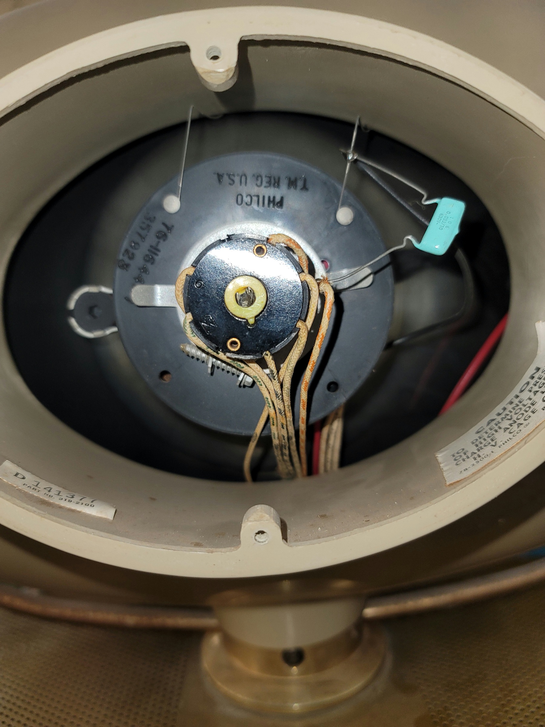

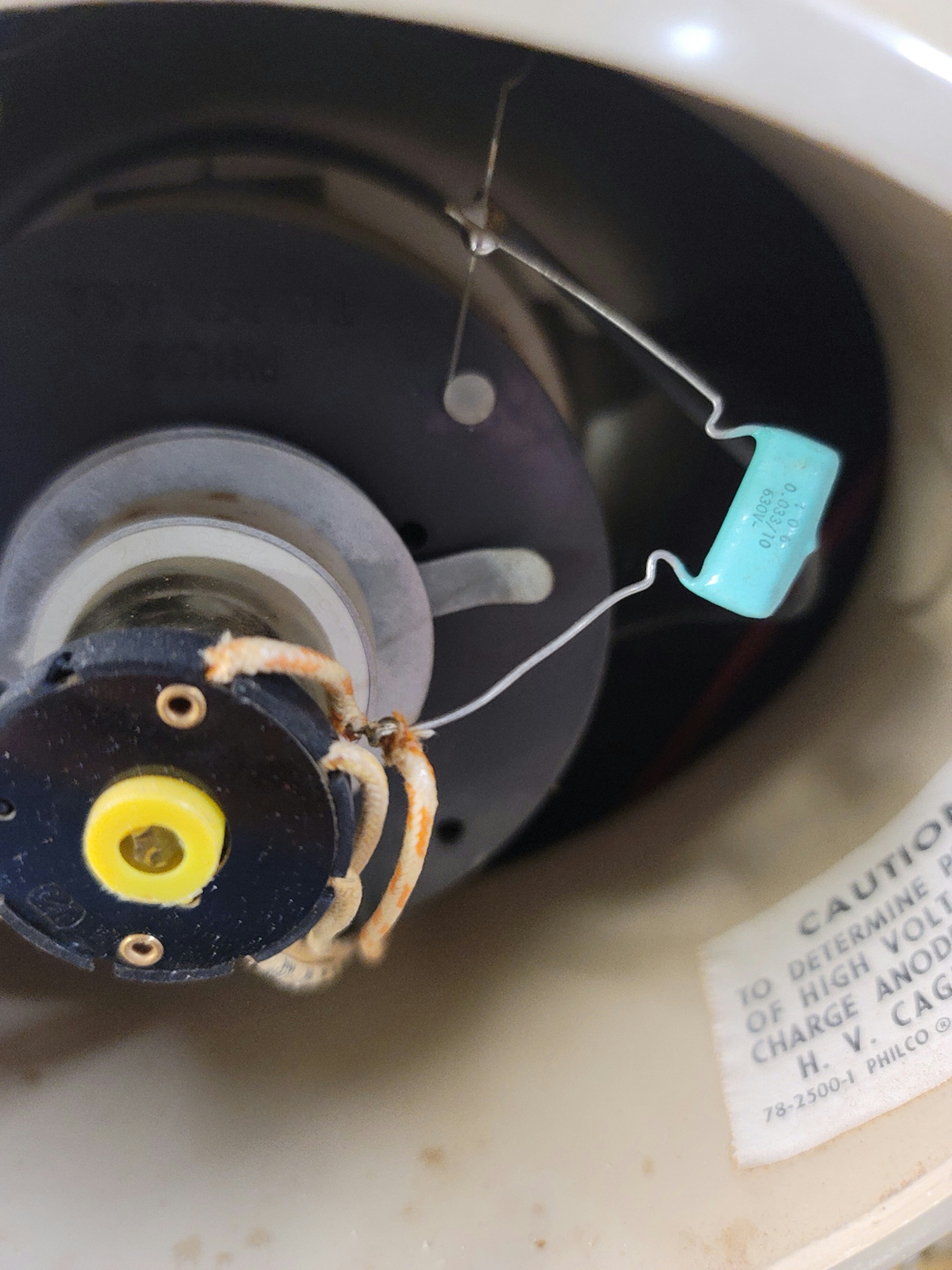

I'm currently working on replacing the original caps, like the paper ones and black beauties and I found that some of the replacement caps currently on my board were not the right values! I also removed those pods, I'm not sure what the purpose of them was but I shouldn't need them if I replace everything properly. Also do you know why a capacitor would be on the crt yolk connected to ground? I just pulled the board and I'm going through and testing some resistors also before I order everything. I did purchase a new 1b3gt just in case and I'm looking at getting a new damper tube now. I also noticed the damper is loose in its socket, do they make modern ceramic replacements for it? My hope is that it is low high voltage like you suggested and once I replace the components with more reliable and in tolerance ones that it will function properly like it did!

As far as that cap on the crt, without a schematic in front of me, my guess would be that they're either trying to use it as a HV filter or they've bypassed a bad cap on the board. The schematic would show if it's suppose to be there. I'd take a look at my Siesta, but it's buried. I have a 21 out and in pieces, so I'll take a look. Bob Anderson has some very good videos about restoring these on YouTube. There's also couplates available online. About 50 if I recall, probably be money well invested. They affect sync.

From the photos, this TV is long due for....gentle maintenance. Starting from vacuuming and ending by...recap?

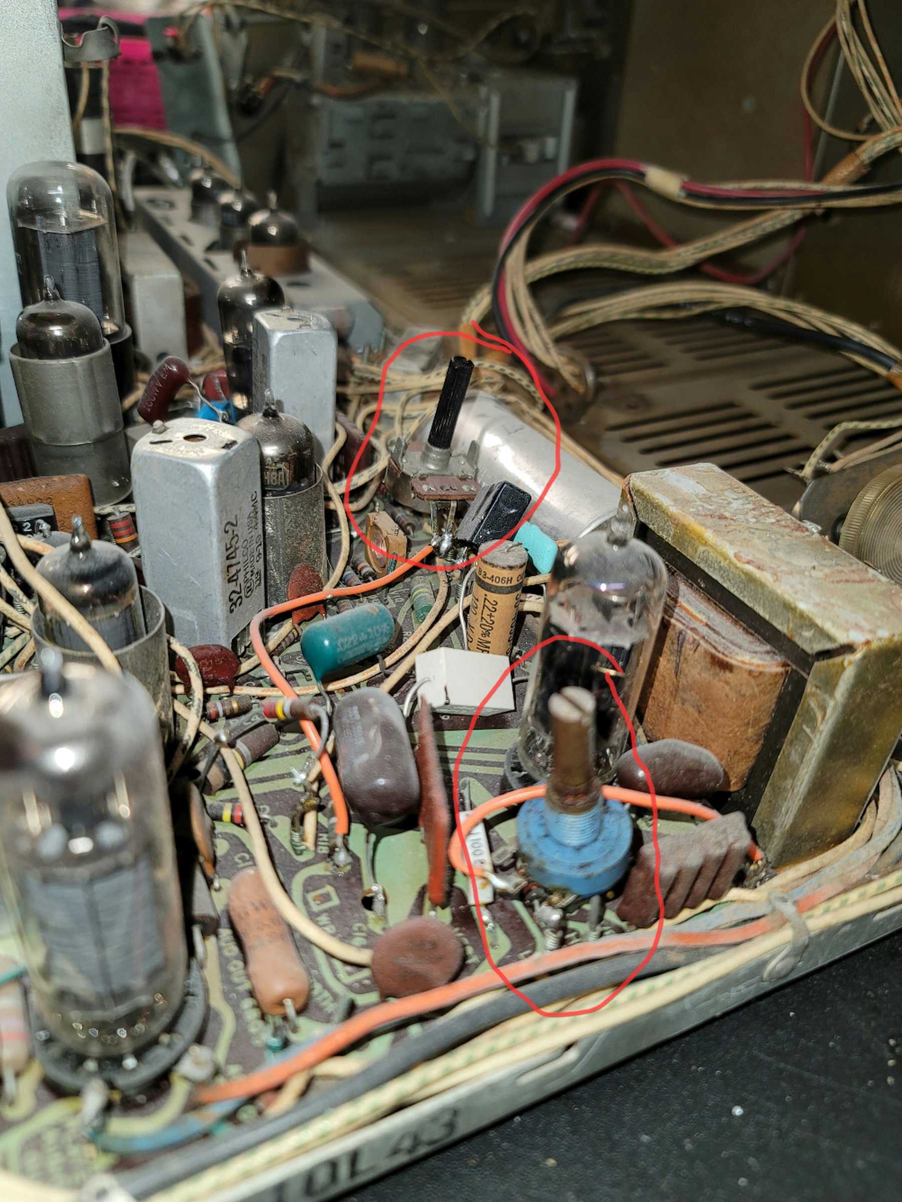

They went for the low hanging fruit and replaced the paper caps they could get at from the top of the board. They left the vertically mounted paper caps installed. Looks like the vertical linearity pot burned out (a common problem) and they tacked in a pot and left in on top of the PCB.
I'd pull the main board and go over everything. Yes, a little super corona dope on the flyback donut will do the trick.

Someone went the lazy way to recap this set and no way around it as bob said pull the board to do it right ! Sincerely Richard
