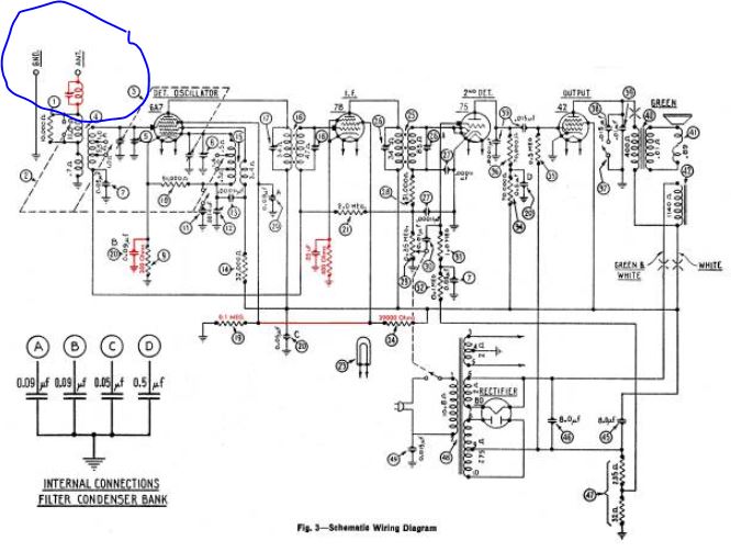

Usually a wave trap is for keeping IF signals from entering the antenna and from leaving the antenna. You feed an IF signal into the antenna and adjust the trap for minimum. But I don't see a trap in the schematic.
Rod, My radio is run 7. The wave trap is on that schematic as shown in the picture.
https://philcoradio.com/library/index.ph...-model-60/
Well, a wave trap is a trimmer in series with the coil so at the resonant frequency it provides a short to ground. This looks like something else, more like a broad boost, depending on which band it's resonant at. Perhaps for SW. In this case I would tune it to maximum signal like you did.
