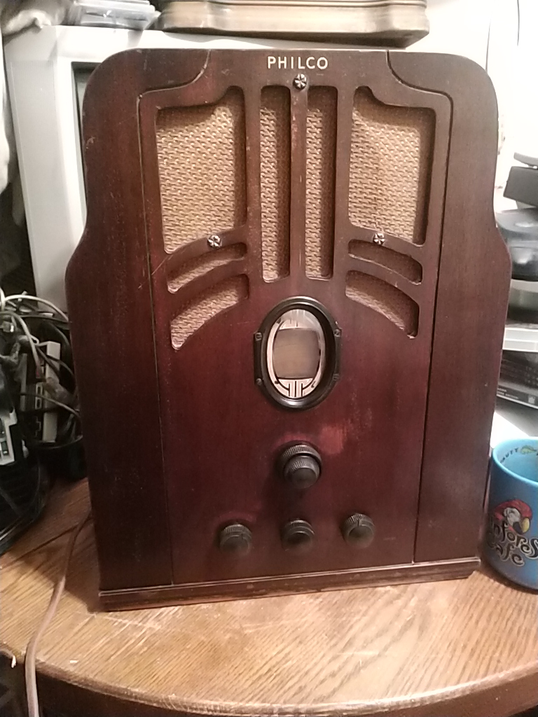

During the Canada post strike, I bid on a Philco 610 in  good shape.
I didn't think I'd win, so I had nothing to lose so I threw out $50. The days went by and nobody else bid, and I won it! Hot dog! I always wanted a tombstone radio but they go for big money if they aren't baked and trashed.
It looks like it has originall knobs, grill cloth, some original Philco tubes, and the original cord. Finish is decent.
Thank goodness it got to me in one piece!

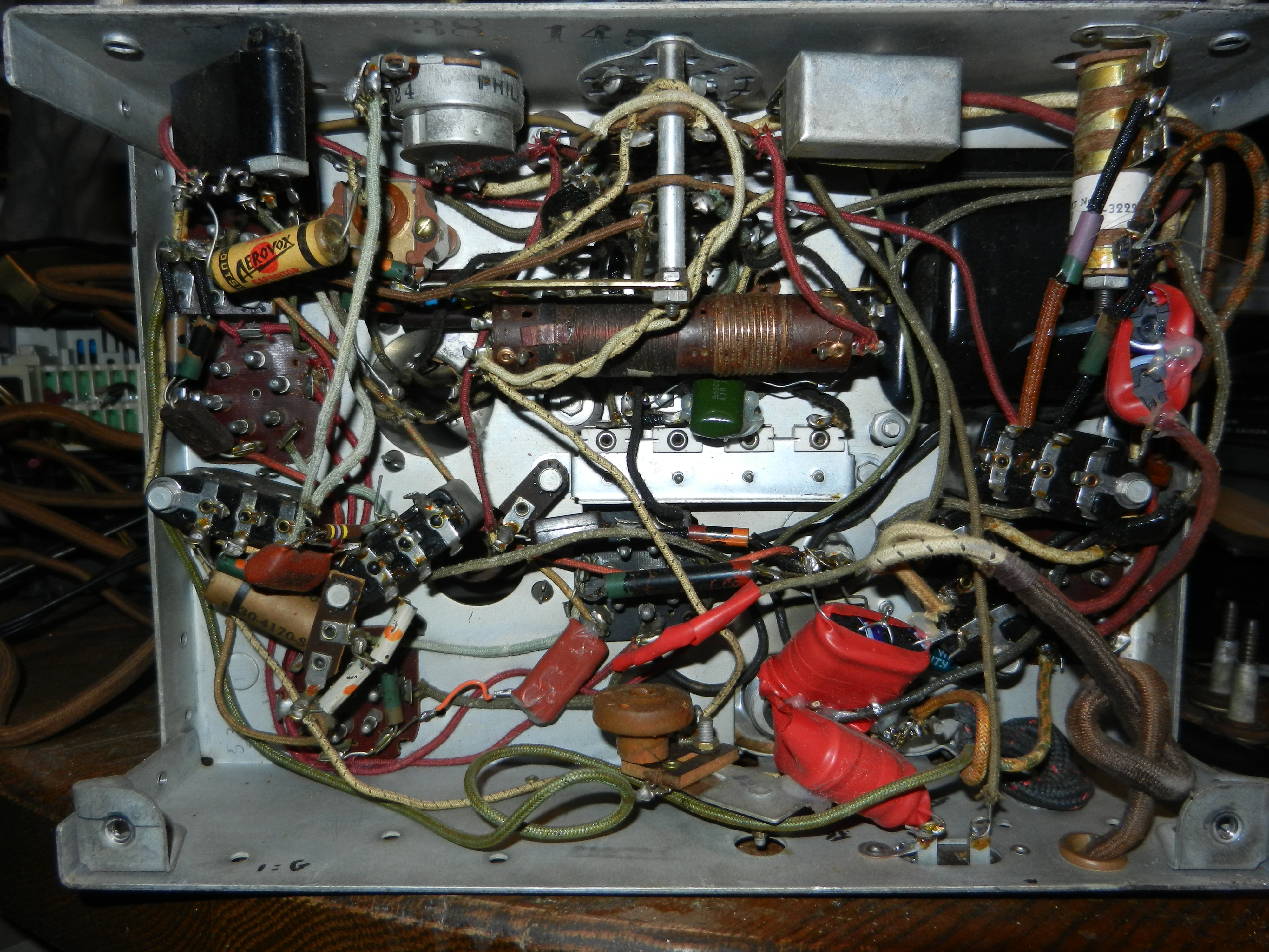

Got the old girl to my table, pulled the chassis out and somebody recapped it really sloppy.
Powered it up through a 100w bulb, put on a one foot wire, and it came alive happily pulling in lots of stations. Zero hum.....ZERO.
Speaker doesn't rub. Dial light was dead until I poked around and it came to life illuminating the dial!
Tuning is way off on the am band like by 50khz to the left if I tune to station 800khz.
Shortwave is dead and switching to the defuct police band has bleed over from the AM band.
Cleaned the case with murfeys wood soap and warm water. Knobs too.

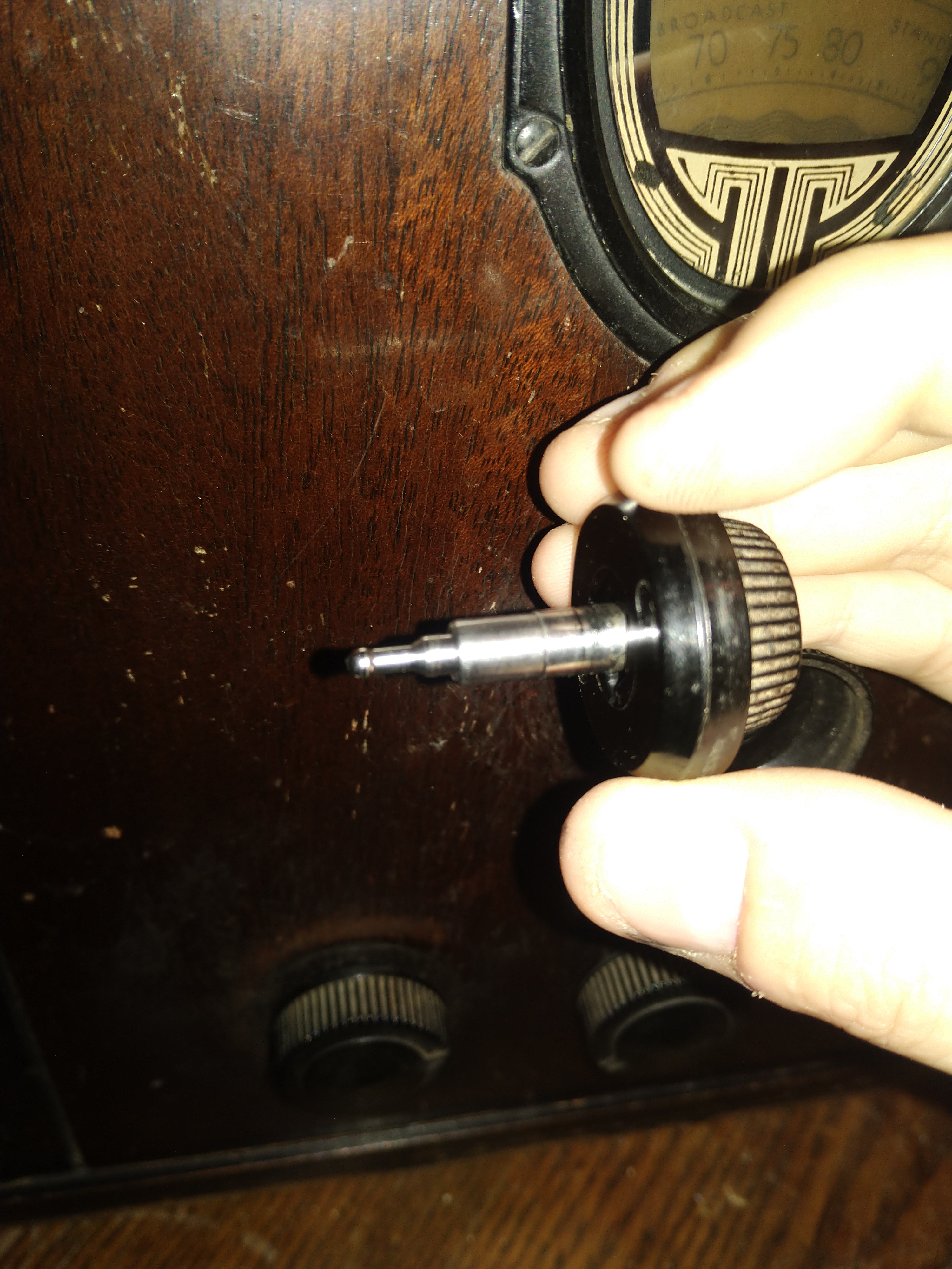

The tuning knob, the center fine control came off in my hand the shaft popped off some unseen coupling. Does anybody know how the gear reduction mechanism works so I can get it back on? The center knob came off with the shaft with the balloon the end with it.

If you mean you have a shaft with a sprocket on it, and if it has a brass bushing like this one (shown at the end of the page in the middle of the dial), it came off of that assembly.
Or maybe it has some waist with a small bulb at the end.
I do not remember if it has same type gear.
If it does, it has some spring-loaded ball bearings, that make it rotate a larger cylinder that has a sprocket.

I think your tuning shaft has lost a C clip that holds it together. The inside shaft is separated from the outside shaft with 3 or more ball bearings setting up a planetary shaft where the inside shaft rotates at a ratio to the outside. The inside shaft may also be serrated to keep the whole mechanism from drifting. It all needs a good cleaning and lubricating. Don't loose the balls. My version is from 1935-36 and has a spring loaded friction disc at the business end that moves a thin curved rod attached to the dial. I believe yours has a gear attached.
Yes, I think Rod is right and the Jesus clip is likely missing.

I want to undo a lot of the crappy repairs the last clown did and to a proper recap, clean up of the hacked up wiring, than realignment and a real antenna hooked up.

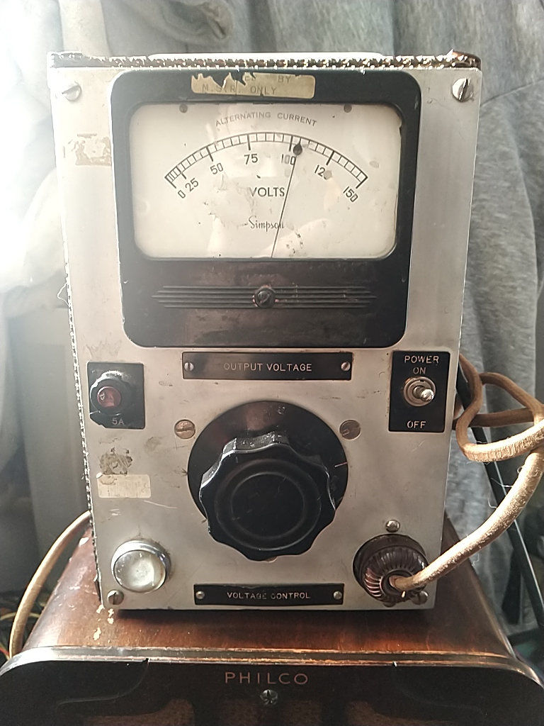

In my area the grid is roaring at nearly 127v at night.
I have a fifties vintage military radar station auto transformer.
Hooked it up and fed it 110v.
Poor old girl.
A couple years ago I took a 200w power strip shaped UPS and scooped out the inverter circuit.
Wired the beefy 12v transformer in buck-reduce and wired the built in outlets to that. Run everything in my bedroom and it keeps my pre-80s stuff happy and even my modern stuff seems perkier not being grilled.
I may make a little unit just for this radio, so the auto transformer can be used elsewhere
