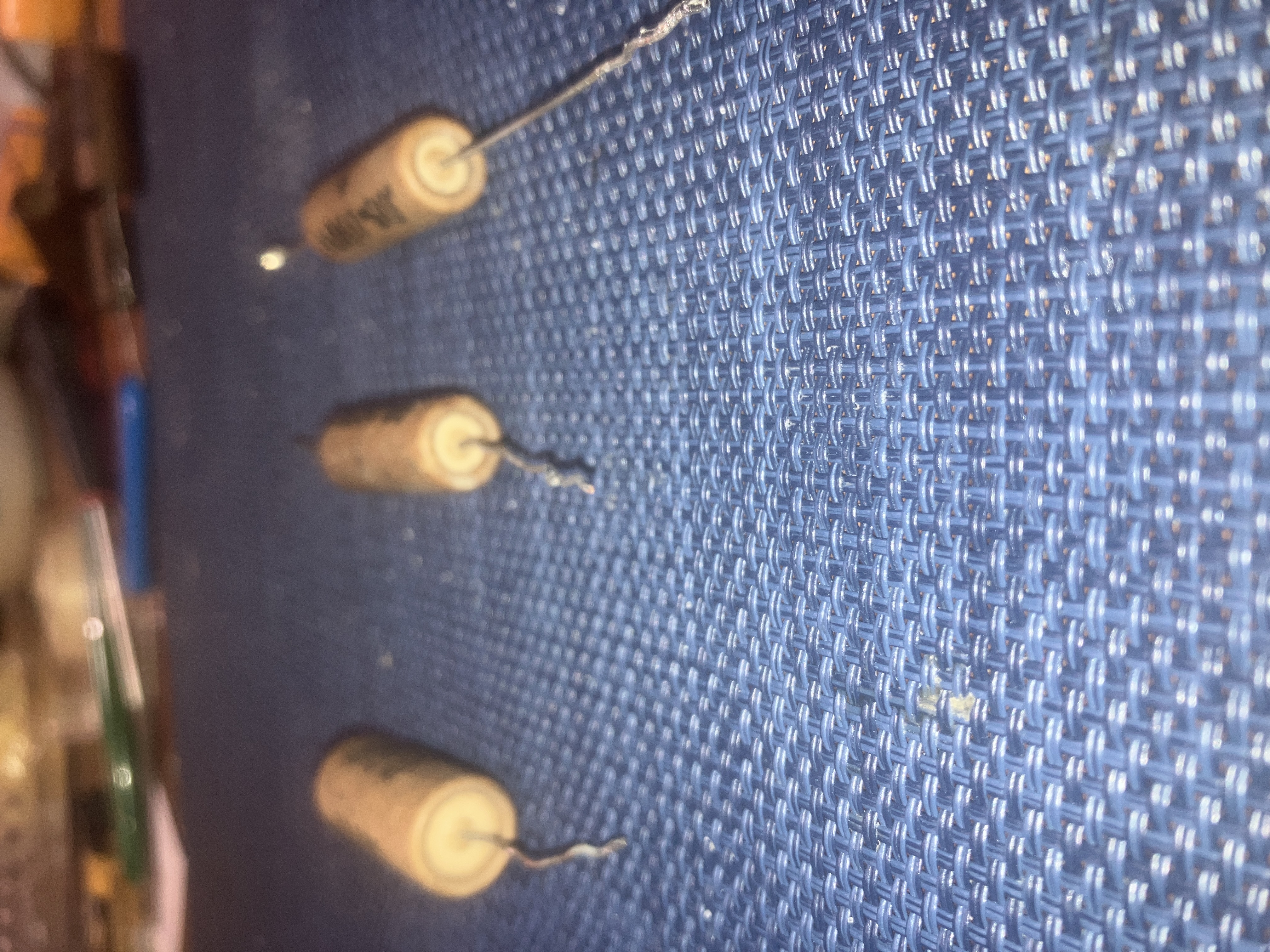

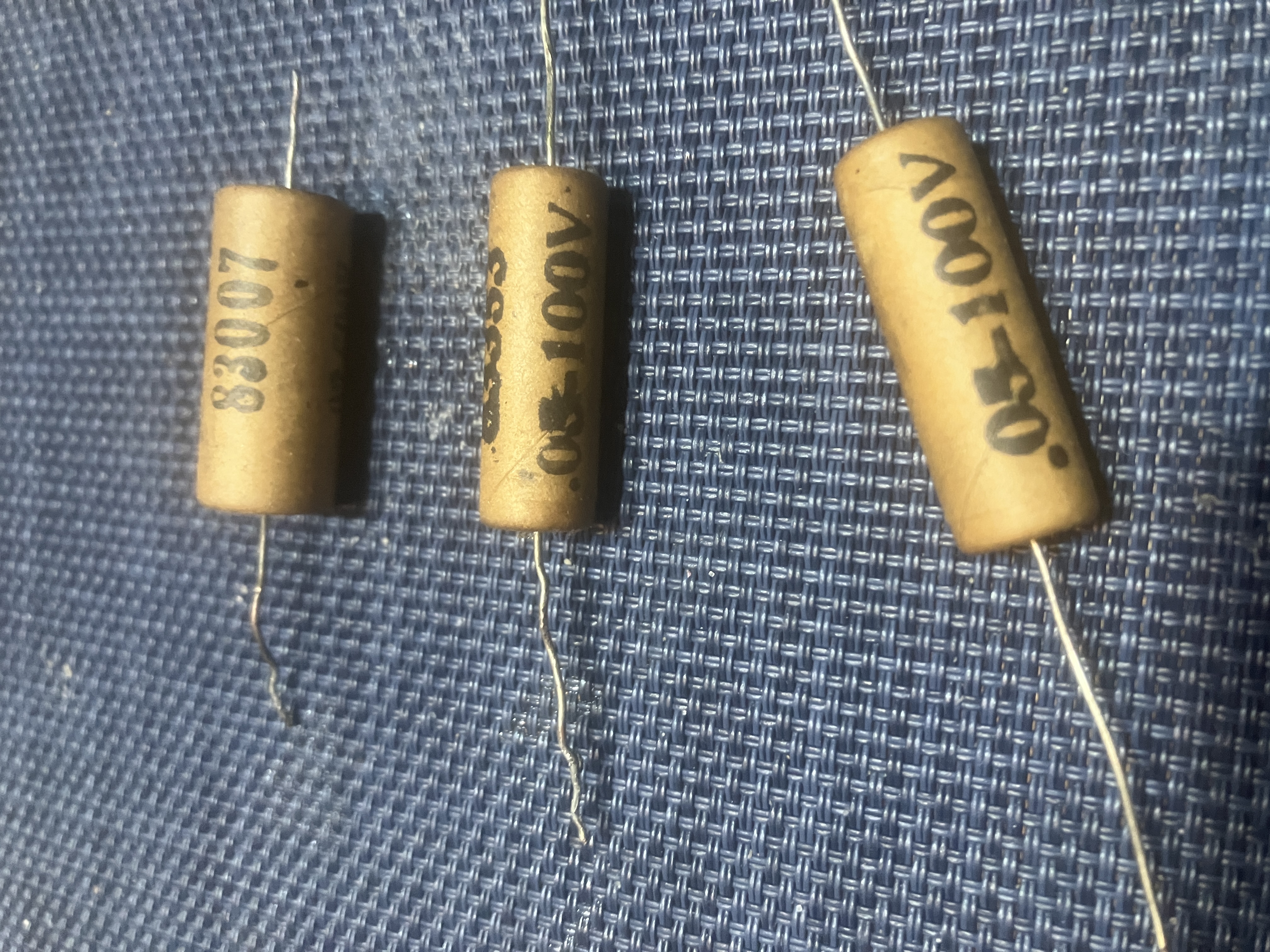

Hello everyone, I was replacing the original capacitors from my 1934 Stewart-Warner Tombstone Radio the other day and I noticed that the original Coupling Capacitors in the radio seemed to be of a better quality than the usual "waxies" you find in other radios from the same time period, as the ends of the capacitors in this radio were plugged with cardboard endplugs rather than the usual wax endplugs. Were there other types of capacitors in the 1930s besides the wax coated paper caps that you usually tended to see in radios from this time period and were they a better quality capacitor than the usual wax coated types, were these maybe oil caps of some sort? I haven't had a chance to test them to see if they were leaky or not but the physical condition of these caps is like brand new yet, nothing leaking out of the ends or anything, the only thing physically wrong with some of them is that the cardboard tubing has been darkened over the years due to being near some high wattage resistors that put out enough heat to discolor the cardboard tubes and also being near the 2A5 tubes that also get pretty hot, because they seem to be driving them to their limit voltage wise.

RCA used caps like these in some of their radios. I have 2 RCA Farm sets ca 1936 that used caps like these. pop out the disk and you will see some sort of gloppy cap that was essentially a foil / wax cap without the paper
The paper disks do pop put relatively easily. If the caps are still in the radio, slide the tube as far as you can, cut the cap (capacitor) lead at the "gumdrop" (or other amorphous shape). Do the same to the other side. Slide in the new cap which will be smaller than what you are replacing. Solder to the existing leads, reassemble and there will be no evidence that you changed the cap.

OK, Interesting, I didn't realize these were used by other companies as well, I've only seen this style of caps in one or two other radios I've worked on over the years, an old Battery Powered Farm Radio from 1937 and an old Westinghouse Columnette Tombstone Radio from 1935. So by the sounds of it these might of been early Oil Capacitors?

I don't know about the caps used in this Stewart Warner, but with the ones used in RCA and G.E sets you can get the old cap out by placing a suitably sized mechanic's socket on on a table or bench, place the end of the capacitor down over the socket, grasp the paper tube, and push down, the cap will pop out of the end opposite.

Captain Clock, I did not cut up the innards of the caps, but I don't think that they are oil. The paper in most tubular caps may have an oil coating, but I don't think of those as "oil" caps in the sense of the original oil filled caps that are hermetically sealed.

OK I wasn't sure, I was just asking because these capacitors look like they are of significantly better build quality than some of the capacitors of other companies from that time period (specifically companies like Good-All, and Seal-Tite.)
