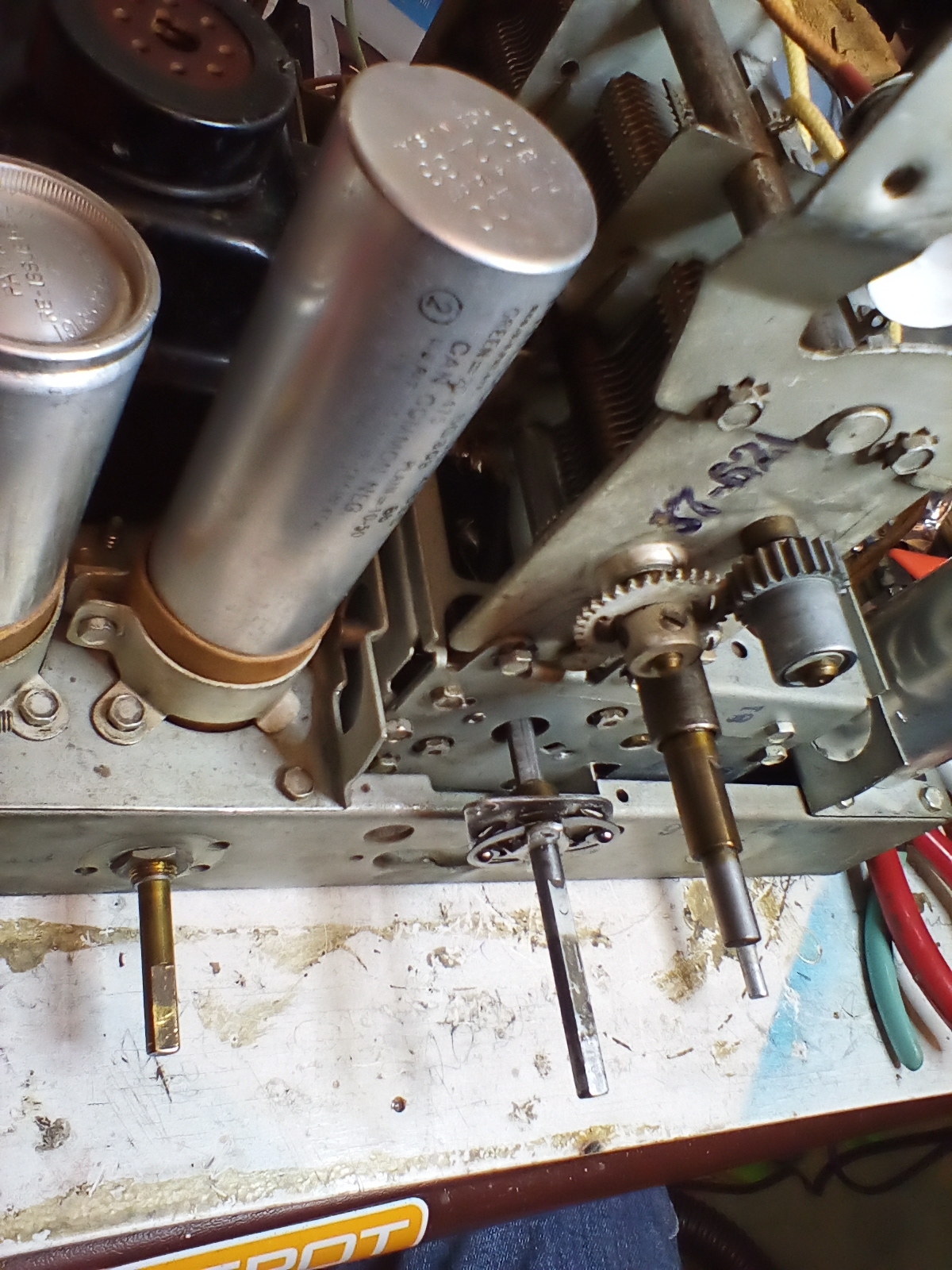

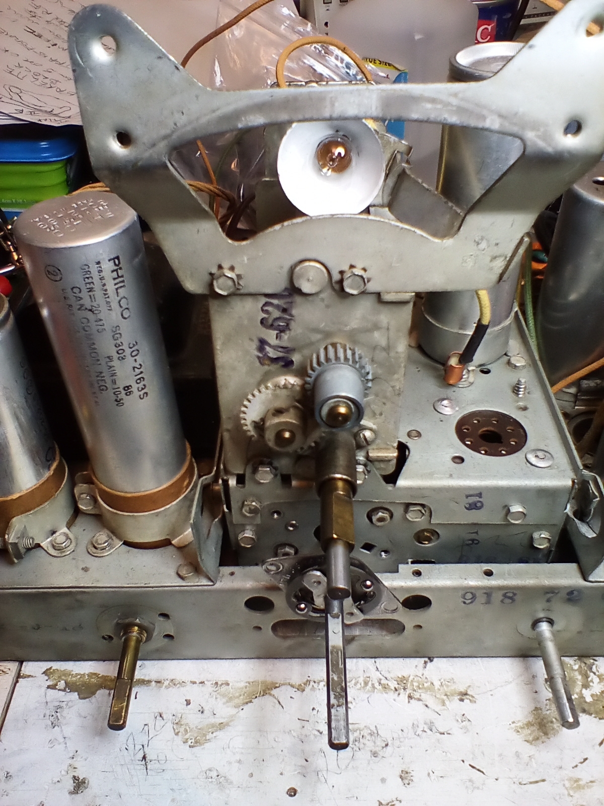

Hello Phorum Members:  I am attepting to reassemble my 37-640 during restoration but have encountered a problem reinstalling the bandswitch.  I have inserted the shaft of the bandswitch with the flatside up so that it will be in the BC position but it seems to get stopped at about the last wafer position and will not go in all the way.  Can anyone offer any suggestions of what I might try ar what the problem is.  Thanks--John
Maybe a photo would help.
Was about to ask what Rod's asked.
Let's live nothing to the imagination, so to speak Icon_lol
Rodb and Morzh, thanks for the reply.  Attached are 2 photoss that I hope will help with my question.  Thanks again, John
I will be very honest, I do not know if this even matters.
https://philcoradio.com/phorum/showthread.php?tid=20907
I found this thread. The chassis seems as "unmolested" as it gets.
Seems, the blurred it is, the flat side is up.

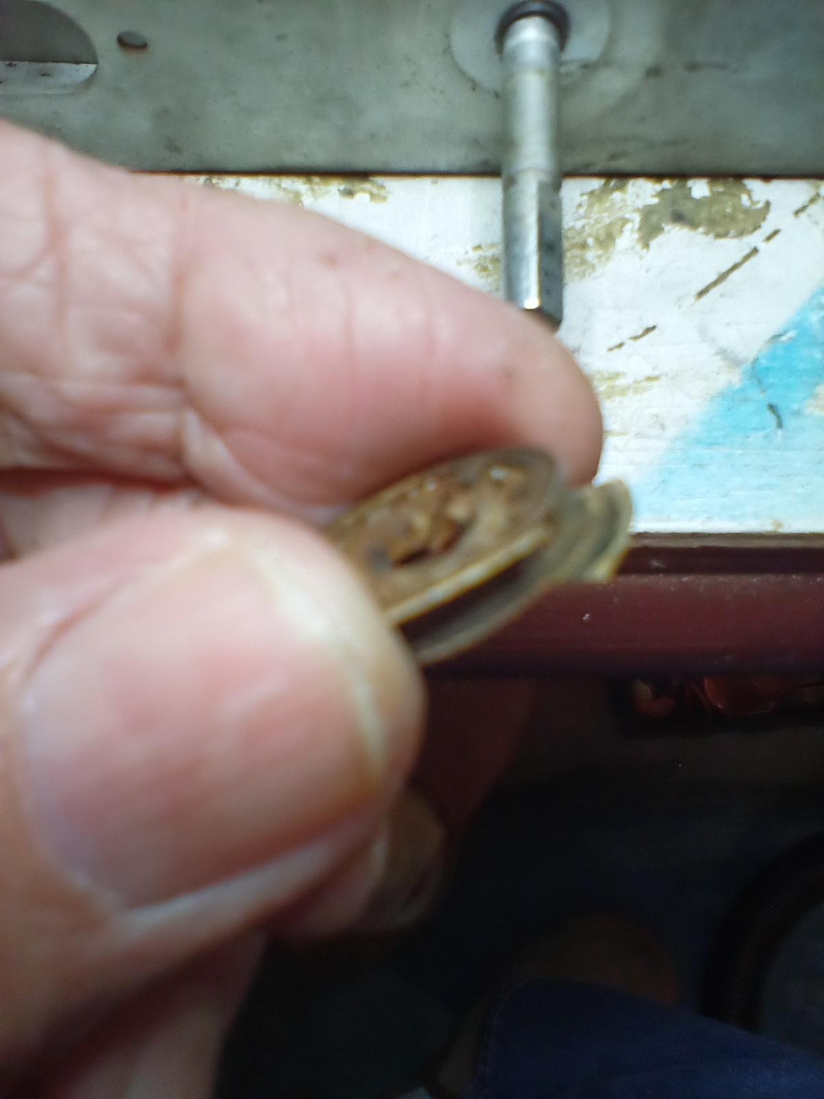

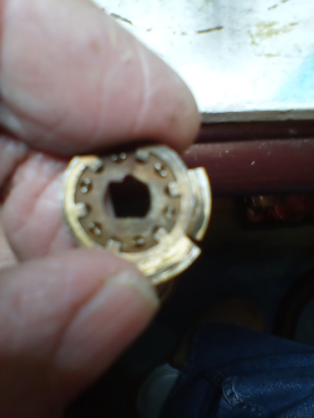

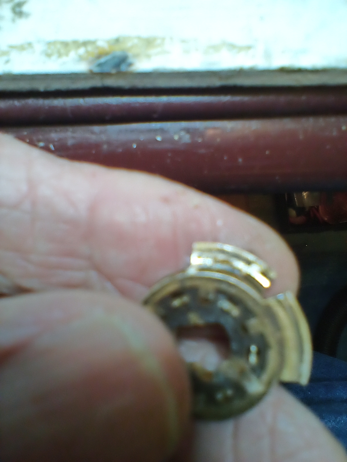

Thanks for the replies.  I finally was able to wiggle the shaft of the bandswitch and it slid into place, however while I had the chassis tipped up on its side, a strange looking piece fell out!!!!!  I have included 3 photos of the piece.  Does anyone know what this is and will my radio ever work again?--John
1. Yes, I think I know what it is. It is the piece that goes over the shaft and rotates, switching between the contacts.
2. Try to get the photos a bit sharper. It actually hurts physically (for some people, me in particular) to look at blurried photos.
I'll be working on a 38-4 next weekend. If you need more help I will have a close look at the switch or any other issue.
Thanks for the replies.  Hopefully, when RODB take his 38 model apart, he will be able to ID the part.   I will try to get better photos but that may be the best my old tablet can do for close ups.  If this part turns out to be part of the RF bandswitch, what is the chance of finding a replacement or is it not worth it and just put the radio in the trash---John
Good question about the chances.
But I see that the "D" is still preserved; that gives me hope it could be somehow re-installed (wonder why it fell at all).
As for the tablet cams...use the phone. Their rear cams (that is, if you have a cell phone; some folks have ideological objection to them, which I fully understand) today are amazing.
And then just drop the pic using your phone as the tablet to access the Phorum. I do that sometimes.
OK, I have discovered that the part is one of the roatating contacts for the bandswitch. It has 4 different orientations for placement and only one is correct for proper function.---John
I think that part is meant to be a permanent part of the switch.

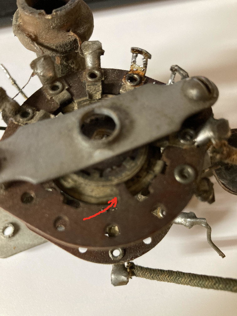

I took a look at one I had lying around. The wafer with the stationary contacts appears to have "fingers" holding the "rotor" in place. I marked one in the picture below (you can see one):
Maybe you damaged one or more fingers and it got loose? I kind of thought the engaged contacts would have held it in place (would think there are some for each position).
I suspect it would be possible to replace it and the contacts would hold it in place long enough to get the shaft put in place. You have to figure out how to not put it in "backwards". Even if the fingers are busted, the contacts may be enough to keep it from "wandering" on the shaft? Just guessing...
Is that the last one of the lot? If so, maybe that's why the shaft finally went in.
