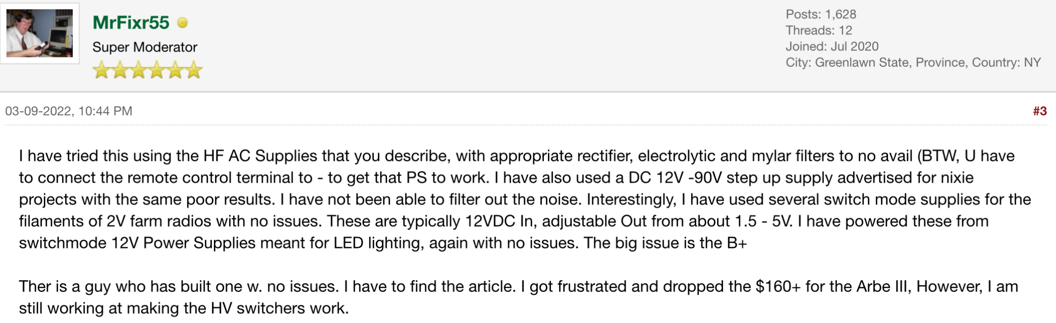

Having recently read the post attached as a jpg, I got thinking.
There are many car radios in the market with high power outputs, 4 X 50W or more. I presume these use some form of SMPS. I recently bought one (https://www.amazon.com/VDO-Continental-T...B08D2R48HZ, but mine is for the European market with LW, SW and DAB+) and AM on these works just fine, with no interference.
I intend to investigate how it is done. Sadly I have no service manual for it. I am not sure in today’s fast-moving, disposable world manufacturers bother with those or any repair assistance!
