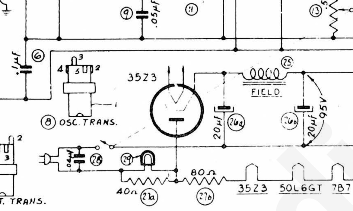

Well the 35Z3 doesn't have a tap on the tube heater for a pilot light, so in this set they have the dial lamp paralleled with a 40 ohm power resistor, between the hot side of the power line and the plate of the 35Z3. In some sets, like my 42-327, they used a 120 volt candelabra bulb across the power line to light the dial, and basically the whole back of the set for that matter.

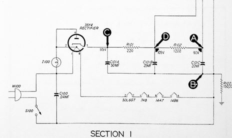

As for fusing, most sets using a 35Z5, 35W4 or 35Y4 (the ones with the tapped filament heater) puts the rectifier plate (and the B+ load on the tap.  A short in the B+ or heaters in the other tubes would blow the section of the 35Z5 heater between the power input and the plate (and also the pilot lamp).
Attached below is the Power Supply section of my 47-205 that uses a 35Y4 in the manner described above.  No resistors are used because the convertor, IF and detector / 1st AF are 14V tubes, so the total filament voltage of the string is 127V nominal.  See below:
In your set, the 35Z3(a Loctal) tube does not have the tap that a 35Z5 does.  In addition, since the convertor, IF and detector / 1st AF tubes are 7V types, you need the 120 Ohms that the Candohm resistor, #27A / 27B provides.  Since the 35Z3 is part of the heater string, pulling the tube not only breaks the B+, it breaks the filament string, therefore no current will flow and the pilot remains off.  IMHO, the Candohm acts as a fuse (albeit an expensive and had to replace one) in a manner similar to a 35Z5 filament as described above.

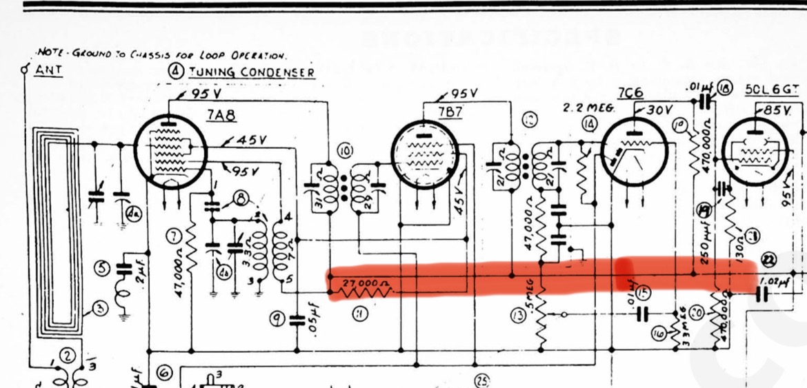

Last question: alignment instructions say connect the positive terminal of the voltmeter anywhere that the AVC voltage. New to alignments so where would that be?? I’m reading it as the red line I have marked in the photo
Nope. That's B+ to the tube plates.
AVC is at the bottom of part 14 (2.2 meg) then feeds the grids in the rf amps. As the radio signal gets stronger the AVC voltage goes more negative. This in turn reduces the gain in the rf amplifiers. Strong signals reduce gain. Weaker signals increase gain.
