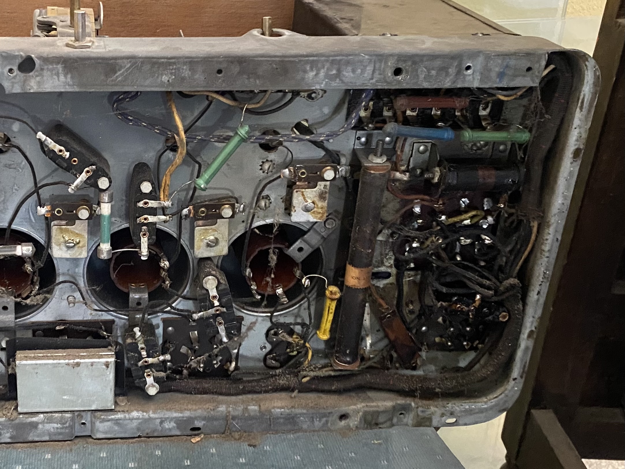

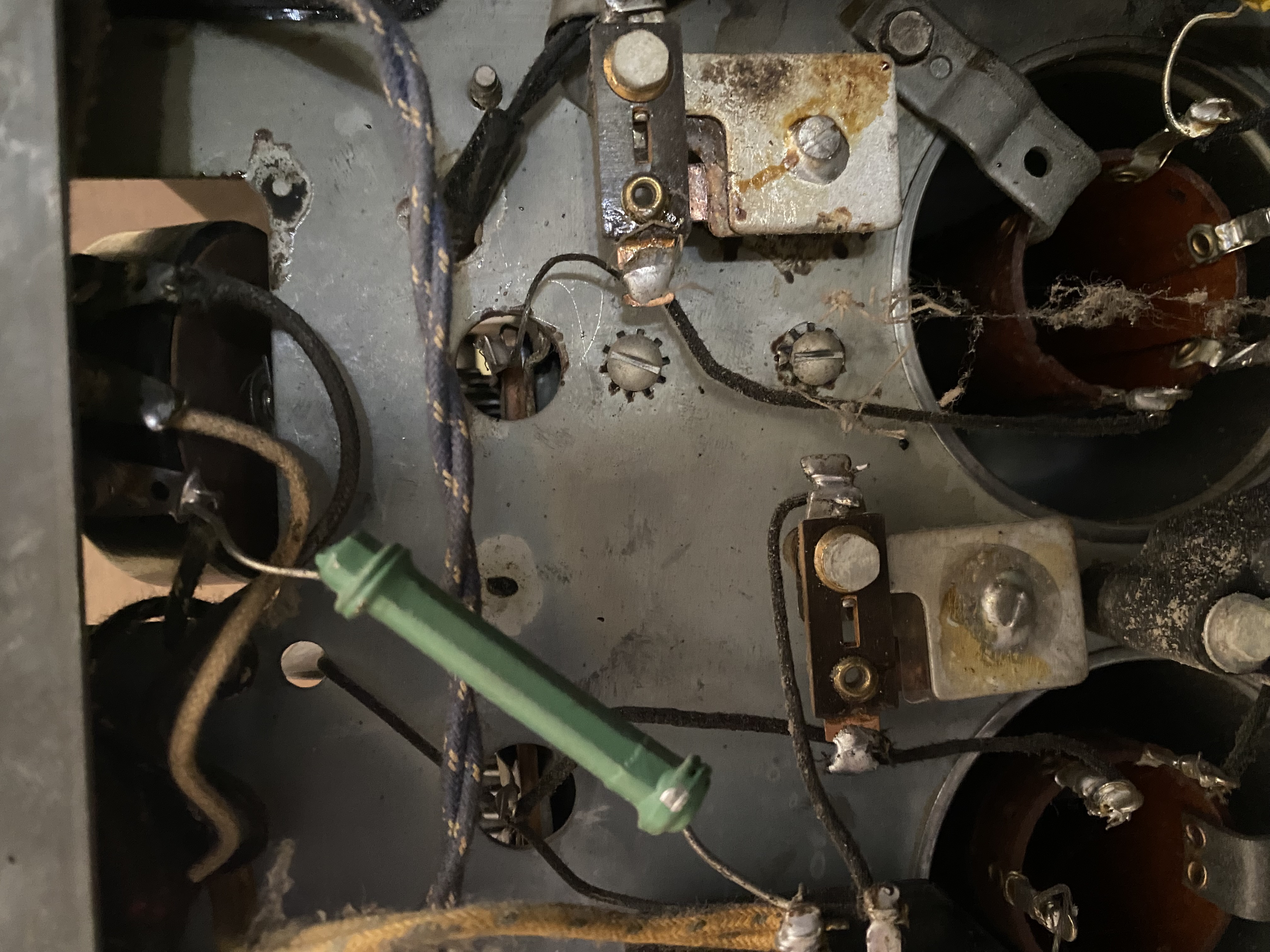

Hi all, I finally got around to pulling the chassis. My #33 resistor ( part 3542)is getting a reading of 80 ohms of resistance. According to Morzh any reading over 70 is not good. Does anyone know where I could get this resistor part and what the brand and part# would be?

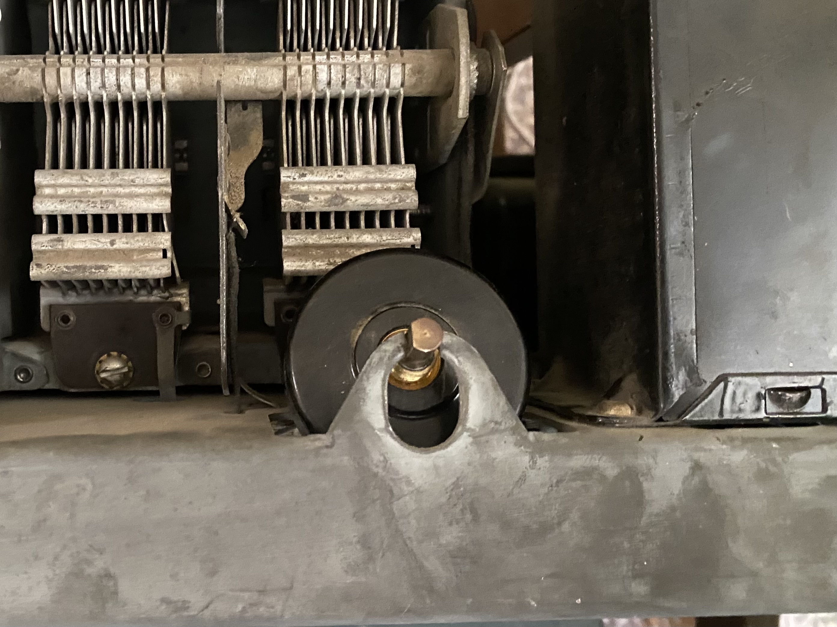

  My potentiometer is the closed type with no openings to clean/lube.
Sorry for the multiple images of the resistor, I am just learning how to attach files. I did not know the images did not show until you post.
I did not say "higher". I said "much higher".
80K is not much higher than 70K and is well within 20% tolerance.
Thanks for your reply!, Could the potentiometer possibly be the problem? Do you know if replacements for them available ?
The potentiometer needs to be checked. It is a very simple check., just measuring end-to-end and comparing it to the required value (it could be within limits, way out of limits, or even open) and then, IF the end-to-end is usable (even if you have 2x the value but no open, it is usable), checking the wiper operation (going from low to high value when rotated, without any interruption).
If satisfactory, it then could be gently dusted with a can of air, and lightly sprayed with F5 (important !!! not D5 or any contact cleaner) Deoxit or a well-regarded taper lube/volume pot cleaner, let dry and then re-checked.
Your pot has cylindrical resistor band inside and a roller-type brass wiper.
As long as the pot is continuous end-to-end (ecven if it is 1M or so) it should work. If your 70K resistor is, as you wrote, 80 (I think you meant 80K, as you wrote "a reading of 80 ohms") and not 70K, while it is OK, but the low volume is too high, you might try to variate the #33 to lower values until you find one that works best for you.
Also make sure this is the case with every station and not just with the strongest local station as often times with older radios (though they used a bit different volume control scheme) that station might come through even with the volume turned all the way CCW. In which case I would leave it be.
The two outside leads read open. The middle wiper lead and an outside lead I only get a reading when the knob is turned a third +- up.
Bare in mind I am checking the leads while they are still connected to their adjacent wires.
Bear. Bear in mind. Anything smaller than a bear does not fit there. Icon_smile
Now. If it reads open EVEN while in-circuit, it is probably open, and this is why you are having problems.
The resistor strip is held by screws and some clamps: see if you can gently fix it.
If not, get thee a 500K audio taper with a proper shaft (I am not sure the pot is audio, could be linear given how crude the whole thing is) and stick it inside.

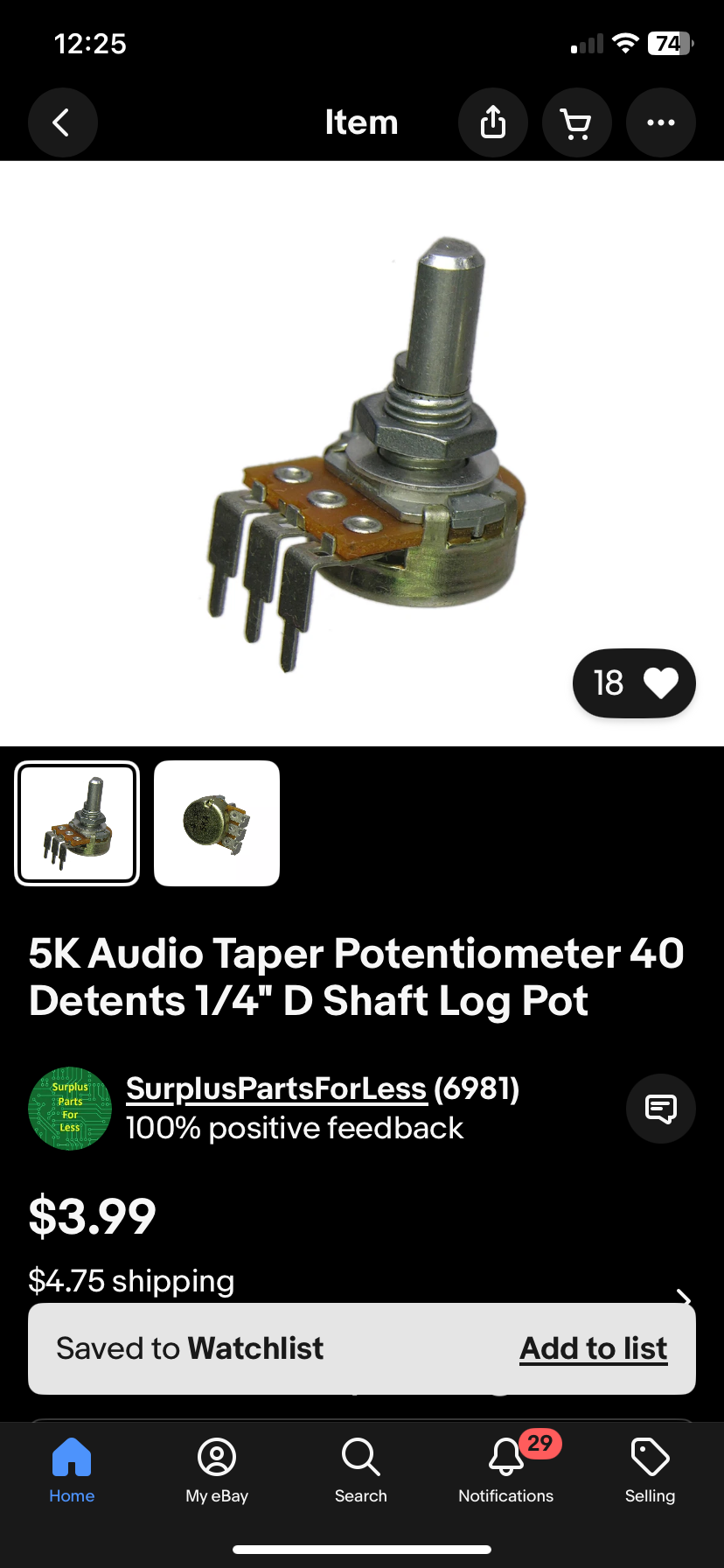

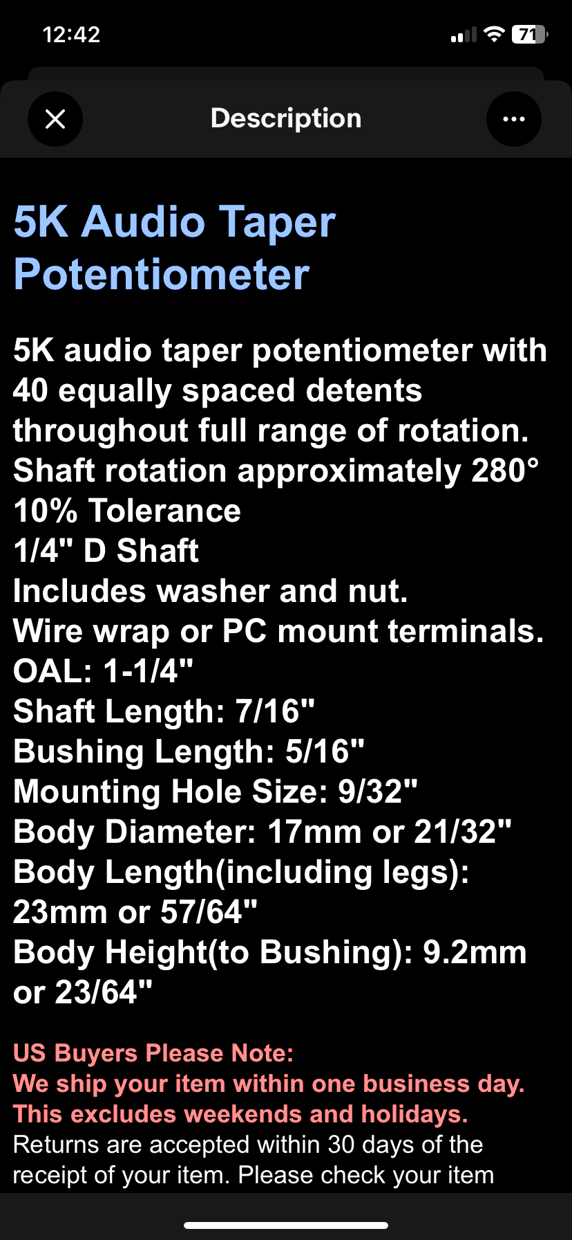

Do you think this would work? I would need to cut the shaft shorter.
  Not sure what “40 detents” means.
