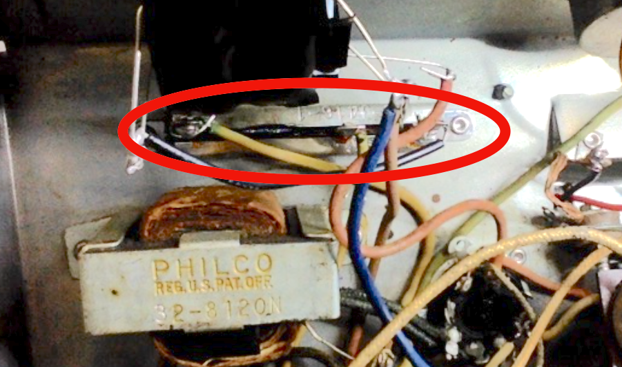

Hello Phorum, this is my first post here, I was fixing my first Philco (model 42-390) a day ago that I found a week ago, it was fine when I replaced the caps, when I switched the audio output tube, everything went wrong, the rectifier (Parallel 6X5GT of course) died in the most violently spectacular way (it even had cool flashing lights), the X-plate replacement almost did because it did the exact same thing (but it refused to die and it somehow works fine)
When I looked underneath the chassis and turned it on to find the source of the smoke and what I thought was smoke from the main components, this weird paper thing circled above was smoking when I plugged it in (it was shooting out smoke like a gas pipe from in between the paper thing), the only thing that connects to it is the negative end of the Electrolytics .
I need to know what it is, and why it's doing that, and if any component could be damaged.

That is a old fashioned style of heat sinked wire wound resistor commonly referred to as a "Candohm". If it was smoking then something connected to it was drawing a lot of current. If not then the only way it would do that on it's own is if the insulation broke down and the resistor shorted to ground. Did you power the set up before you started working on it? I'm guessing that a mistake in the wiring may have caused this, such as something connected to the wrong point, or a filter cap connected in backward.

Regarding your problem, the "Candohm" is a multiple tapped carbon resistor used in this set to provide various "grid bias" voltages.  Since this resistor is between chassis ground and the center tap (- return) of the HV power supply, all DC current flows through this resistor.  Since a short to ground would not be an actual dead short of the power supply, the failure of this resistor likely is from the same issue that caused your rectifier tube to exhibit the epic fail that you described.

Start out by measuring resistance ("Ohming") across the 8 uF capacitor labeled 49A in the schematic.  This "cap" is between chassis ground and the main B+ line that powers the output stage and the rest of the radio.  If you read a short or very low resistance here, troubleshoot this before powering up.  Verify that the capacitor is not installed backwards and that the working voltage is above 250 WV (Working Volts).  It should actually be at least 350WV.  Cap #80 should also be at least 350 WV, preferably 400 WV.  If you have the original "cans" check for capacity and voltage rating.  You can go a little above the rated capacity (10 uF instead of 8 uF or 20 uF instead of 16 uF) but not much higher.  BTW, don't just "bridge" the existing original cap, remove all connections from it, as the original cap may be shorted.  Another possibility is that if the output capacitor has an open winding, it will cause the output tube connected to that winding to draw all current through its Screen Grid, heating it white hot and likely shorting to the suppressor grid, which is at ground level.  This would amount to a short across the B+ supply taking out the Candohm resistor (and possibly the rectifier).  Measuring across Cap 49A, pull the two 41 Output tubes, one at a time.  If the short clears, you found the shorted tube.  It must be replaced.  Also, Ohm the transformer to confirm the open winding.  The transformer must be replaced before installing new tubes.  41s are easily available on eBay.
Once you locate and correct the short, you can replace the Candohm, #88 with 2 resistors, an 18 ohm from chassis ground to the center point and a 175 Ohm resistor between the center point and the center tap of the transformer (and the negative connection to Cap # 80). 5Watt resistors should work, 10 Watt resistors are even better.  As with the capacitors, do not just "bridge" the Candohm, remove all connections from it and use terminal strips to mount the resistors.  Consider the Candohm to be totally fried.

I was worrying about the output transformer more than the power transformer. When an output transformer has an open primary winding or if a radio is powered up without the output transformer connected but B+ applied to the screen (which will happen with an open output transformer), then instead of the plate dissipating all the current, the screen will. The screen is designed to handle about 2.5 - 5 mA, not 40-50 mA. Therefore, it heats up, burns out and touches the suppressor grid, essentially shorting B+ to chassis ground. This may be why your Candohm is toast.
Ohm your output transformer for open windings. If you find one, this may be the issue.
