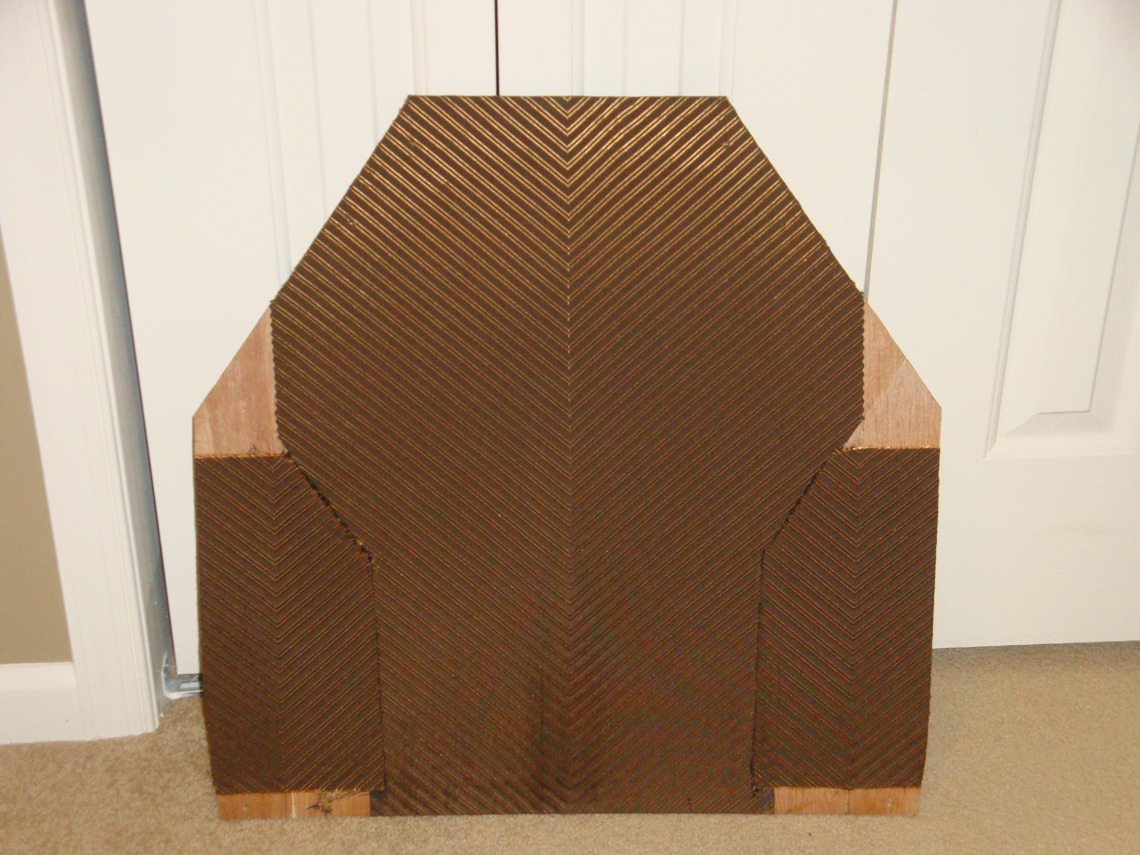

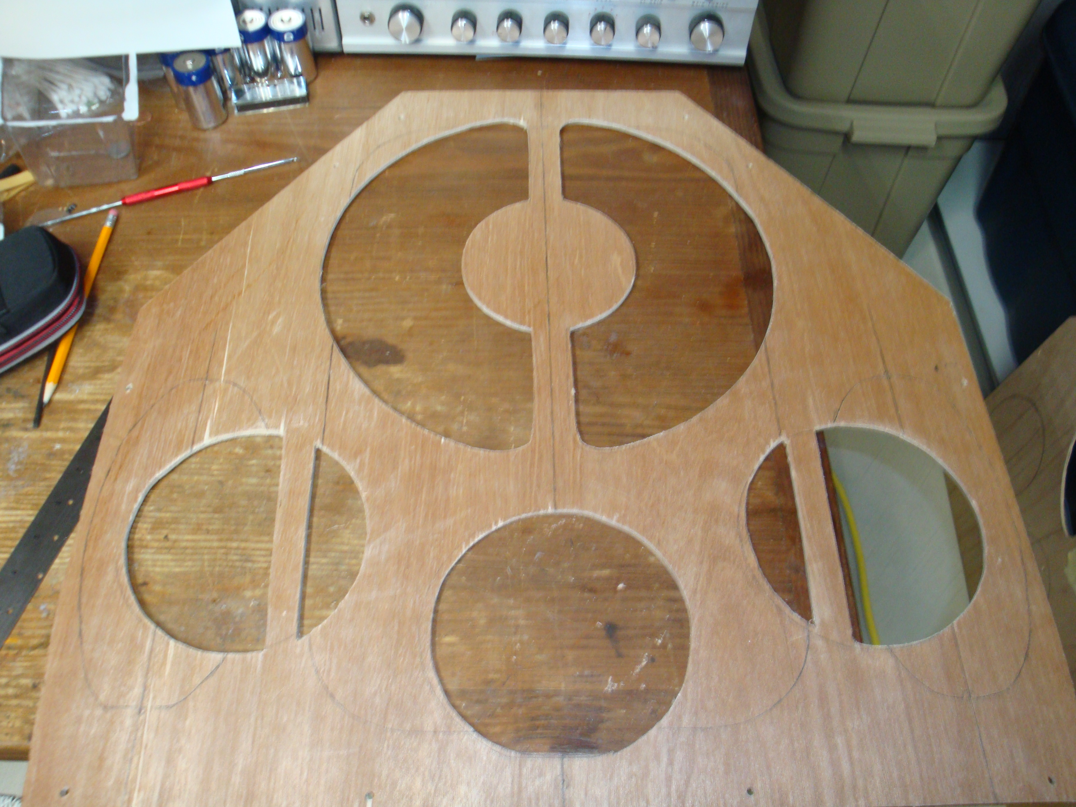

For what it's worth, I added a piece of thin plywood over top of the original board the grill cloth was glued to and bolted the lot to the cabinet.
I did this to bridge the gap over the two holes on the bottom left/right for the "acoustic clarifiers". There's no place to glue either the center piece of cloth or the side pieces. You can see from the outlines of the grill openings on the plywood. I'm not sure how others handled this. Maybe they're just more smarter that I am Icon_biggrin?
There it is, all 3 pieces glued into place.

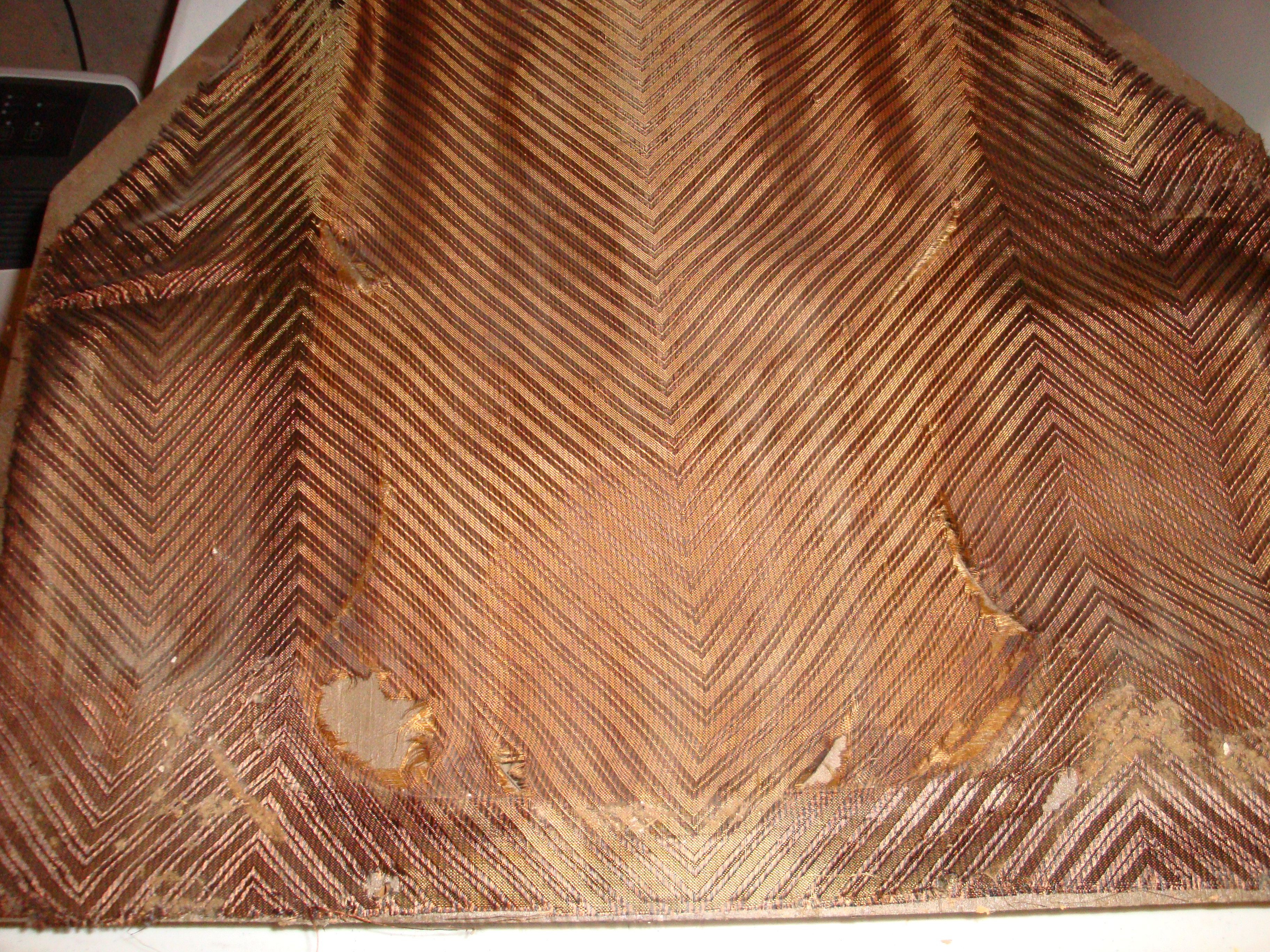

Here's a picture of the original grill cloth. You can see that it's wider and the chevron repeats on each side, centered over the right and left clarifier openings. A single piece of the original would span the entire board and could be tacked down along he edges.
You can see the outlines of the clarifier openings in the original cloth. The side chevrons are centered beneath the center grill bar of each clarifier opening.

Greg, I noticed on your original the right side V is going up where the left side is going down. Your new version they are both going down. I kind of like them going up. Not sure what I will end up with. I am about to do mine today.
Dan
The way I mounted the new cloth matches the look of the original, a V in each clarifier opening, not an inverted V.

Hello Greg,
your grille turned out really nice !!
