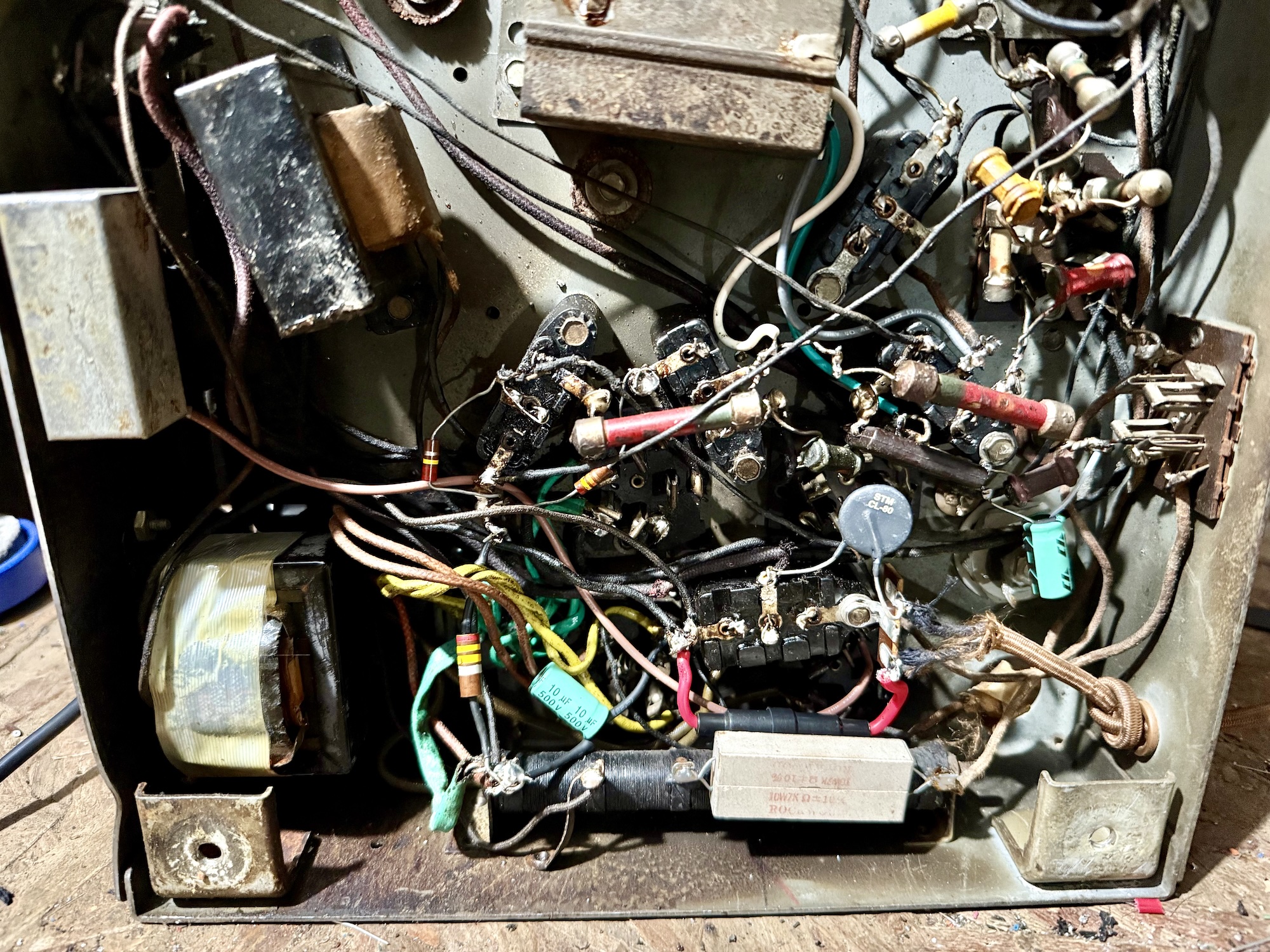

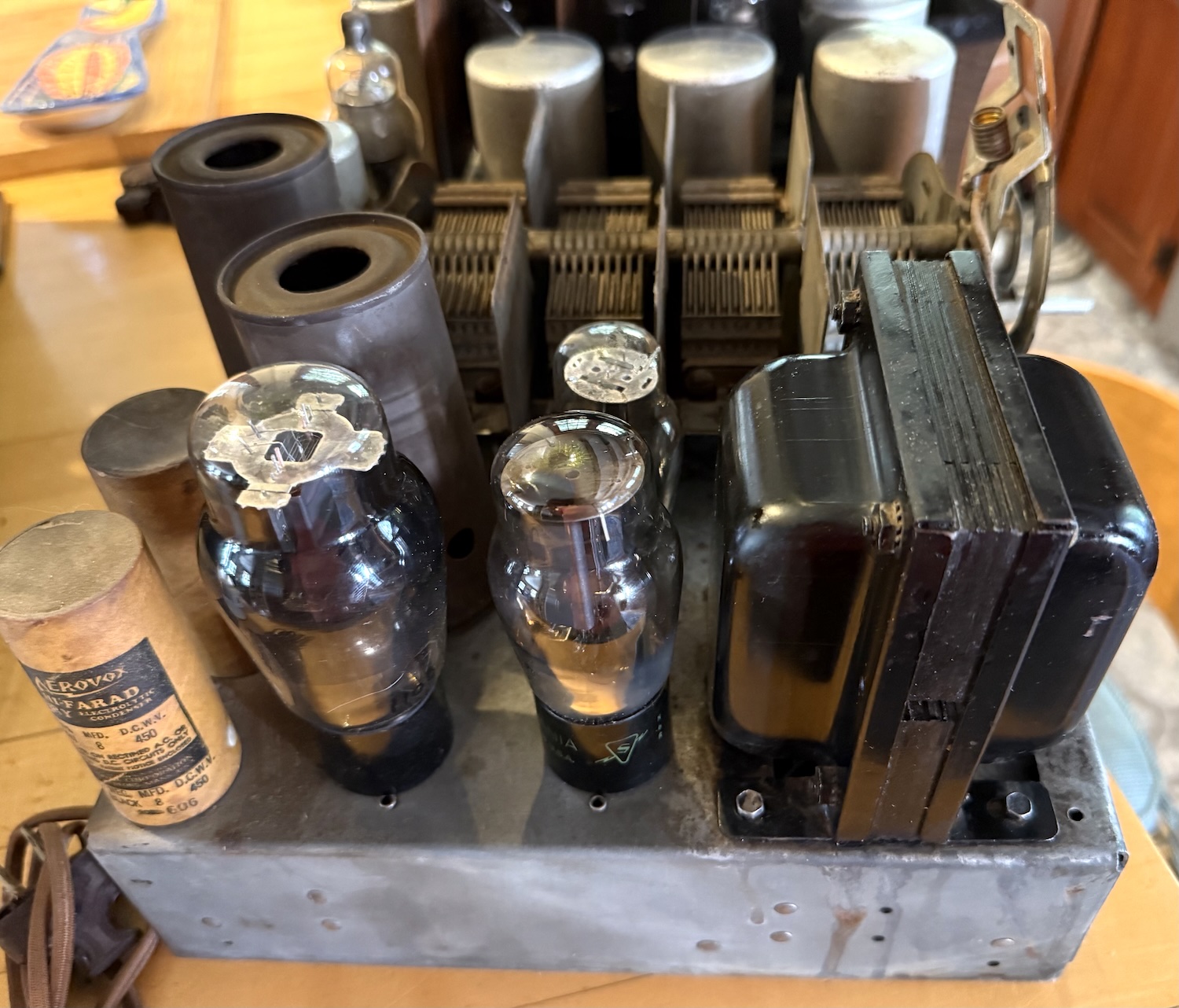

I decided to just jump in and go for it. I replaced all caps in the bakelite blocks, metal cans, and tone control. Found 2 open resistors (and a few others that read high that I'll eventually change). This was the power supply/audio section before:

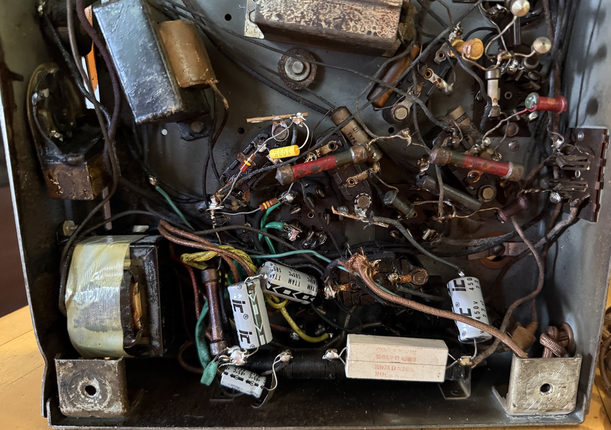

And now:
Wired new 10mf 500v electrolytics as per the schematic, added a fuse and a thermistor. Got most of the tar cleaned up with a heat gun, paper towels, and mineral spirits. It's a lot better on top, though underneath still has a fair bit of tar.

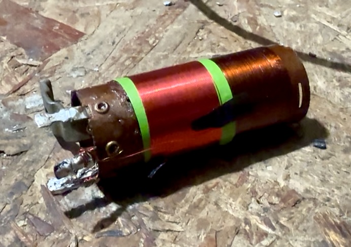

I managed to re-wind the coil. Didn't come out too badly. I removed the old winding along with the celluloid material, cleaned it with rubbing alcohol, and baked it in the oven at 200 for about 25 minutes. Then, I used green masking tape as an insulator, and I added roughly 100 turns of AWG 34 copper wire on it, and sprayed it with clear lacquer to protect it.
