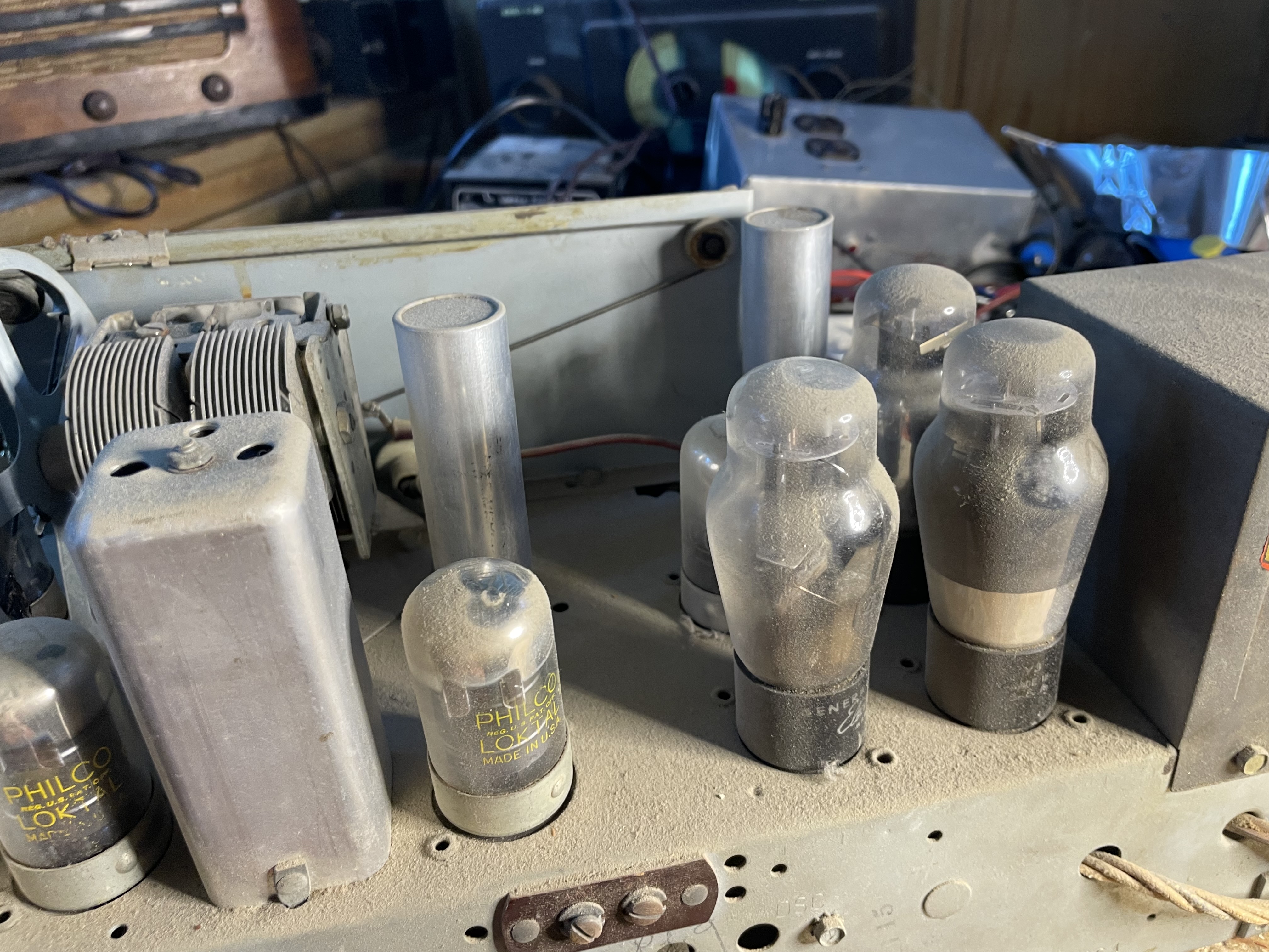

40-155 first look
Intact. Even the back is there in good shape.

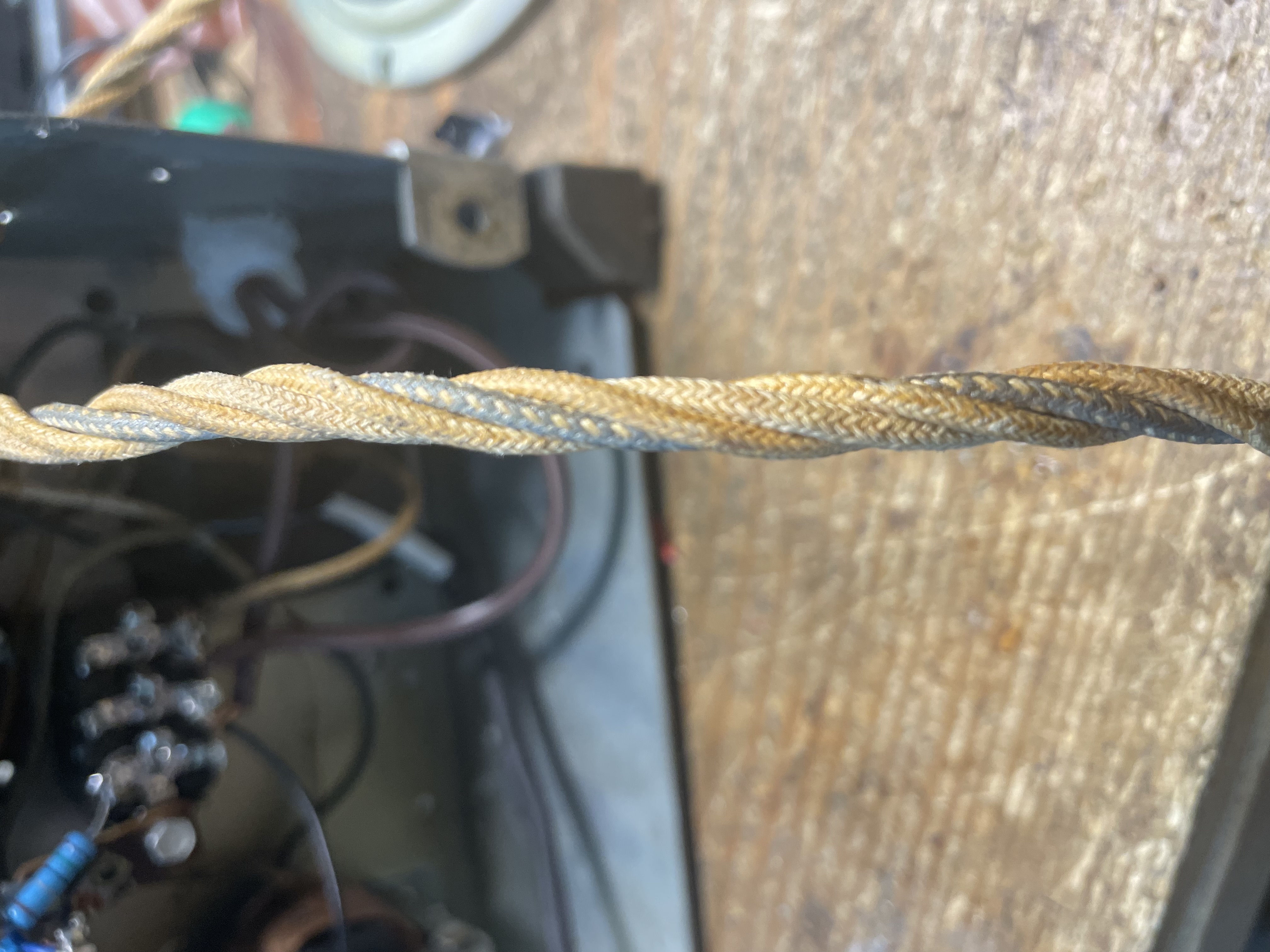

Replaced or heat shrinked some bad rubber wiring.

The wiring for the lamp has just crumbled to dust. I’ve ordered some nylon washers.

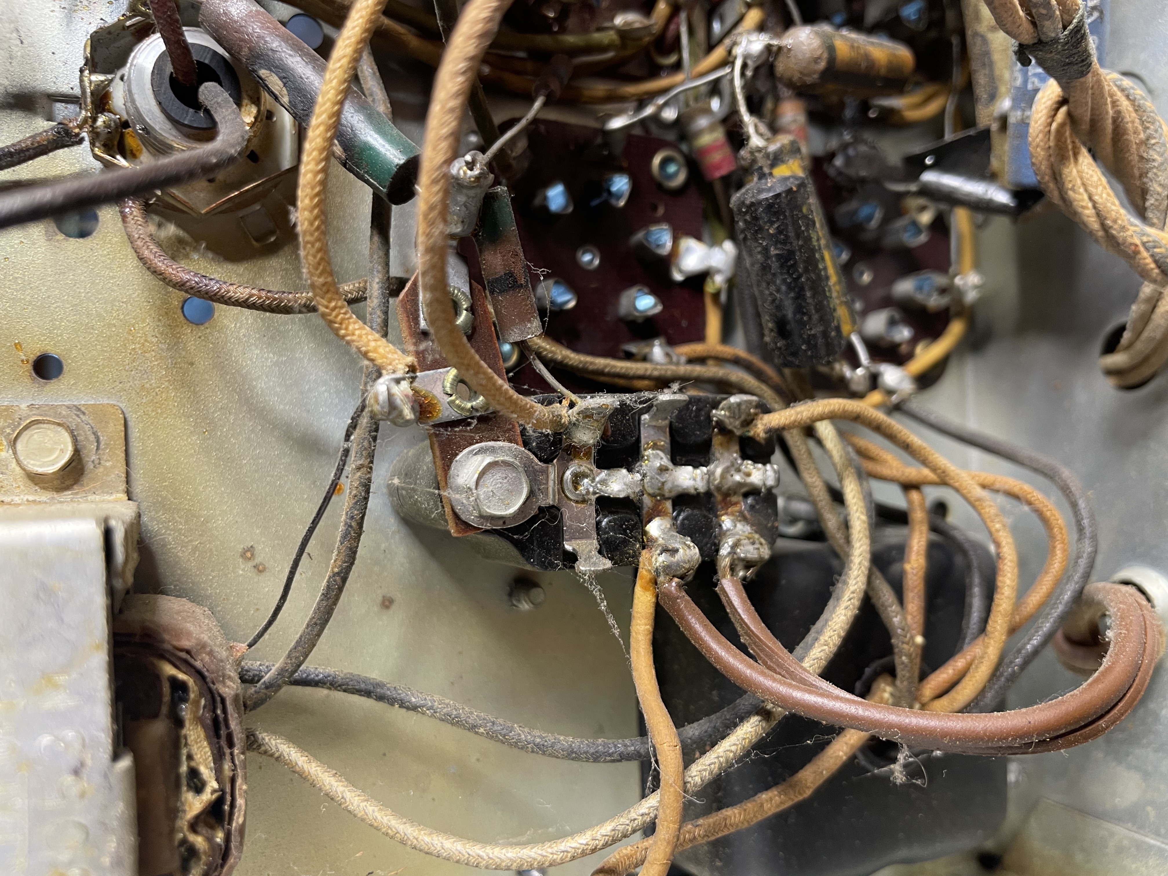

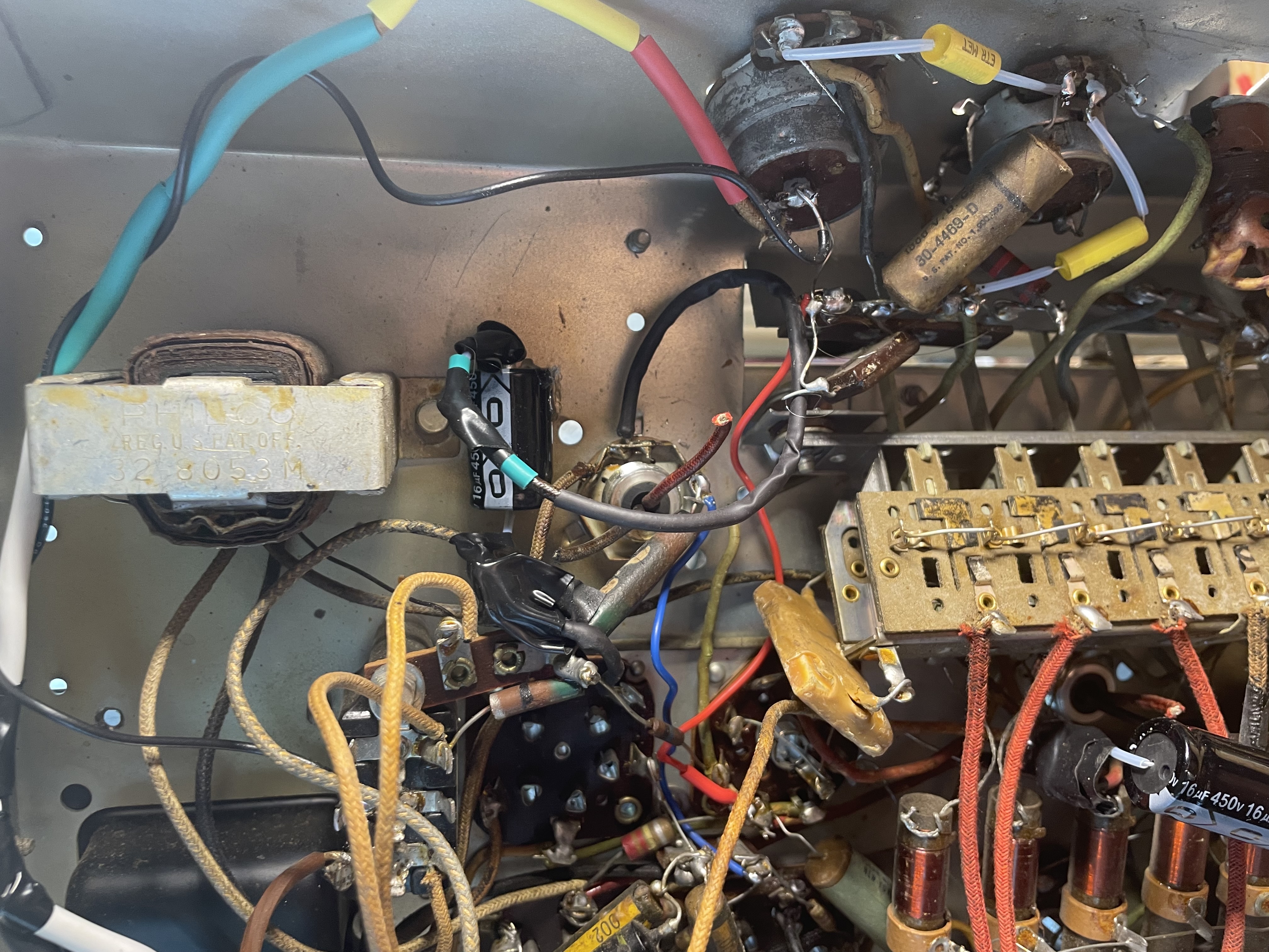

Looks like a dead short solder bridge on the Bakelite block, doesn’t it?
Oh. Let me look at that. Thanks. That one picture is old so I may have corrected that already.

What looks like a solder bridge may not be; verify that there is no solder bridge or other short. Looking at the green resistor soldered to the nut holding the capacitor #61, that resistor looks very burned and likely open. BTW, the case of that cap is NOT at ground potential; it should be insulated from the chassis. The case of Capacitor #58 should be at ground potential.
  • With the 84 out of the socket, set meter to ohms and measure resistance from the cathode of the 84 to the center tap of the power transformer.  There should be a relatively low resistance at start but the resistance should steadily climb to tens of kilohms as the filter caps charge.  If there is a short, fix it.  in addition, check the resistance of the filter choke and resistors 59 and 60 (I suspect that there is an open resistor here.  If any of these are open, there will be no B+ to the radio.  Resistors 59 and 60 complete the B+ circuit and grid bias voltages are developed across it.  Next, perform the following steps in sequence very carefully.

I think it is the angle of the photo, not a short.
That’s been totally reworked now. No shorts, no issues. Now I’m just waiting on some resistors so I can continue working on this. Helpfully I now have an untouched chassis side by side so that is making this easier.

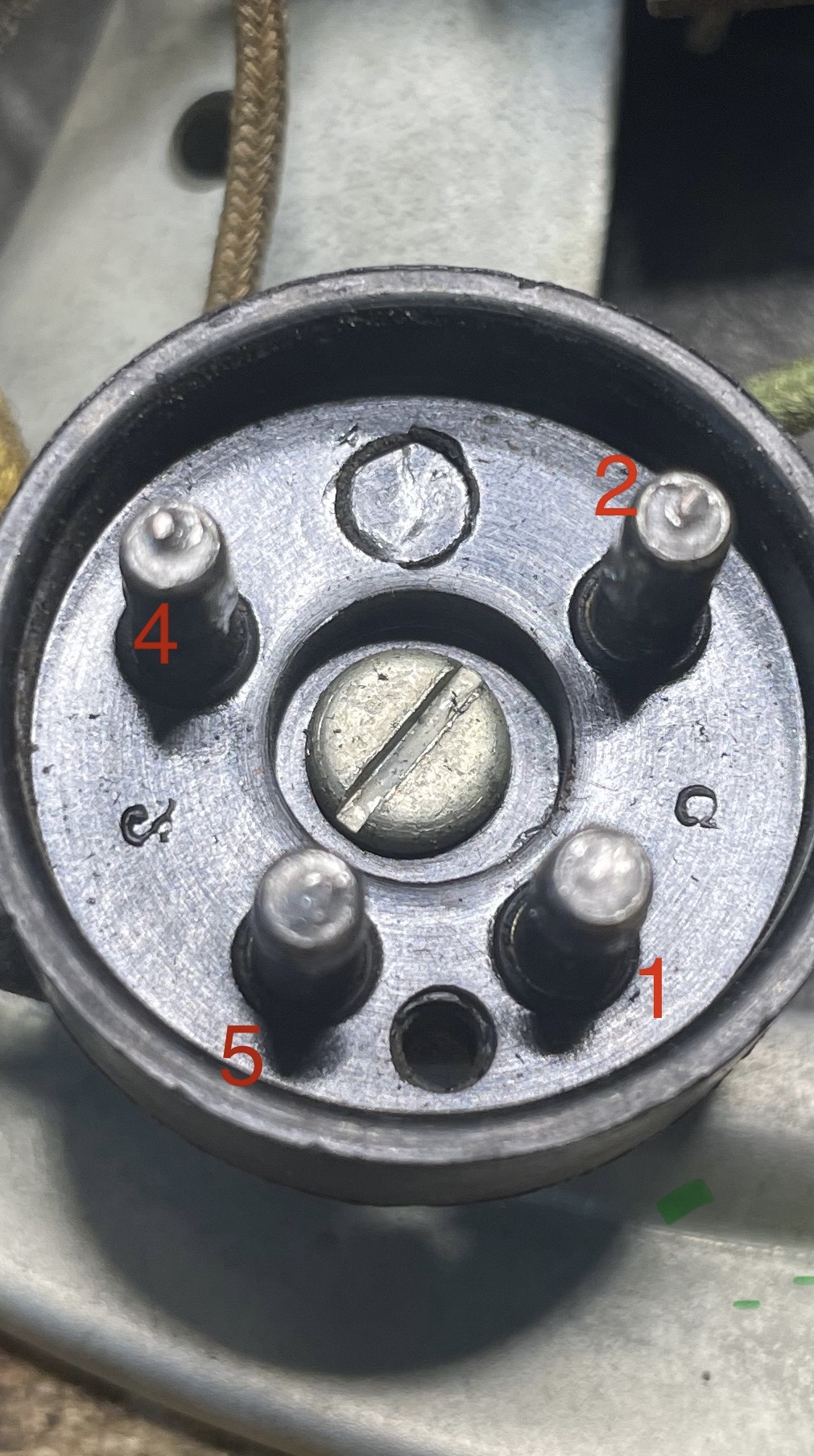

Another roadblock. I decided to check the wiring on the speaker and realized the four stranded wire from the speaker plug was bad as was the plug so I used the plug from my parts unit. The colors are so faded I can’t tell which one goes to the positive of the 16mfd cap. They all look yellow. I traced out the wires but can’t figure out that one. Then it’s easy because there are just two wires on the bakelite block.

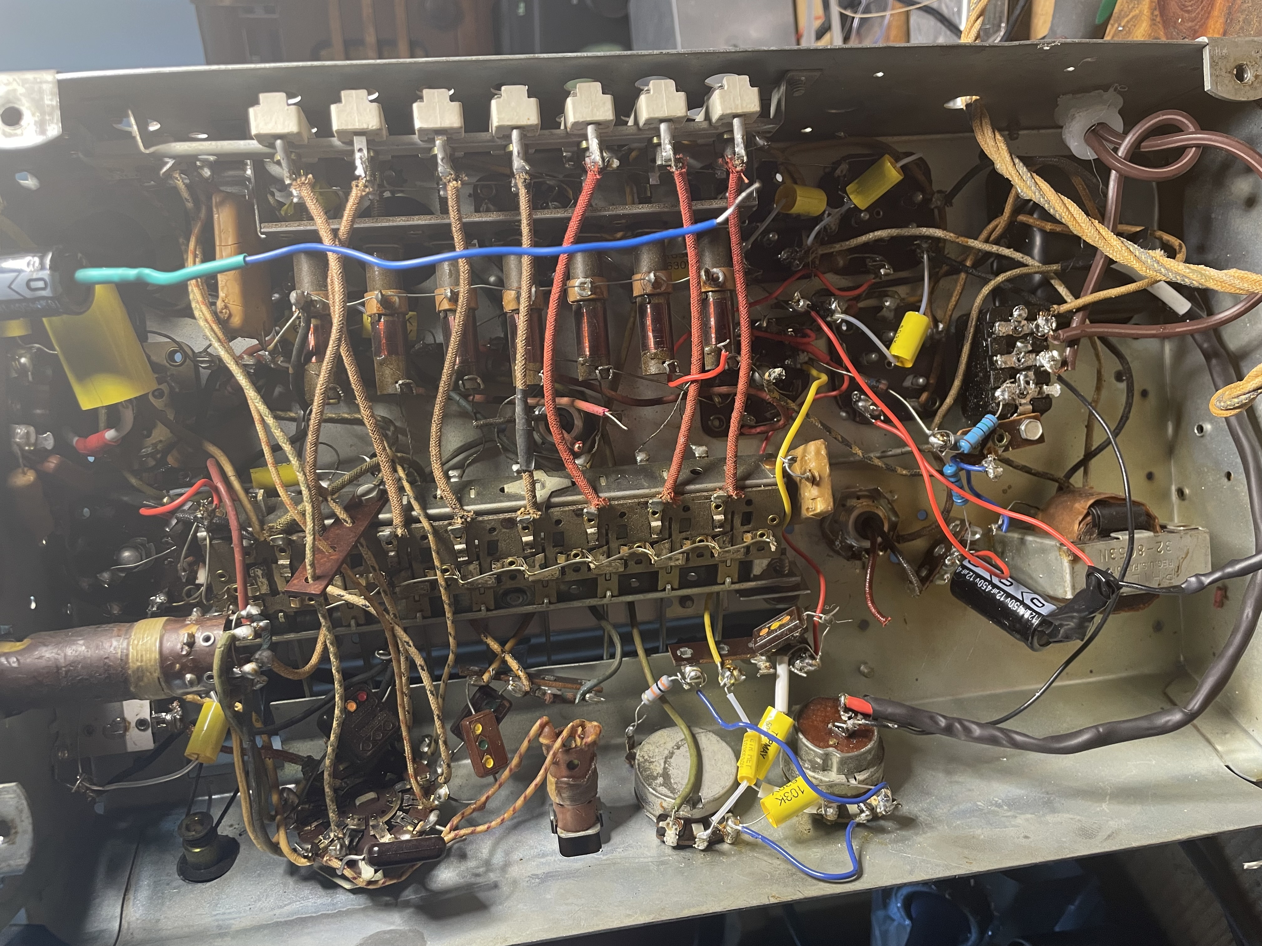

I’ve tried to neaten all this up. So some progress. 12 mfd by the audio transformer, 16 mfd connected to the chassis, replaced resistors (both burned) to terminal strip.
You can use an ohmmeter to measure the plug pins. Two of the pins should have about 1100 ohms; that's the power supply field coil across the filter caps (12 and 16 mfd). The other two pins are the output transformer primary wires and should measure about 450 ohms. If you trace the socket pins in the chassis, each of the field coil pins should run to the power supply 12 and 16 mfd caps. Each of the opt pins should run to an output tube plate pin.
