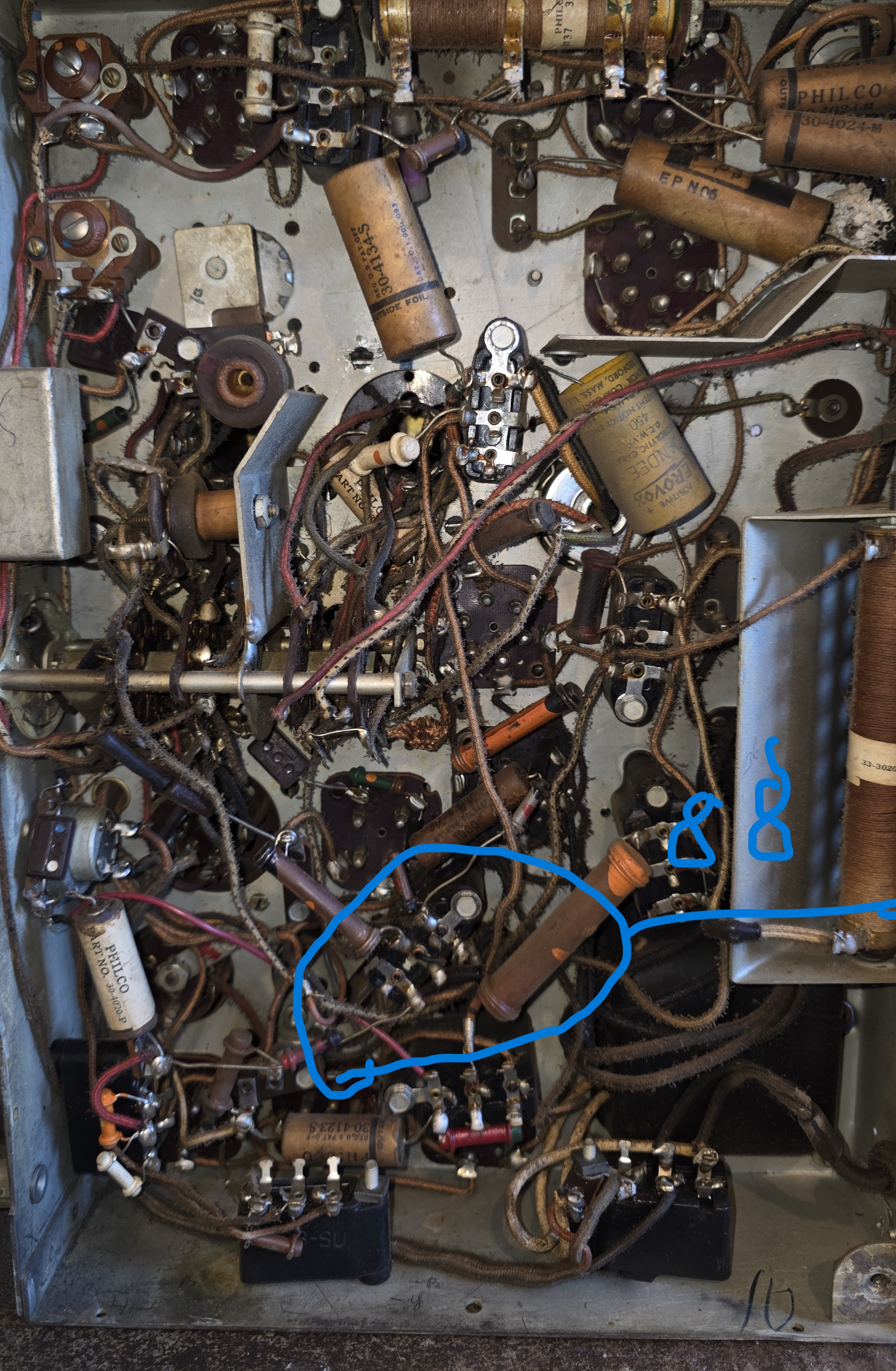

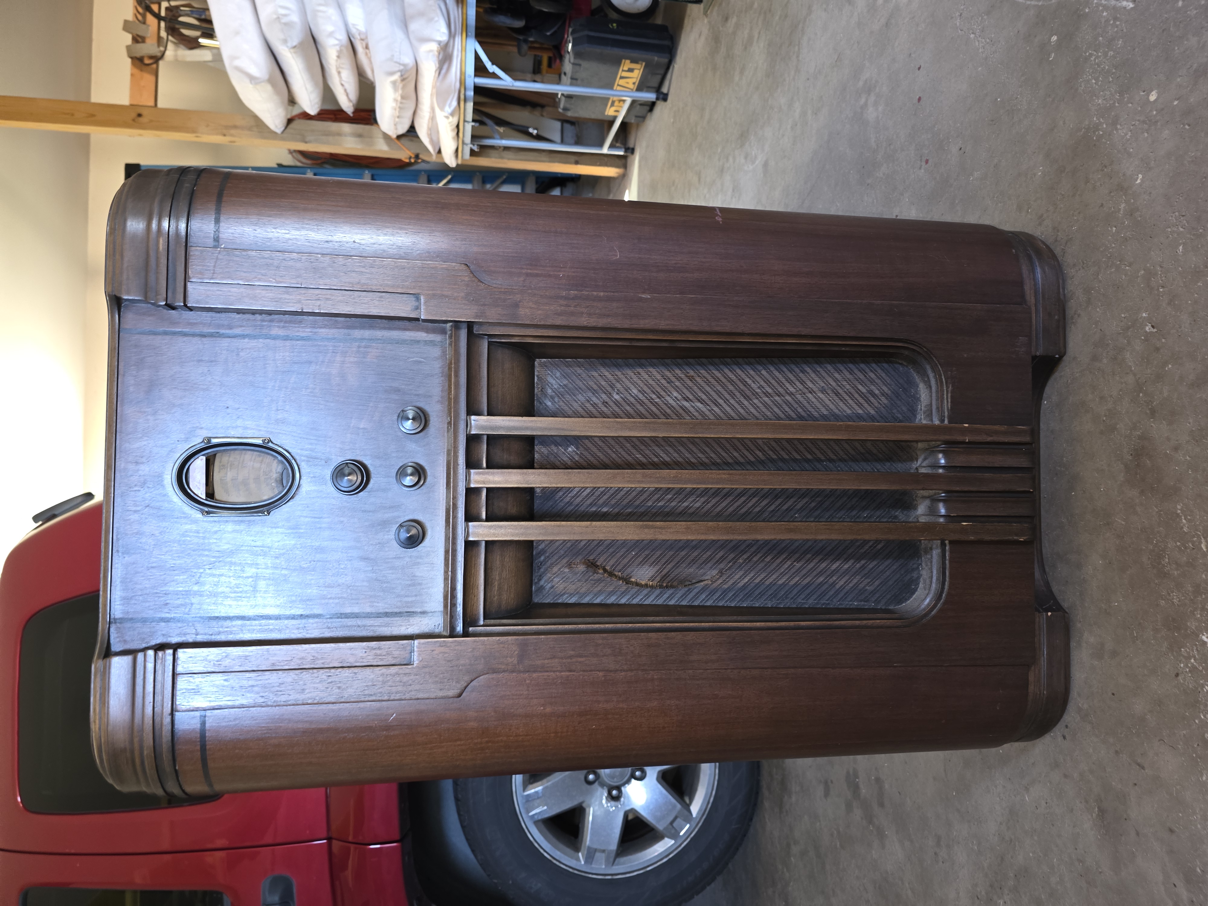

Restoring a 36 660X, I'm currently recapping and repairing prior work. Bakelite condenser 88 was partially unwired, made progress with schematic but was hoping someone with same chassis could take a detailed pic for me. Caps were replaced before and a IF transformer was replaced, found wiring issues all through out the chassis. Any help or sugestions are appreciated.

2 things that I see from your pictures:
You have questions about a Bakelite block that you have circled and described as #88. This is actually Block #43, a 0.05uF capacitor which acts as a "filter" for the AVC voltage. All looks good here. The center tab on block 43 is merely a terminal. there should be no internal connection unless someone disassembled and restuffed this block, adding the 1.0uF capacitor shown on the schematic if that black wire actually does pass through the rivet holding the middle terminal if the block in place. Capacitor block 88 is where the number 88 are written. Wiring here looks correct when compared to the schematic and the parts diagram.

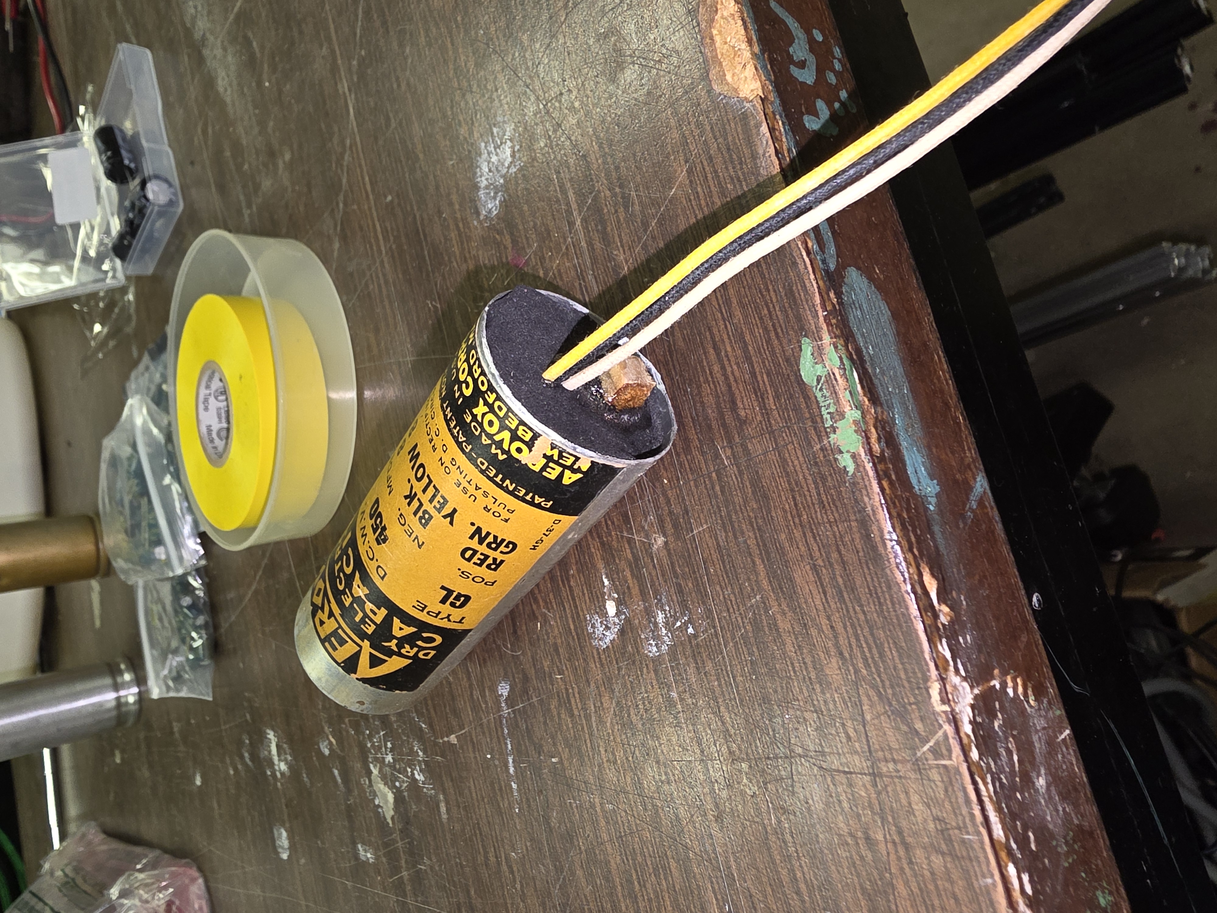

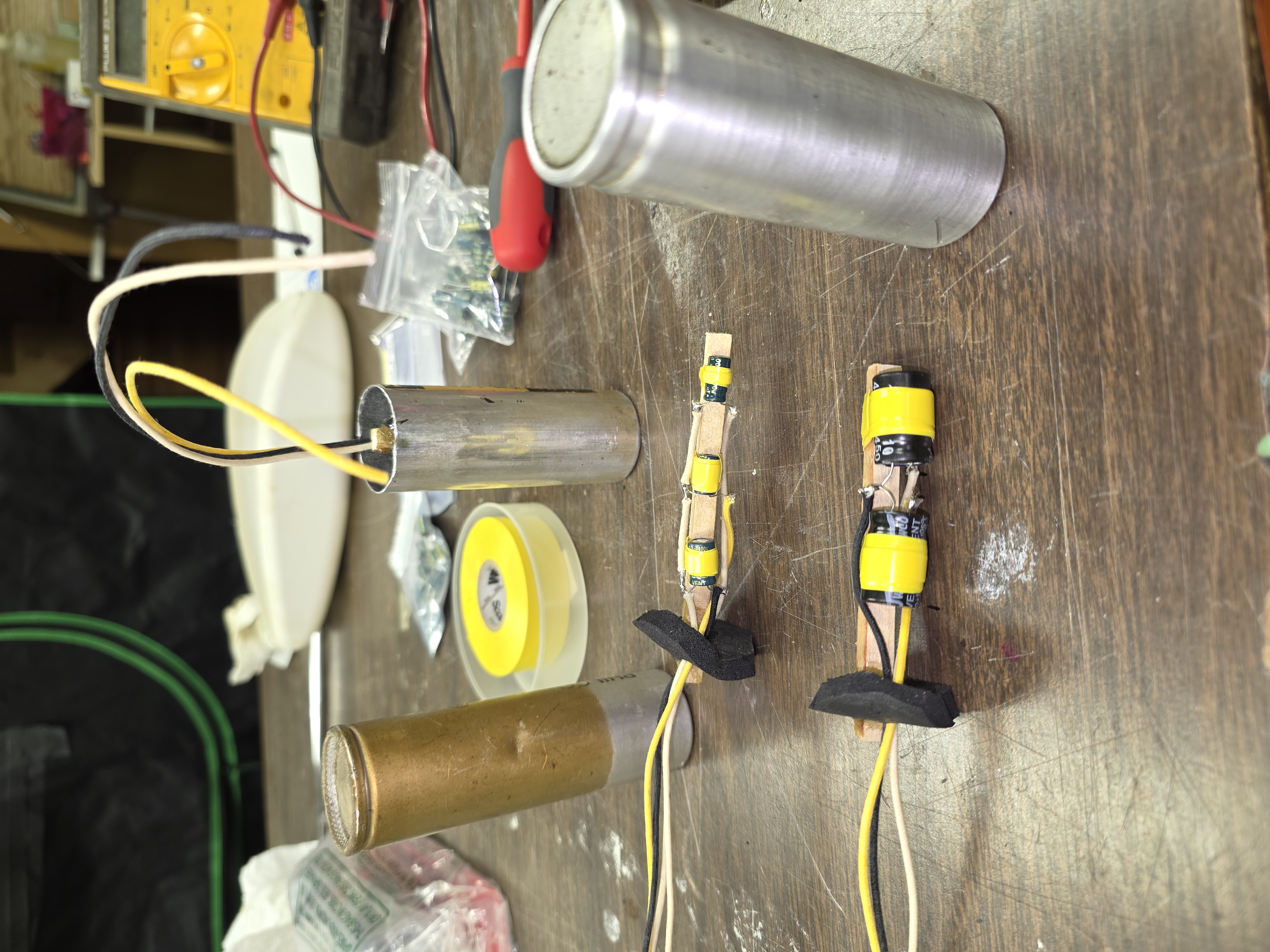

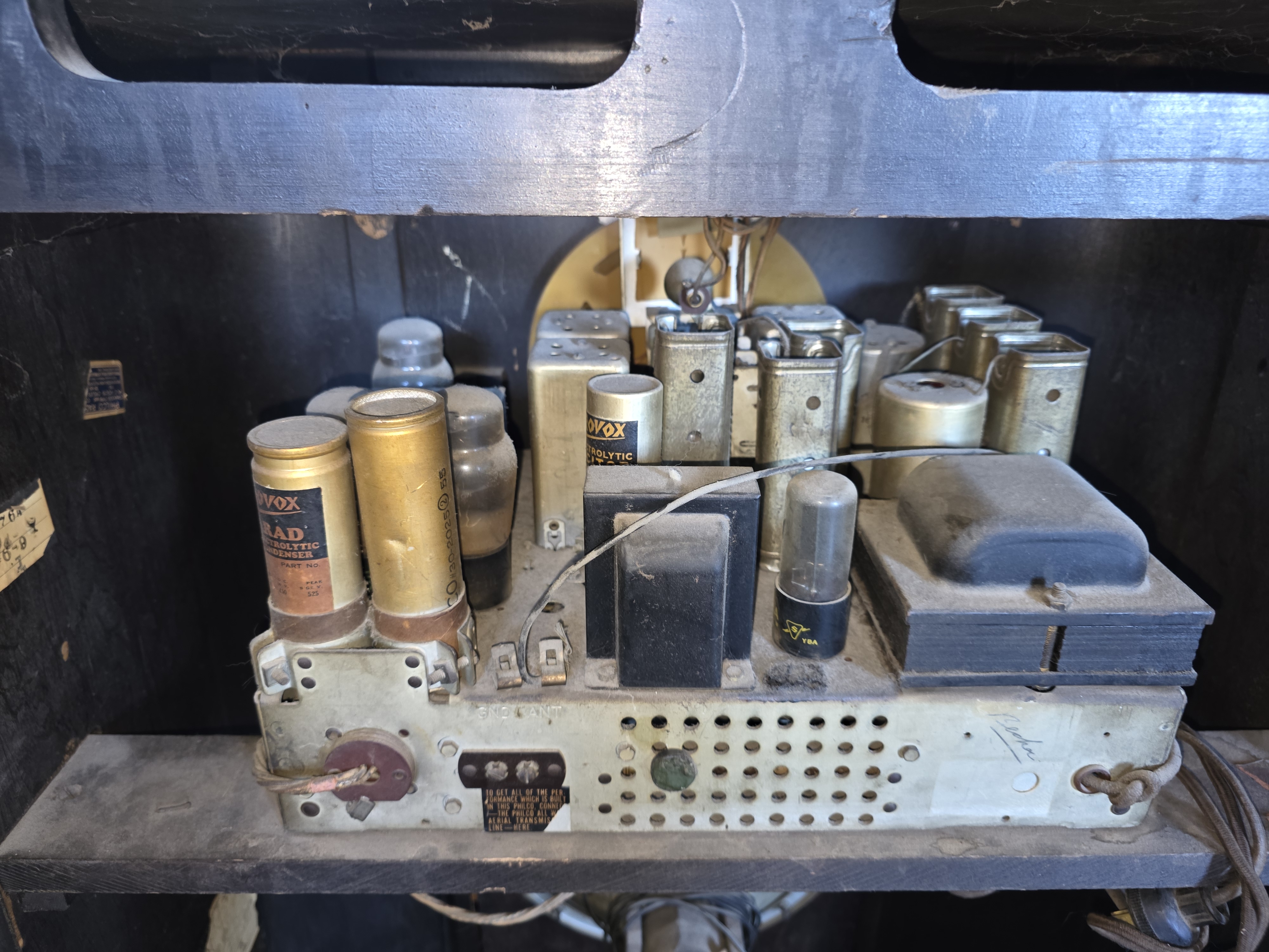

The second thing is your rebuilt (restuffed) Aerovox cap is supposed to have 4 leads, not 3. However, it was likely a replacement. Please ensure that when replacing the filter caps, that cap #86 was a 10 uF and 8 uF cap in the same can, but not with a common ground. Replacing with 2 10 uF caps is fine, but please note that the negative leads of the 2 caps in #86 go to 2 different places. One goes to the center tap of the HV secondary. The other one goes to chassis ground. This is important because the HV secondary center tap is not grounded to chassis like it would be on post WWII radios. Chassis ground is essentially
B- / C+ on these sets whereas the HV secondary center tap serves as C-. If you are packaging differently so that one half of cap #86 and cap # 87 are in one can sharing the same negative, connected th the HV secondary center tap and the other cap in #86 is separate and connected between Chassis ground and the HV secondary center tap. Please note the polarity. For this particular cap, the + terminal goes to chassis ground and the - terminal goes to the HV secondary center tap. This is because the center tap is more negative than the chassis ground.
Hope this helps.

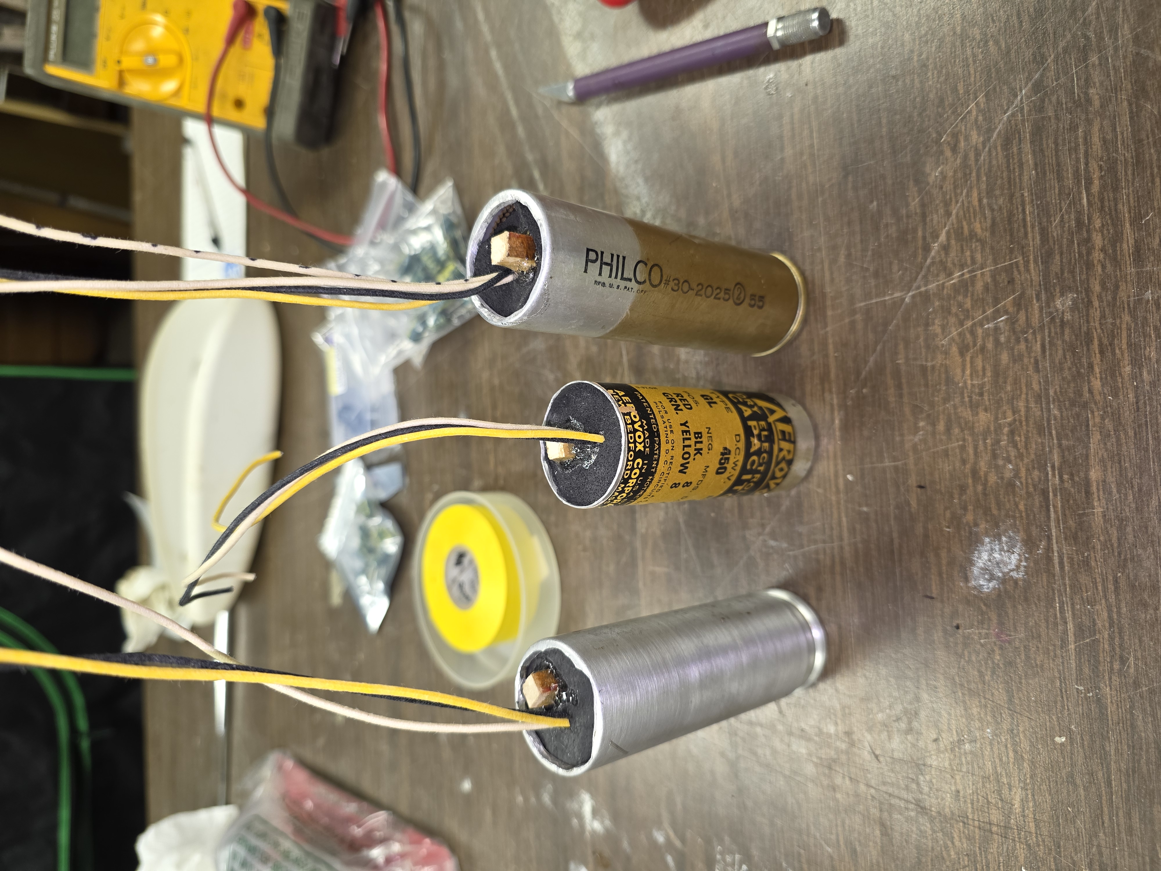

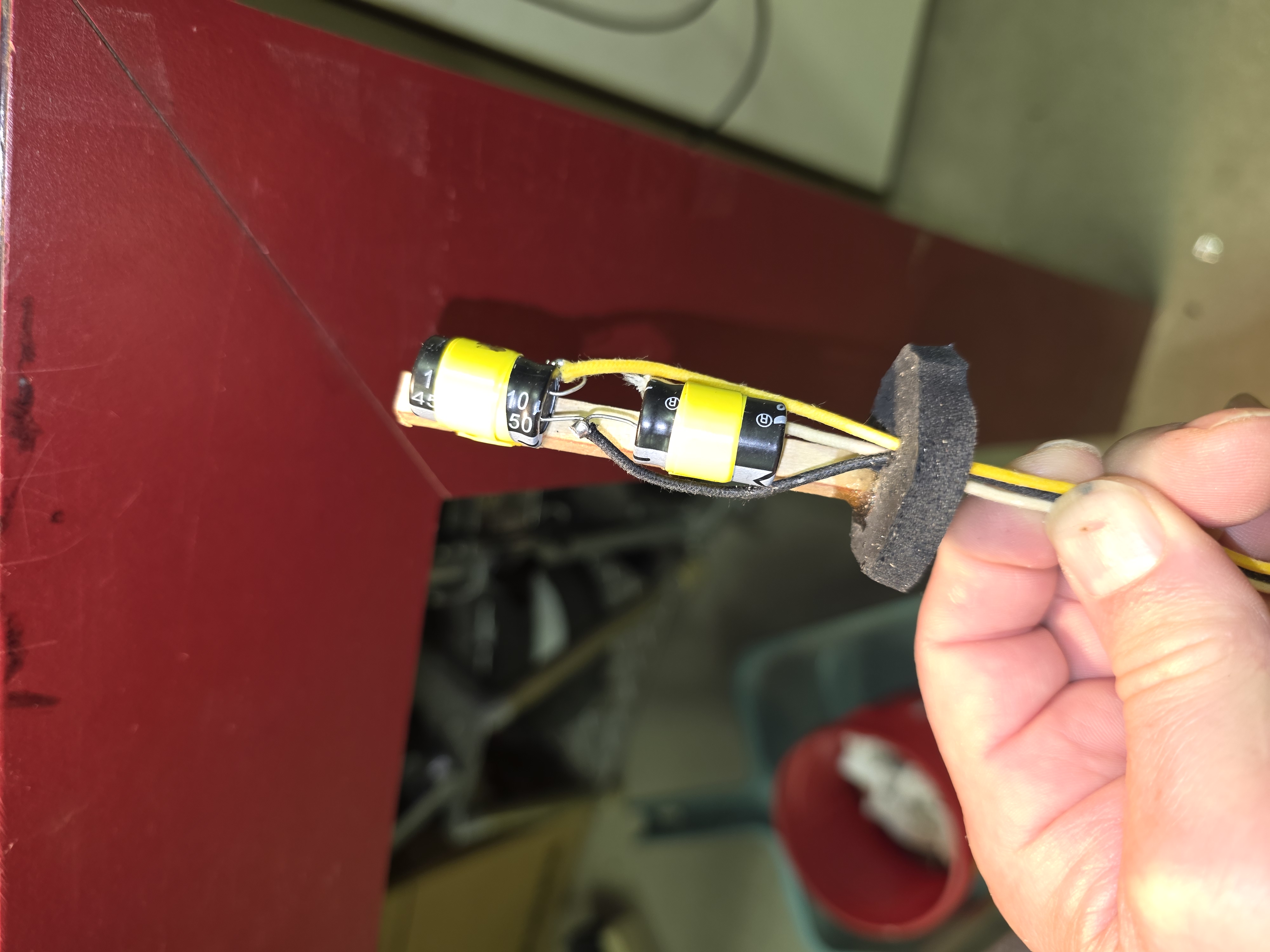

One not. Not really worrisome but...I see you used a piece of wood or wood-based material as the prop to stiffen the caps inside the can.
In one of them the soldered wire seems to touch that wood or pretty close to it.
Thing is, wood is hygroscopic, so is not the best material to be used as an electrical insulator, unless properly treated (and I am not sure what that treatment would be).
This said, you do not necessarily need a stiffener to stuff the caps. The radios are not subjects to vibration, they stay on the floor or a table.
Personally, I simply stack the caps up and wrap it in a couple of layers of fish paper to insulate from the inside of the aluminum can. This provides the insulation and some decent support (no, you should not shake it violently).
Just a thought.
