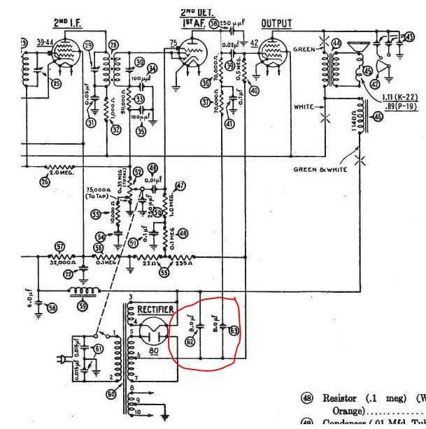

Hello,
Are e-caps #62 and #63 supposed to be in parallel? I'm thinking thre must be a dot missing where #59 and #63 cross otherwise how else would the 75 tube get its plate voltage?
Dan
No. I think, the #63 is missin the tie-dot to the other side of the field coil (marked "white").
Missing tiedots of the second cap are a popular Philco docs error.
Thanks Mike. I have added the missing dot to my schematic. The radio is now playing quite nicely. All I need to do now is get a new grille cloth and put the chassis back in the cabinet.

Dan, the AVC is generally sourced from the detector. So, if you look at the diagram above for the detector diode connected to the second IF secondary winding then down to the volume control there's a 2 meg resistor (#26) going to the left that feeds the signal grids of the IF and RF tubes. That's the AVC, which will be a negative 2-3 volts with low or no signal input and up to 10-15 volts when a station is tuned in. At the top of the volume control where the 2 meg resistor connects you should see this voltage vary with the strength of the rf signal. If you measure the other side of the resistor the meter will load the circuit and give you a false reading.
Rod, I follow you up to where you say the 2 meg connects to the left IFs and RF tubes screen grids. I don't see that connection. The 2 meg connects to the secondary of IF 1 and IF 2. Am I reading this wrong or is there another tiedot missing somewhere? I measure -.5 off station to -6 on station. Never goes positive. Using a DMM, negative connected to ground and positive at junction of 2 meg and volume.
Dan
The AVC should always be a negative voltage. It is fed through the 2 meg resistor to the signal grids of the IF and RF tubes (the grid caps) not the screen grids. The stronger the received signal the more negative the AVC voltage thus reducing the gain in the tubes, automatically. Your AVC seems to be acting normal.
I see now. I was thinking when you said 10-15 volts you were saying positive 10-15 volts. I seem to always get signal grid and screen grid mixed up. Thank you.

Power supply filter caps for the 80 rectifier can be increased considerably when not using a filter choke. If you experiment with 22mfd caps and temporarily connect them across the installed ones you might be able to cut the hum. Indeed, this is the circuit to use until the correct choke comes along. Buying a new choke will be very expensive(copper). I will check my stash for one that is close. If the rectifier tube was one with a cathode the tube specs would tell you the maximum capacitance for the input filter cap. If you have a voltage chart you can also experiment with the 200 ohm resistor to get the correct B+.
Edit: I don't have the choke you need.
I would add that increasing the caps' values is possible but should only be done to the cap after the choke / field coil.
Significantly increasing the value of the cap right after the rectifier will increase B+ voltage and, at least, will decrease unnecessarily the tubes' useful life as they will run hotter (the power increases linearly vs the voltage as the tubes act as current sources and not passive resistances; still in crease is increase and should be avoided if not needed).
After the choke/FC increasing caps does work well and causes no increase in B+.
I increased the cap after the choke but since there is no choke now, replaced with 2K resistor, is this the same as increasing right after the rectifier?
No, first filter cap is right after the rectifier. Increasing the cap after the choke is the second filter cap or cap after the filter resistor (it's 2k now).
Caps that can be increased are the 58 and 63.
