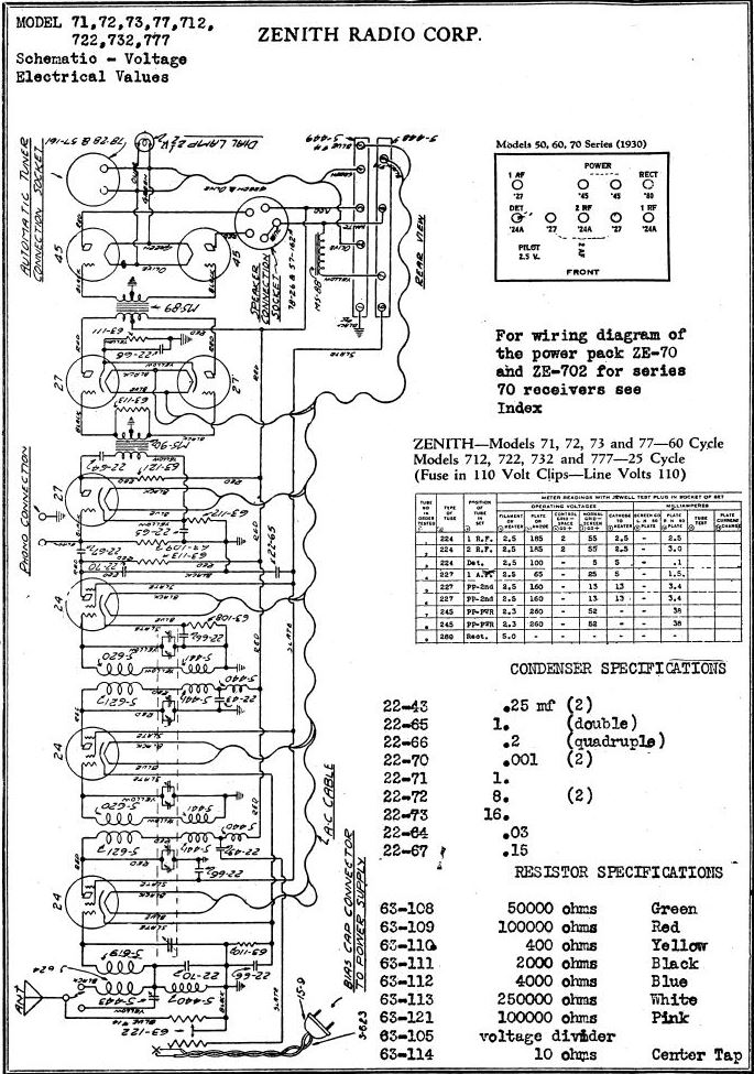

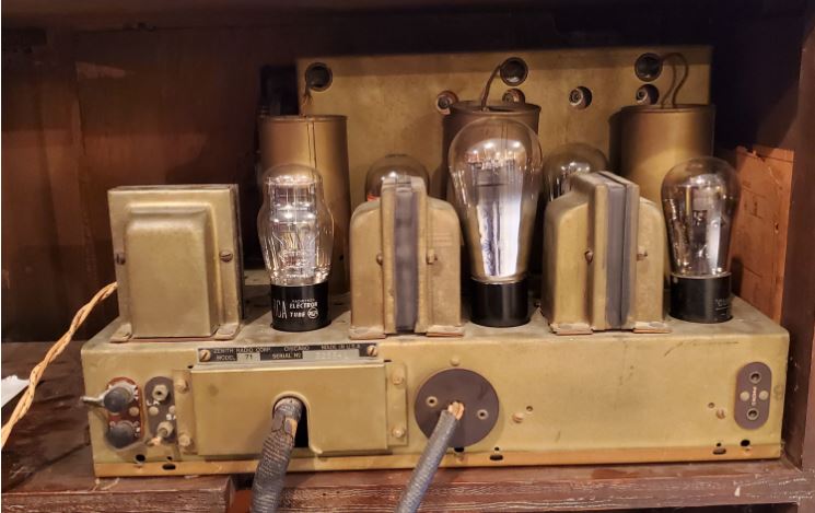

I have been asked to restore this radio which is in great shape. Has anyone worked on one of these and if so anything I should be aware of. I don't know if it has been recapped or not yet but the owner has been playing with it. He says he can't turn the volume down.
That schematic scares me. Thinking I might have bit off more than I want to chew. Guy is already asking how I am doing with it. He dropped it off 3 days ago.

Typical Zenith drafting style; otherwise no more complex than any radio for the period.

Neat radio. Shame that only 1 of the 45s is a globe tube, the other is the "ST" style. This is a relatively high end TRF (Tuned Radio Frequency) set.
The volume control on this set is quite interesting. It is at the very beginning of the circuit and consists of 2 functions.
The first function is to "shunt" the antenna to ground at minimum setting. The resistance element is connected to the antenna and the wiper is connected to ground. This is a common method of regulating volume in sets before AVC (Automatic Volume Control). The second function is to bias the RF amps. The lower the volume, the more the bias. However, Zenith did not vary the cathode bias to regulate volume. It seems that they vary the resistance to one leg of a capacitor whose other leg connects to an RF coil in the plate circuit. I assume that the closer that one lead of the capacitor is to ground, the more filtering of RF from the plate circuit of the first RF (and conversely the lower the signal to the grid circuit of the succeeding RF amp and detector).
Servicing the set should be rather easy. Verify that the coils are not shorted or open. Verify both sections of the volume control. Replace the caps, and you should be good to go.
Because this is a Non-AVC set, there is some strangeness to volume. First off, if the volume control is set rather high for a distant station, and you tune to a strong local station, the RF amp may become saturated, and you may stop hearing stations. Just turn the volume to minimum for a few seconds and slowly raise volume. Some stations may be so strong that they will be picked up by the wiring between the tuning cap and the grids of the RF amp tubes. Make sure that all shields are in place.

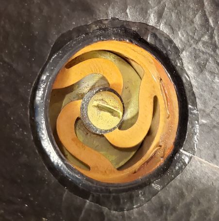

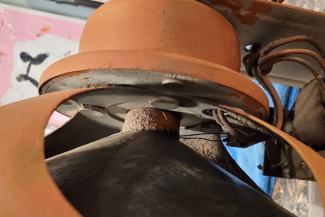

The speaker is shot. The cone is very stiff and it does not move back and forth. Someone has put tape all around the perimeter of the cone and painted it with something maybe hard glue. Probably would sound ok at low volume.

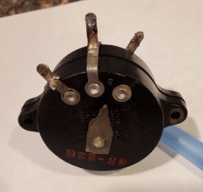

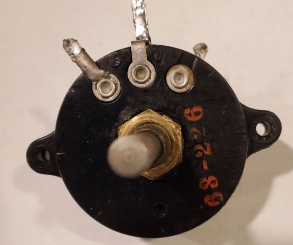

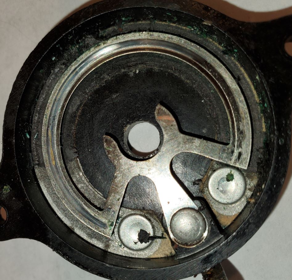

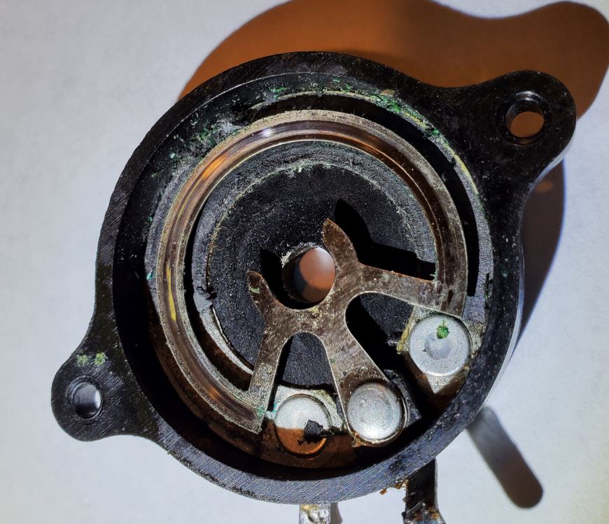

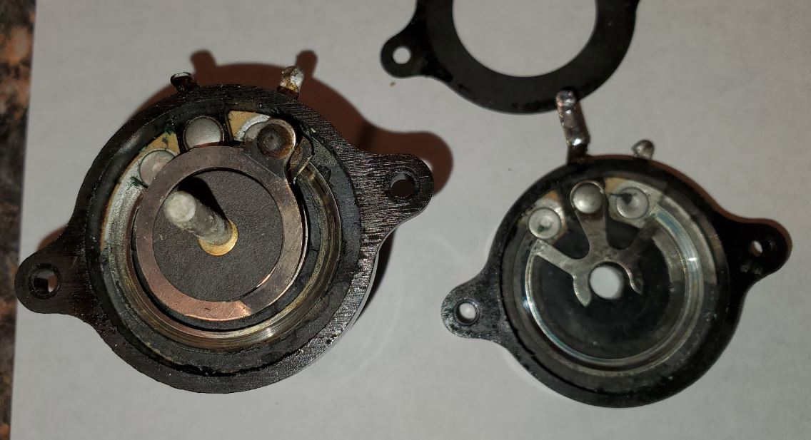

Checked the volume control today and got very erratic readings. Took it apart and found the carbon track just about gone on both paths. Can't get much of any kind of readings off it with a VTVM. Anyone have any idea if this can be repaired or replaced? The part number 68-226.

For now, regarding the volume control, you can use a 10K pot across the antenna terminals, either externally, or in place of the existing volume control. I'm a little surprised that it is a carbon type potentiometer, most of the volume controls of this type and vintage were wire wound.
Regarding the speaker, there were several iterations of the original dynamic loudspeakers, developed by GE engineers Rice and Kellogg. The first iteration had very little movement. The voice coil was centered in the field electromagnet by a dish-like metal device, cemented to the voice coil and screwed to the electromagnet pole. This certainly did not allow for much movement. The second iteration was known as the "spider", a device that looked like the insert used to play 45RPM records on a turntable. This device allowed much more movement of the cone but held it centered so it would not rub against the magnet pole, causing distortion. However, this device was rather flimsy. The third iteration was an external version of the spider, kind of a "leaf spring-like iteration. Finally, a corrugated external ring was used to center the voice coil and continues to this day.
I have repaired 2 Philco 20s and have two of my own. The ones I repaired had the first iteration with the hard centering device. One of mine had the 45RPM type spider; the other has a modern replacement speaker. My two sound quite similar. The two that I repaired having the "hard" device are loud but quite tinny sounding.
There are several companies / individuals who re-cone speakers. Ig you want to keep the radio original but improv ed, have the speaker repaired or re-coned using the more modern spiders.

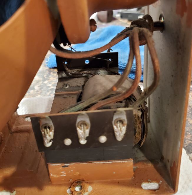

Arran, I too thought 1.3K sounded high for one side but I am not 100% sure I am reading the full primary or one half. If I look at the transformer I can see I am reading one half based on the center wire going into the transformer is really the center tap. I am reading right on the transformer terminals. See picture of output transformer. I get about the same reading if I go through the speaker plug. Readings are while speaker is disconnected from the radio.
MrFixr55, I have included pictures of the pot. Although they are not the best pictures you can see the carbon tracks are pretty beat up. Please go into more detail about how I can use a 10K pot across the antenna. Like how would I wire that up and what would I do with the other winding?
As for the speaker you can see from the pictures it is using the 45 record type spider. What are those staples doing in there if that is what they are? If I get the speaker reconed I still need to deal with the output transformer. If I get the recone job it would be silly to leave the transformer as is.
