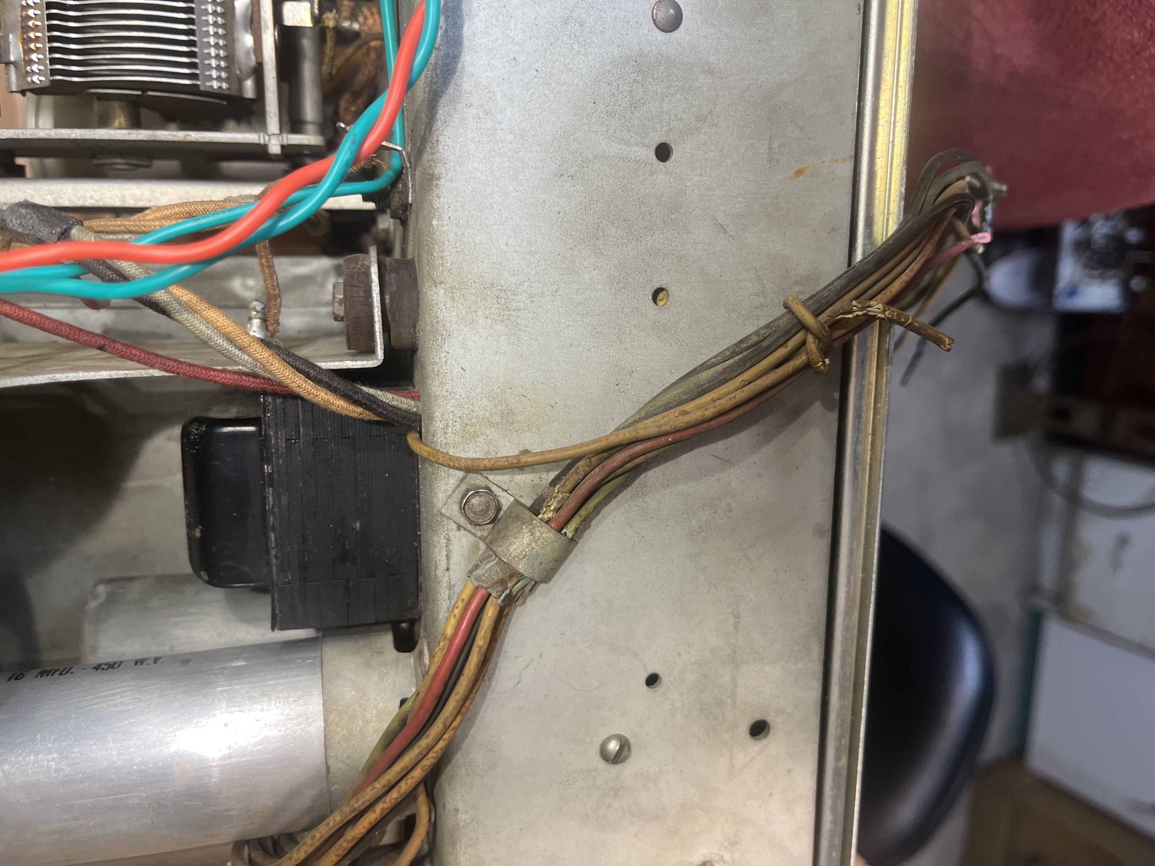

I am working on replacing the rubber wires for the station indicator lamps, and I have a tan-ish coloured wire that runs out of the chassis in the same location as the wires for the dial lamps. But the wire has been cut and tied around the indicator lamp harness. I was able to trace the wire back to the band switch.
Where is this wire supposed to connect?
I tried looking at pictures of other chassis, but none show a close up of that area.

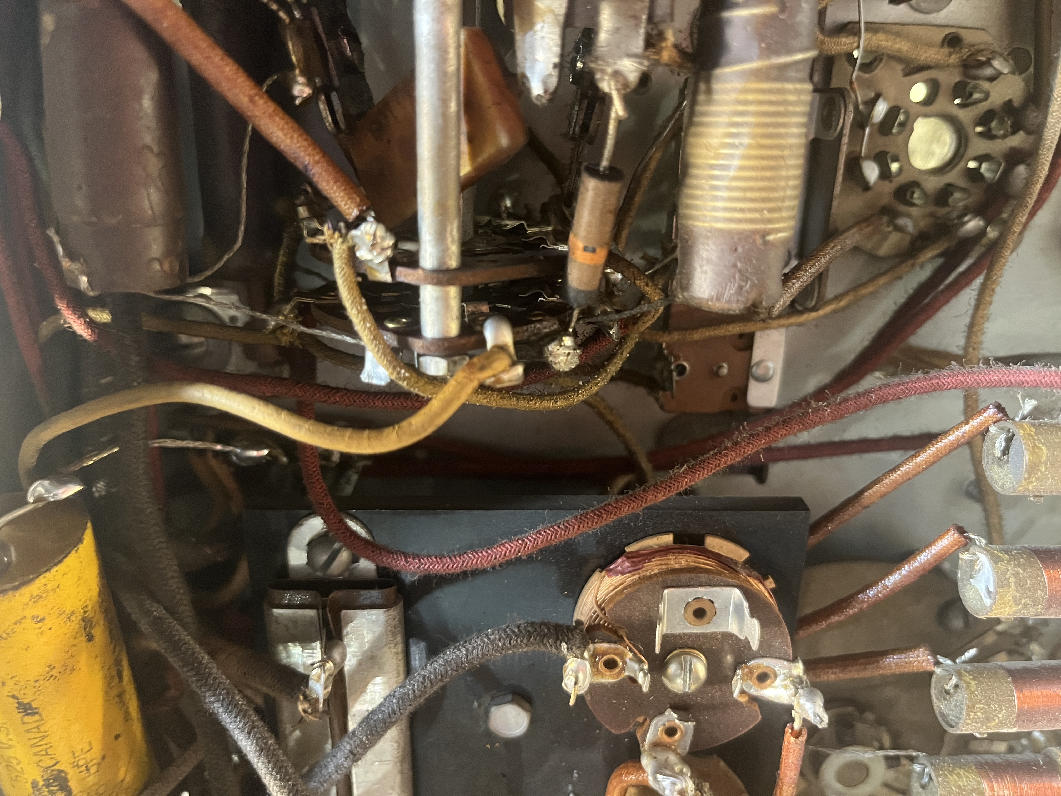

It appears to me that the wire is attached to A1 of the bandswitch which has 6.3 volts on it for the lamps. Maybe it is for an external lamp somewhere else on the chassis. Can you determine if that switch wafer is wafer A or is it wafer D? That looks like a 10k resistor next to the wire but I can't find a 10k connecting to the bandswitch.

Based on your picture, and the schematic for the 39-116, available on our Philco Library picture, if the wafer shown is "A", then I think that the wire connects to A1 of the A wafer of the band switch.  If the device on the next terminal is a resistor of low resistance, say 10 Ohm and if that terminal is A3, then the resistor is fed by the 6V filament winding of the power transformer, and when the band switch is in the "preset" position, and supplies this wire, a common power feed to a series of indicator lights indicating what station is selected by the Mystery Control stepper when the preset function is selected by the band switch. The desired light is selected by one of the stepper switch wafers, #81 on the schematic #81 is a compound stepper switch which selects the oscillator coil, antenna capacitor and indicator light.
If these indicator lights are missing, this may be the reason for the wire being tied back to the harness for what is apparently the speaker.  If these indicator lights are missing, then you can merely cut the wire; it will not affect general operation of the radio.

Thanks for the diagnostic help. Yes, the wire IS for the power for the preset station selector lights. Someone has snipped it off, and rerouted it through the chassis, bringing the wire out the top by the dial where the lamp wires come out. That's what confused me! Why didn't they just disconnect it under the chassis? The wire covering to the lamps is severely degraded, and so I assume that something shorted out, hence being disconnected. But by disconnecting and re-routing it the way they did...the wire was still live! And the covering on it isn't any better than the lamp wire.
