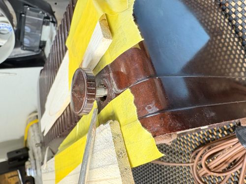

The Arvin 552N that I just picked up had a stuck knob which I was eventually able to get off. I first tried the rubber glove technique seen in this youTube video by RestoreOldRadios https://www.youtube.com/watch?v=GUUJDrS3V4g and after that failed, I used the two pry technique seen in a number of videos on youTube. Some folks use two spoons, some fashion "L" shaped pry bars. I used two thin screw drivers and some wood as a fulcrum (and to protect the radio). The key is to get the screw driver right up to the metal shaft of the radio and under the plastic or bakelite base of the knob. If you pry on the outer edges of the knob it will surely damage the knob. Here's a photo of the set up, although its after the knob was off and I could only put one screw driver in place while I photographed. Its important to use both screw drivers and lift both sides of the base at the same time. Now hopefully I can find a second knob.
Bob;
I was going to suggest that if you have a stuck knob that squirting some penetrating oil, like WD40, on the shaft, and allowing it to soak in sometimes helps. I had an Eaton's "Viking" radio (Electrohome) that had the same problem, also stuck on a spline shaft, and my late uncle suggested that. What I did after was to wrap a string or cord behind the knob, and kept wrapping it around until it was forced off by the multiple turns wedged behind it. The reason it was stuck is that the tuning shaft was steel, and some rust formed between the inside of the knob, and the spines on the shaft, the volume control didn't have this problem as it was brass.
Thanks Arran. I was almost ready to apply some WD40 but the knob popped off just before I took pressure off the screw drivers to do that. I’ve also read that gently warming the knob sometimes helps.

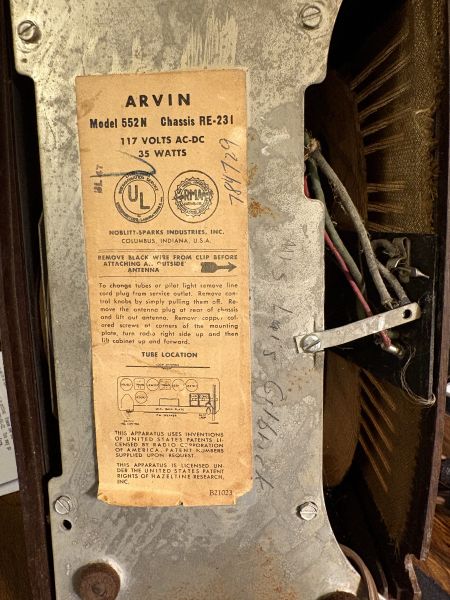

I love this part of the restoration. Looking the radio over in detail, getting to understand what's wrong with it, what you might be able to do to fix it, what you are going to need to order and the best part...finding the surprises inside the radio. On the bottom of this radio there was a name that was probably written by a repair tech at some point in the past. In this case it was: "Mrs Luis Gilbrick".

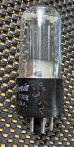

Also on one of the tubes, the tech has put in grease pencil, OK 1-3-52.
I bought the radio at one of the many antique shops nearby in Aurora, Oregon. One of my pastimes is genealogy so just for fun I thought I'd see if Mrs. Gilbrick was in the area in the 1950s.
Lo and behold, the 1950 Federal Census revealed a Louis C. Gelbrich age 55 and his wife Lucile D. Gelbrich age 50 living on Lone Elder Road between Aurora and Macksburg Oregon. Louis was a conveyer operator at a sawmill as well as a farmer. The 1950 census also had a selective sampling of people who were asked extra questions and Lucile was selected for those questions which revealed her mother was born in Germany, her father in Ireland; she had gotten through 8th grade, worked for 4 weeks in 1949 earning $90. It turns out that the Gelbrich's lived in Bend Oregon during the 30's and 40's (about a 3 hour drive southeast from Aurora on today's road) but in the 1920's, Louis and Lucile, at the ages of 25 and 20, were living with Louis's parents on the family farm somewhere near the very same Lone Elder Road.
I think I have Lucile's radio! Thanks Lucile.
For a bit of closure...Louis died in 1977 and Lucile in 1982. Virginia, their daughter, married Henry Masterson in 1942 and she passed away in 2013. It turns out there is still a Masterson family member owning the property along Lone Elder Road! Sometimes these radios come along with stories.
