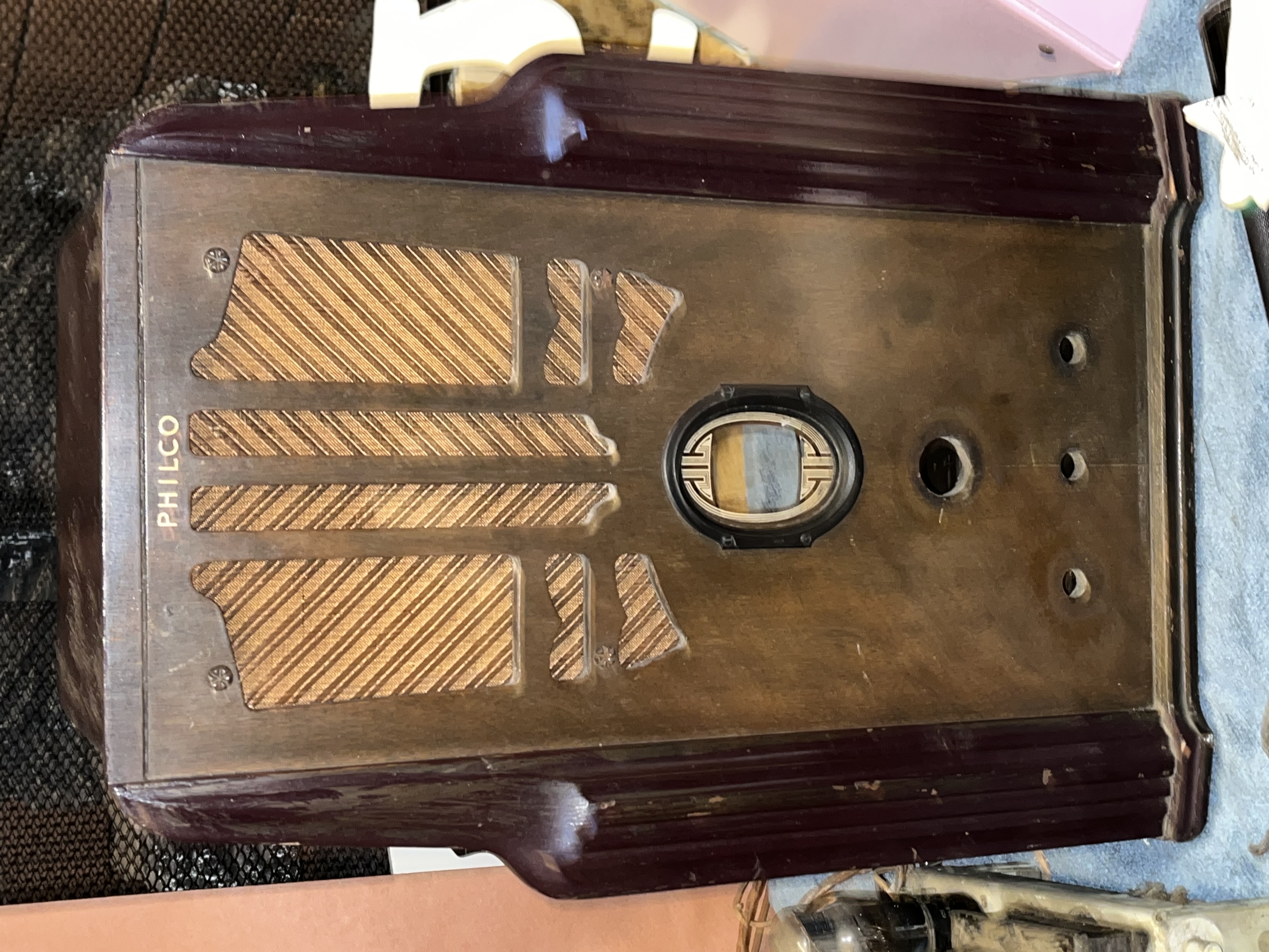

To answer your question that set is a good one to restore and the chassis looks original and I would go for it

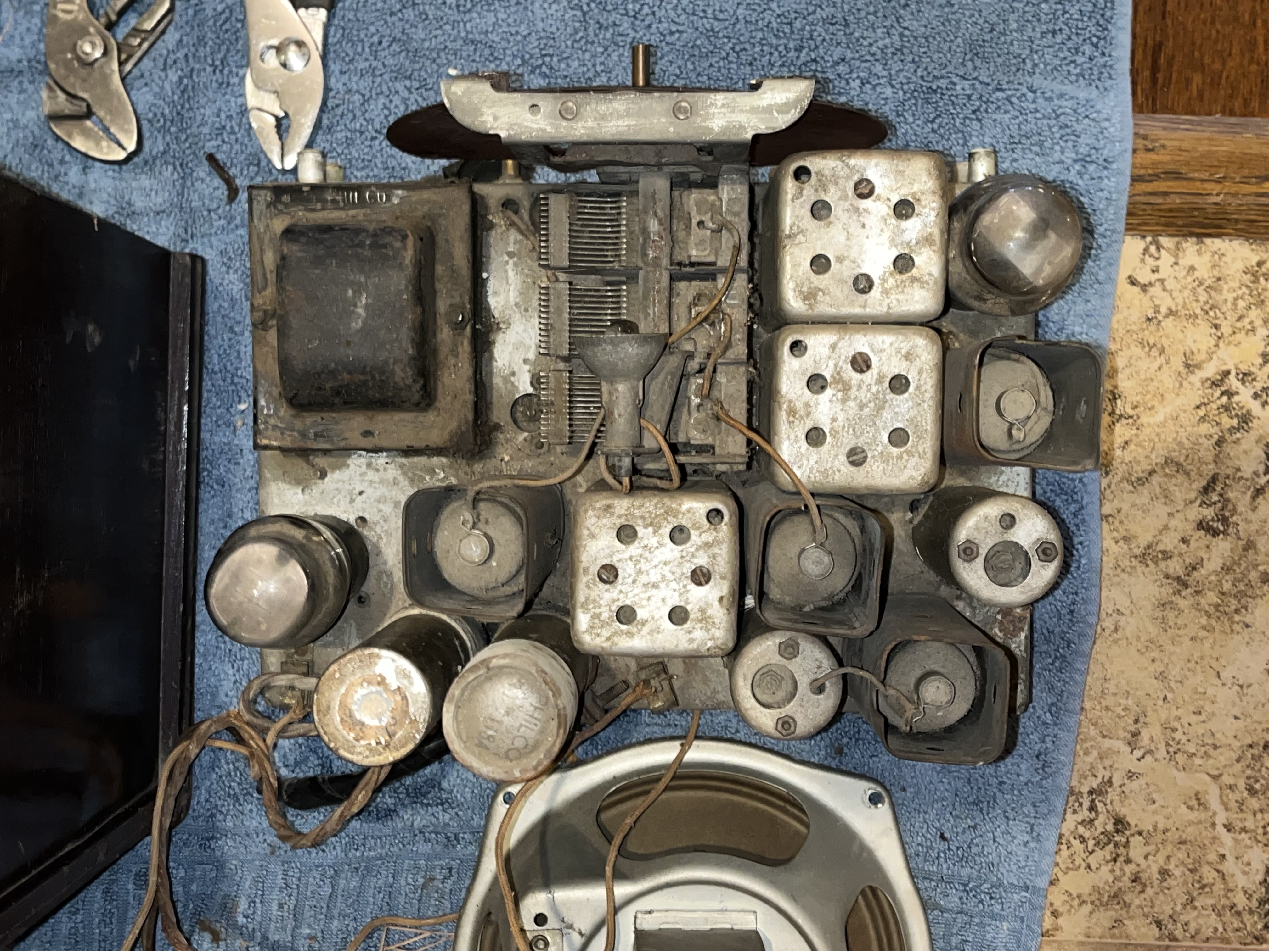

Yours seems to have a good grill cloth although I'll bet its pretty fragile at this stage. The cabinet looks pretty solid, the chassis appears dirty but not too rusty. As long as the IF, audio and power transformers are OK you probably have a winner.

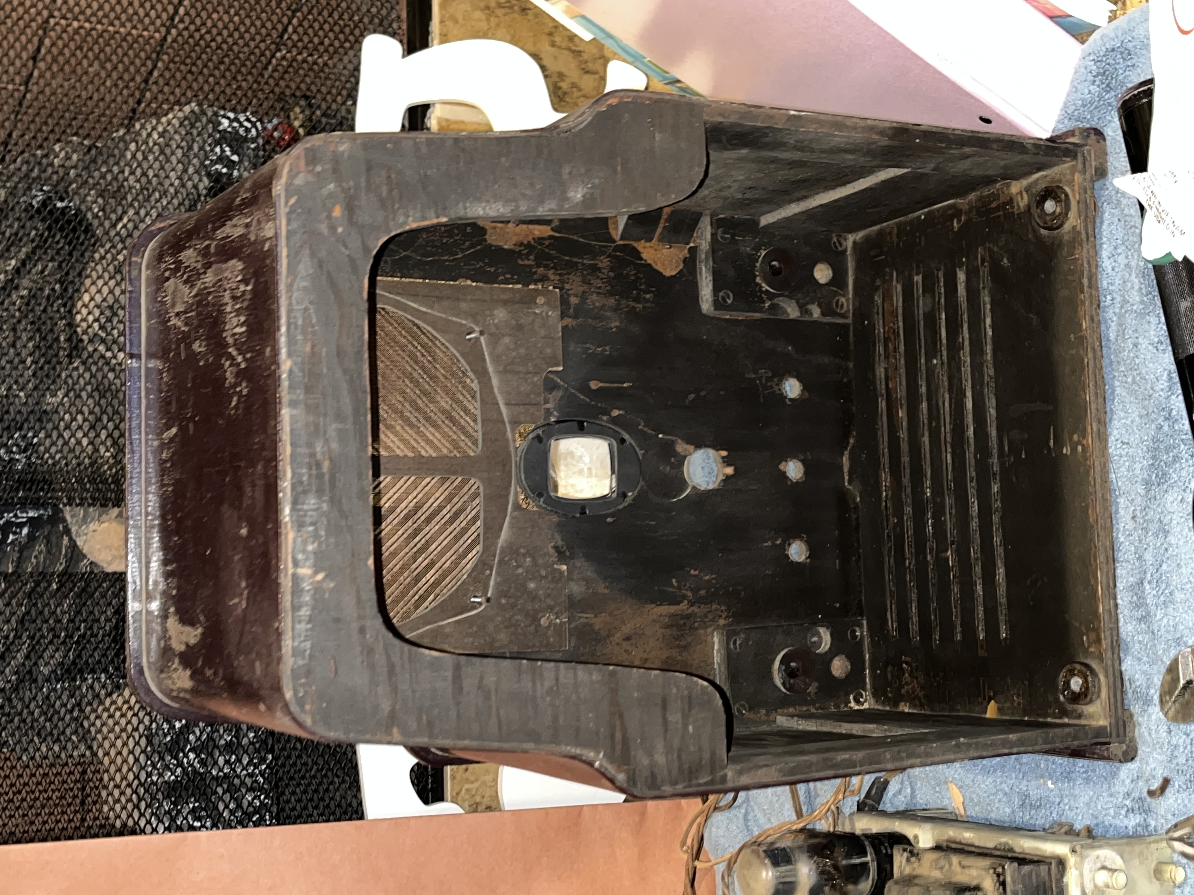

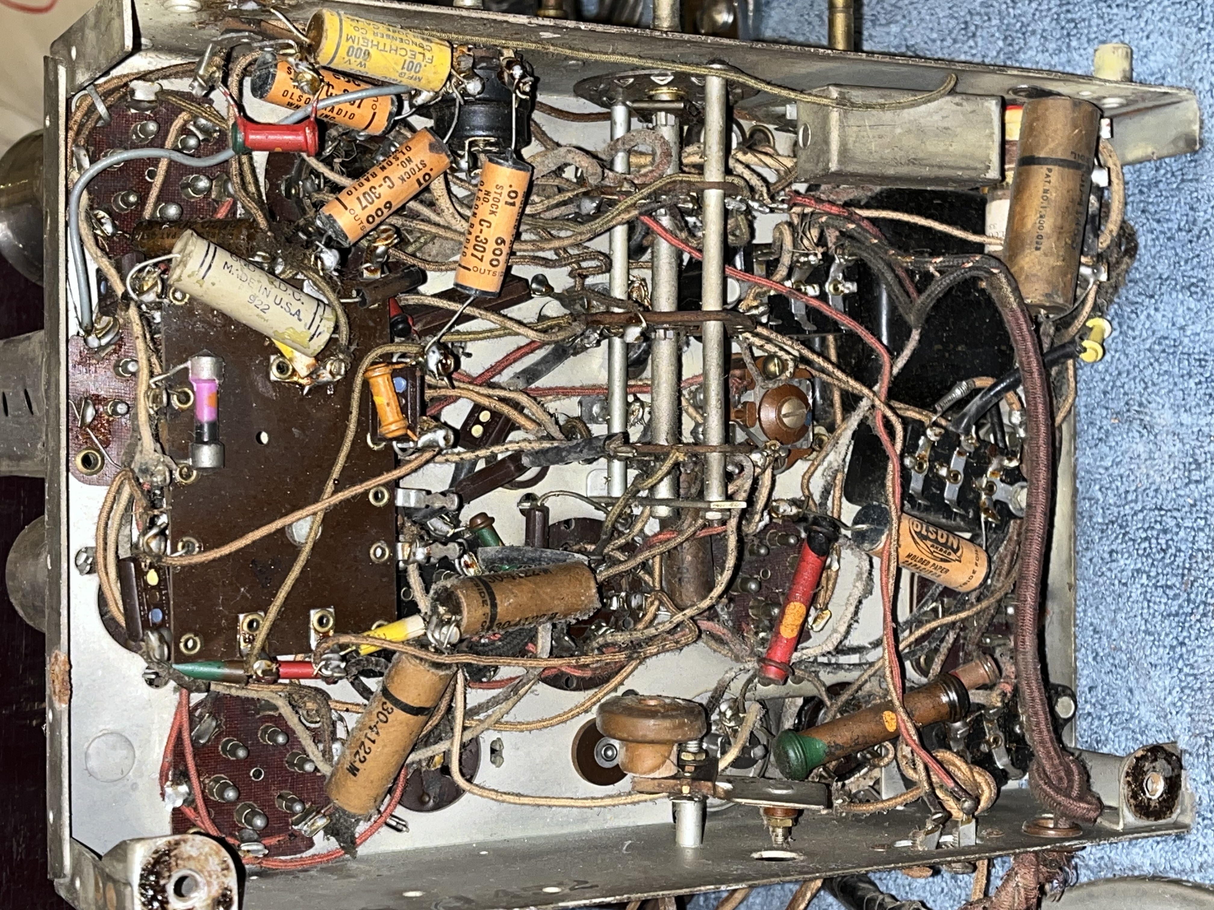

Thank you for the welcome! I'm definitely considering a restore. It looks a little daunting right now. I'm used to nice neat circuit boards and what is under that chassis looks like a mess!! lol. I have no idea the condition of any of the components or how to go about testing the tubes. Definitely not going to plug this thing in without a little more confidence on the state of things.
My first thought would be to pull everything off clean and test. That could be quite a puzzle to put back together!
The grill cloth is actually in very good condition and surprisingly not very fragile. The paper on the speaker LOOKS good, but it IS very fragile and has come unglued on the edges. It definitely needs a new power cord. Would love to have something like the original braided cable. The other braided wires are probably ok.. just dusty, dirty and old.
I'll have to read around on here to see what the best approach to start working on this would be.

The speaker cone can likely be repaired. All the paper capacitors will need to be replaced along with the electrolytics. Out of spec (off by more than 20% or so) resistors need changing. You'll want to become familiar with the schematic symbols and check for bad transformer coils. Those can sometimes be repaired depending on your skills but can require a replacement.
Tubes are often good even in radio as old as yours but testing requires a tube tester. Most of us in the hobby have one so you may be able to find someone local to help you with the testing or there may be a vintage radio club someplace near you.

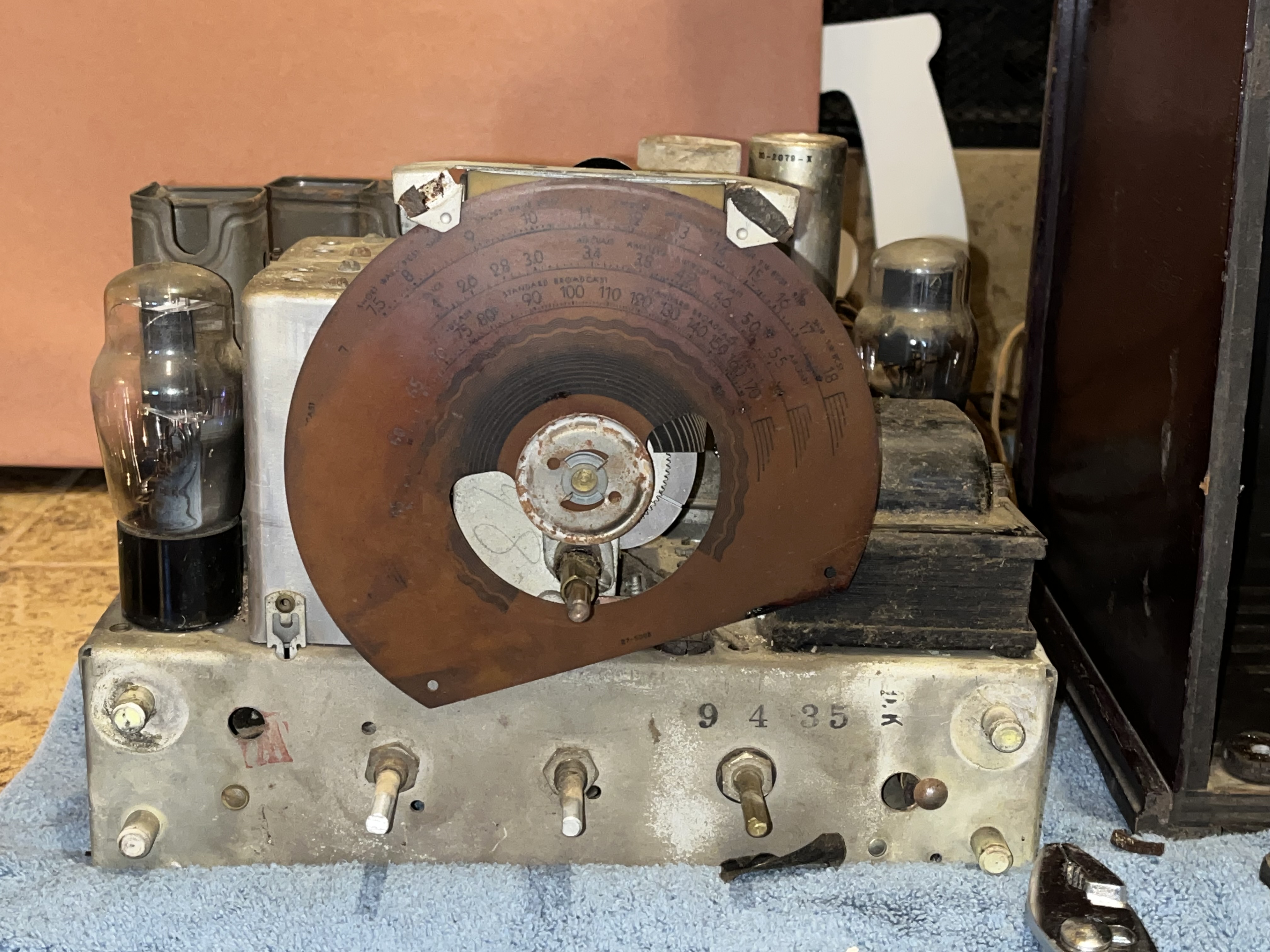

Welcome to the Phorum. One thing to keep in mind is to take photos before taking anything apart. We often get distracted or something causes a pause in the project and if you don't have photos to remind you how things were then you can get headed down the wrong path. One other point I noticed from your photo, it appears someone tried cleaning the dial and used water or a water based cleaner. Well, you can see what happens in that case. The dials from this era are printed with a water based ink, so using water to clean the dial is not recommended. You can use mineral spirits and a soft cotton cloth or cotton swabs to gently clean the dial. And speaking of dials I believe your dial assembly teardown and rebuild is covered in the Philco Library Service Info section.

@RobB - Absolutely. I'm taking plenty of pictures! Yeah, I notice the dial is missing some of it's printing. I've already figured out how to remove it so I can clean. Are replacement dials available? I haven't tried looking yet.

Those Olson brand caps are replacements from the 1950s or 60s, they used to be a discount mail order house that not only sold parts, but kits, and early Japanese import electronics, sort of like Lafayette Radio. I believe that most of the original paper caps were of the Bakelite block type which the Olson brand ones are either bypassing or are connected across. The Bakelite blocks can be restuffed and Morzh (Mike) has worked out a method to do so without disconnecting the wires from the terminals on top. The filter cans can also be restuffed, and are large enough to fit larger value film caps inside if you want to go that route. The resistors may or may not be still in spec, those body-end-dot code resistors, of the dog bone style, often like to drift in value.

One more thing, whilst you are cleaning don't use water to clean the dial, or the letters and numbers will wash off oft it, dry dusting, followed by mineral spirits.

Hi Eewill, I have that very same radio I restored 8-10 years ago and it is a decent performer so yes it’s worth restoring. I know it’s very tempting to plug it in but don’t until at the very least the electrolytics have been replaced. When you have it ready for a test run, it’s probably in need of an alignment so a signal generator will be needed. If you need a new dial, radiodaze.com is a good source for that dial and other parts…https://www.radiodaze.com/philco-620-630-27-5098/.. Enjoy your project.

There's a reproduction dial available from Radio Daze but it's pricey.
You might want to wait until a parts 620 comes along. It's not like the radio won't work without it.
