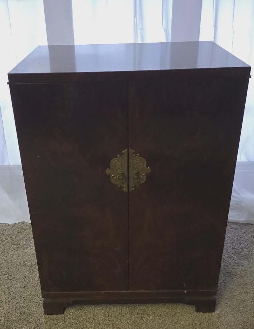

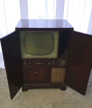

Hello Everyone, a friend of mine recently had a friend who passed away and he was helping his friend's widow go through her late husband's stuff and he bought for me a 1953 Philco Model 53-T1886 Code 125 AM/FM/Phono/TV Combo Unit that was something he had I guess bought years ago to restore, but I'm not sure if he ever got around to restoring it electrically or not or if it just sat around collecting dust.
I'm wondering if there's anything in particular I should look out for when attempting to restore this unit electricallly or if I should just go about working on this unit like I did with my old Meck/Philharmonic TV and just replace a few caps at a time and just test it out as I go? Was this TV known to drive tubes hard or was it easy on tubes? Also how was the flyback transformer on this set and the Hi-voltage section in general?
This is the first Philco TV from this time period I've ever worked on and so I'm not sure how the early Philco TVs are to work on compared to say Zenith or the Meck I previously Worked on thats from the same time period, I have worked on one other Philco TV, a Philco Townhouse, but that was from almost 15 years after this TV was made and so the chassis was quite a bit different.
See Photos Below.

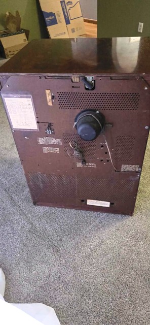

I picked it up today, and it says on the pencil-box cover Philco UHF on it, and there appears to be a 4-position bakelite knob on the back of the set and I'm wondering if that knob is supposed to be the UHF Knob? But the weird thing is that the VHF Tuner knob doesn't have a UHF Position, just Positions 2-13, I wonder if the UHF Tuner is triggered Independently of the VHF Tuner on this set?
Obviously the UHF Tuner working or not doesn't matter anymore because of Analog TV being no more but if I wanted to try and do something with a Blonder Tongue Modulator at some point in time that would be handy to have the UHF Tuner functionality.
This TV is not very big surprisingly enough, it only comes up to just below my waist height wise and width wise its only about a couple of feet, way smaller than my 2 color consoles I have.

It's probably a converter that sends the signal to a VHF TV channel frequency.
Posts: 374
Threads: 41
Joined: Dec 2019
City: Elkhart
It would make sense that it would be a converter of some sort, because inside the TV Cabinet it has a label saying "This TV has a provision for an internal installation of a Philco UHF Converter Model T-21 Only. Please refer installation to Factory Supervised Philco Technician." And that knob has a 300 Ohm twin lead with spade connections on it that look like they are meant to be attached to the VHF Antenna Terminals on the back of the TV, my guess is that the knob was preset/tuned to the UHF Stations available in your area (which would explain why it was a 4 position knob because when UHF first came out, there was usually only 2-4 UHF Stations in any given TV Market, and thats it, and it probably was designed to work on either Channels 2, 3 or 4, depending on what VHF stations were in use in your market.
