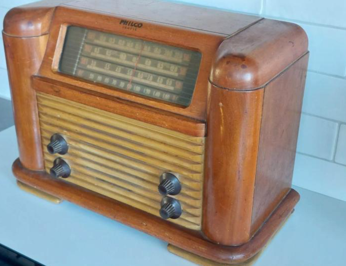

From what I understand most of the post war Philco Tropic sets were either manufactured in Canada, or in Great Britain, without seeing the set from the back it's hard to tell which. I think it's likely that this was a British made Philco as the knobs are different from any I have seen on U.S or Canadian sets, this is assuming that the knobs are original.

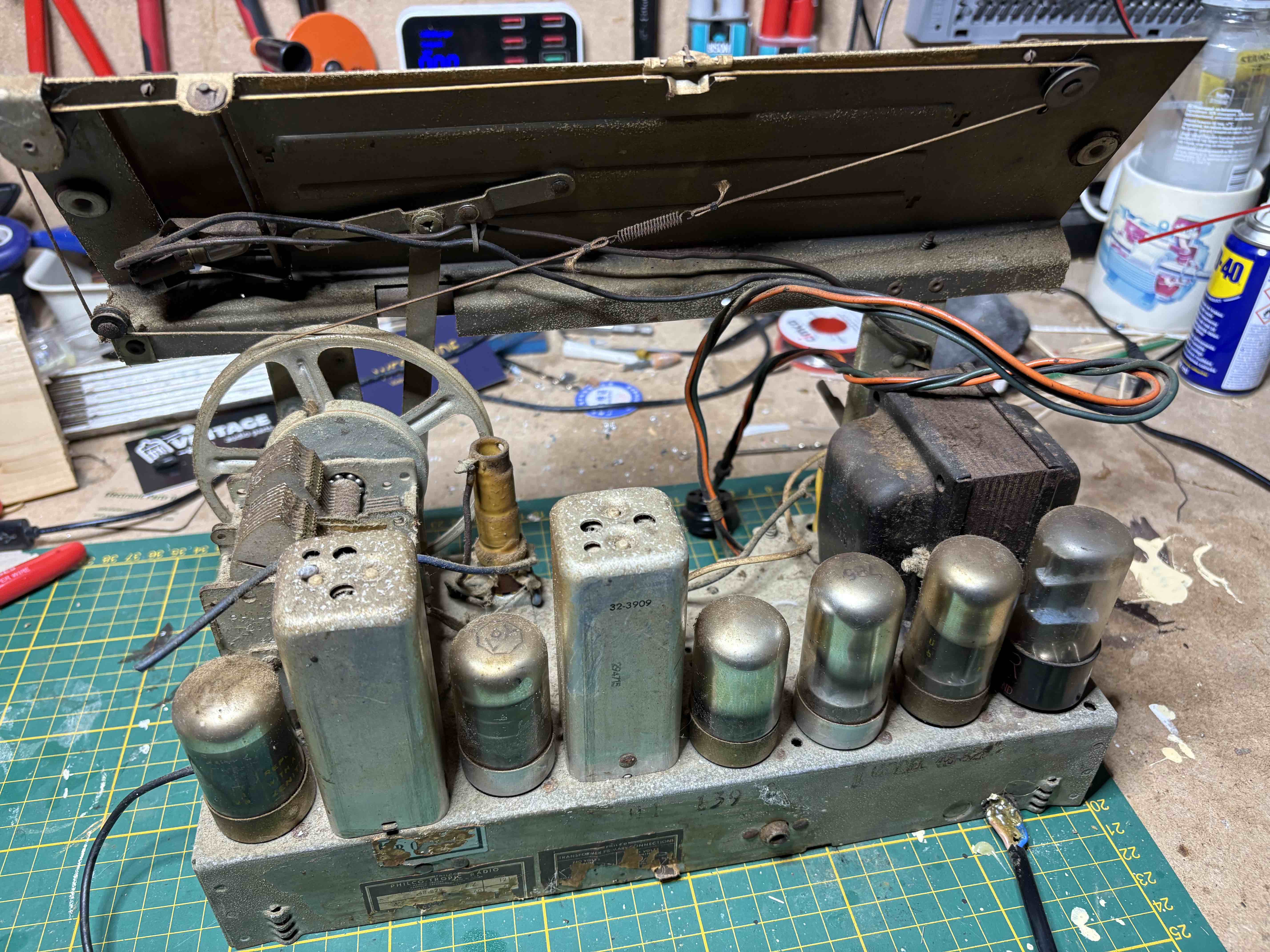

thanks Arran, I will chatgpt on "screen grid inversion" and try to post a inside back picture (I see no add picture function n this quick reply field ..?
BR Victor

Here's a "How To" on adding photos by attaching them to the post.
https://philcoradio.com/phorum/showthread.php?tid=4407
