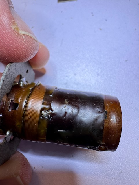

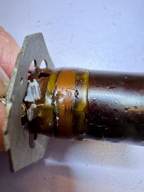

Checked the coil and it was not reading any thing on the primary (g2) winding. Took it out and the small, outer winding was open, and the larger inner winding was reading high ohms. Did a little soldering and was able to get the outer winding reconnected, but the coil is still bad reading high ohms on the secondary. Just a few winds of "green rot" visible under the wax, but mostly intact otherwise. But that's that.
So I need to either find a local-oscillator coil or re-wind it. The Philco number is 32-2496. Doubt I'll find a friendly neighborhood Philco factory store in the neighborhood with spares on hand.

The outer coil is easy to see. The inner coil, which is reading crazy high resistance (around a megohm), is more buried in wax, and I can't make out what it is made of or how many wraps there are.
I've always been told this wax is beeswax, I don't know if it is or isn't. I did look around and found USP (pharmacy grade) beeswax prill (little balls), yellow or white.
It would be great to figure out the values of the coil before I take it further apart. From signal injection, I can tell the I.F. is 260kc, and the RF amp is functional and tuning properly. I can probably work backwards from there, perhaps measuring the tuning capacitor and trimmers (padders) and doing some calculations.
The particular oscillator transformer I have is a 3/4" diameter phenolic air-core. Looks like there might be a thin outer sleeve that the outer (tickler?) coil is wound on.

Yeah, I doubt that any part of the oscillator coil should be in the megohm range. most windings in oscillator coils read under 25 ohms or sometimes less than 5 ohms. I am hoping that the break i at the "top" of the winding, right under the tickler.
The wax can be melted off the coil by heat gun (be careful) or in an oven set no higher than about 200 degrees (be careful that the Wife is not home, of course).
if the break is found and is not under the tickler, it can be spliced. In fact, there are supposedly instances that this occurred in production during the early 1930s. When the spool ran out in the middle of winding, they merely spliced the beginning of the next spool to the unfinished coil and finished the winding. However, each winding was a single layer back then, as the coils were rather large.

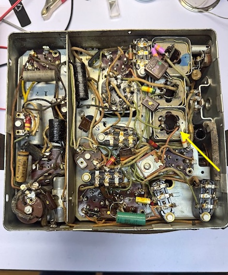

Picture of the underside, oscillator coil pointed to by the yellow arrow. This is how the chassis was when I first opened it.

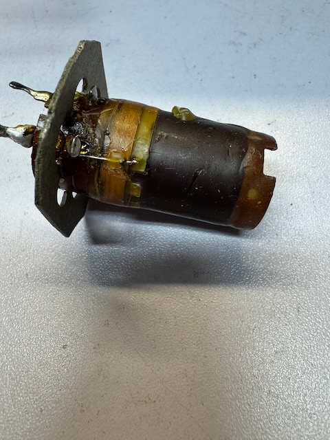

Happily, I was able to repair the coil last night. Found a second break in the primary coil.
Then I began probing the secondary coil by moving some of the wax out of the way and scraping the enamel (or varnish, whatever they used) from the wire and testing for continuity. Found the winding right above the end of the secondary coil was open, but the winding right above was still good. Decided to just bridge the windings with a dab of solder and that got a decent 14 ohm resistance.
I think I only lost maybe a half-a-turn in the secondary coil, but was really happy the defect was above the primary coil layer.

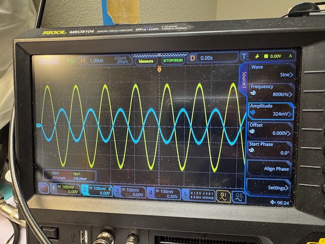

Applied an 800khz signal to the primary and put the scope on the secondary and it was working nicely and stepping up the input about 2.5-3x.
Once tested, I redistributed some of the excess wax to where I did the repairs, and gently heated with a small heat gun to soften and just melt the wax. Sealed my work up and immobilized it.
