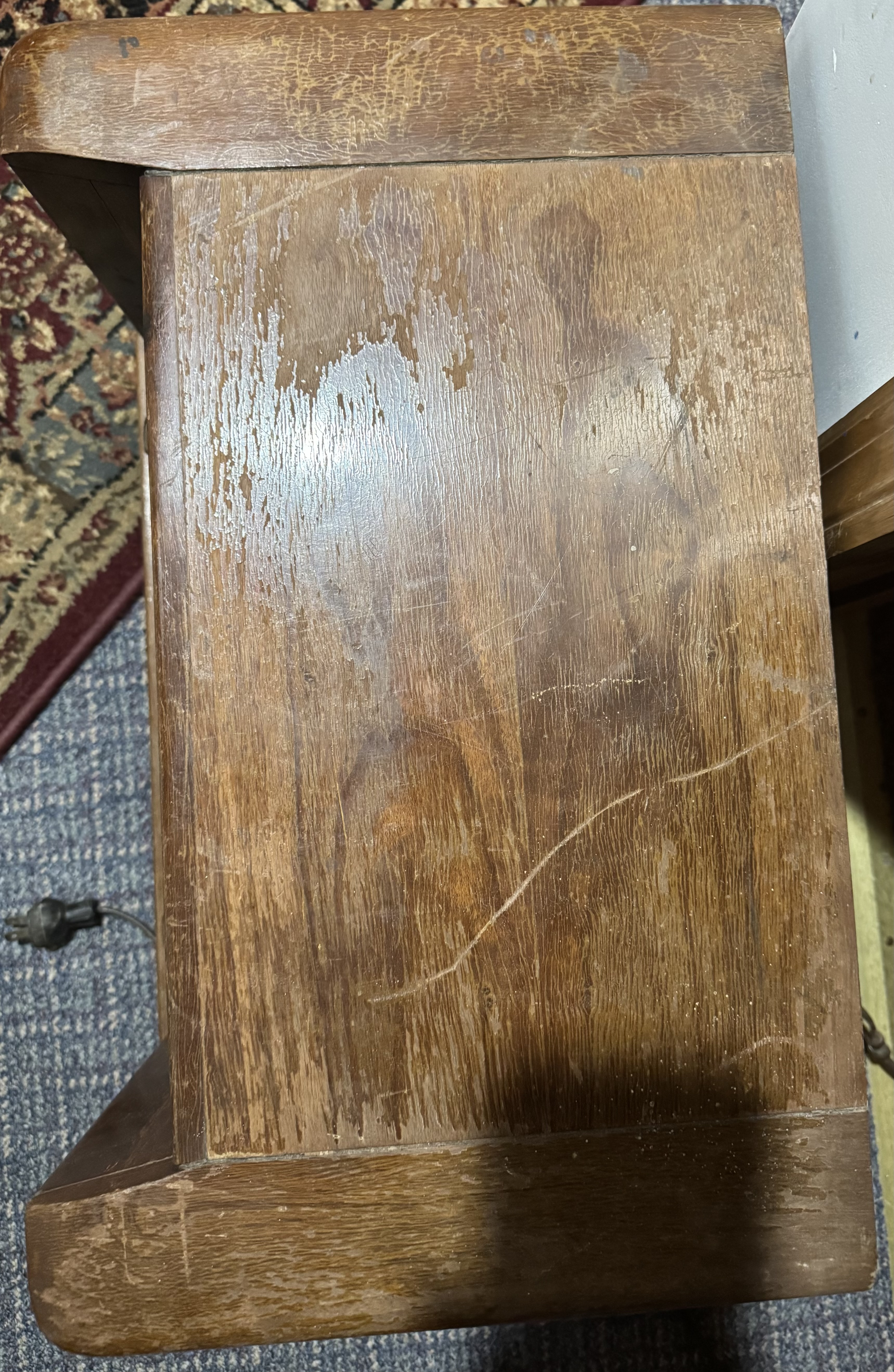

Top of radio veneer is stained.
I’m having a hard time posting pictures. It says that they are too big???
Well the picture of the top of the radio came through. The finish is pealing and it is stained. I’m

Yeah, I would sand it smooth to the wood removing stains and scratches, don't get too aggressive, finish with 150 then 220, spray with a clear lacquer, see how it looks. Either add a toner and coats of clear or several more coats of clear. Looking good.
