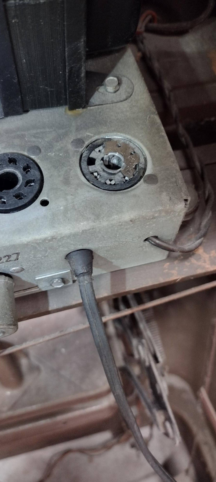

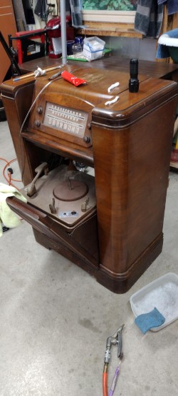

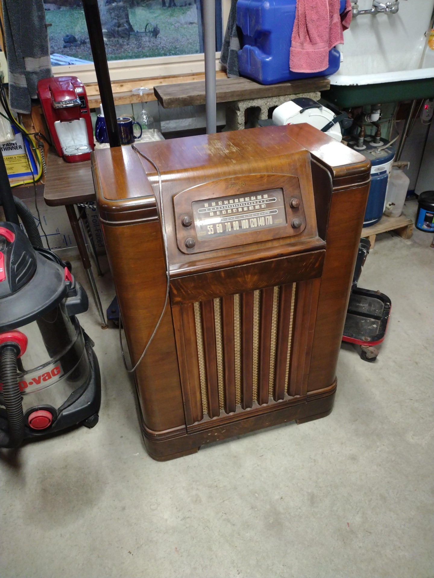

So, Friends elderly mother's elderly neighbors daughter, said anybody want this, etc etc. Philco 47-1227. Pretty intact, fixed power cord end, turn table spins, lights light. All there except tubes, got them through vacuum tubes.net. Question is one of the tube slots has what I'd say is half of the 'washer'
Do I care?

It is a good radio, with FM band, will sound very nice.
It seems to be in good cosmetic condition.
If it is free, certainly a good deal.
If not...consoles are not popular nowadays.

The panel is a one for "Loctal" tubes, which is the tubes used in these 1940-s Philcos (and other) radios. It might be still OK. Thought it seems cracking. You could also buy one on eBay or some places who sell them and replace it.
If you are getting it, make sure the speaker is good. (well, if you get it for free, not necessary. They are typically good in these, if you observe no damage to the grillcloth).
Also I am not sure, I think some piece is missing from the turntable. Which is as well, as you might just listen to the radio FM.

If you're interested I have a loctal tube socket I can send you for the price of shipping. Send a PM with address to let me know.

I would replace that tube socket, but I have some new loctal replacements on hand. Replacing it can be tedious. My Metcal SP440 vacuum desoldering station will help in removing the wire. Tag the wires first (I use ScotchCode numbers) so you will know to which socket lug each one goes.
Removing the rivets can be a challenge. If I can't easily drill them out from below the chassis I would grind the heads off with a Dremel bit such as a Dremel 921 1/2" ball aluminum oxide grinding stone. I would put the new socket in with pop rivets.
My Dremel tool is my favorite power tool in the field for work or in the shop. I have about 100 Dremel bits. I have a wide assortment of pop rivets for work or in the shop and a quality tool to install them.
If you have to replace rubber wiring you should first thoroughly photograph the underside of the chassis. I stock PVC-insulated hookup wire in several gauges, in both solid and stranded, and in all ten RMA colors. It is best to replace one wire at a time, laying it out next to the old one to get the bends and placement right (lead dress can be vital), and stripping the ends before removing the old wire and installing the new. You should probably also replace the power cord.
