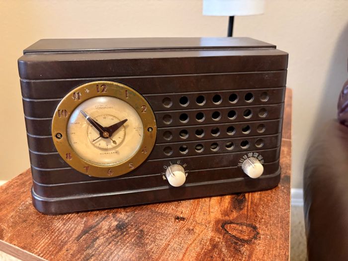

I believe this model was manufactured for a couple years after its introduction in 1946 based on the Telechron.net website. They say the price was in the $29.95 to $35.65 range. $29.95 in 1946 is about $497 in 2026 dollars.

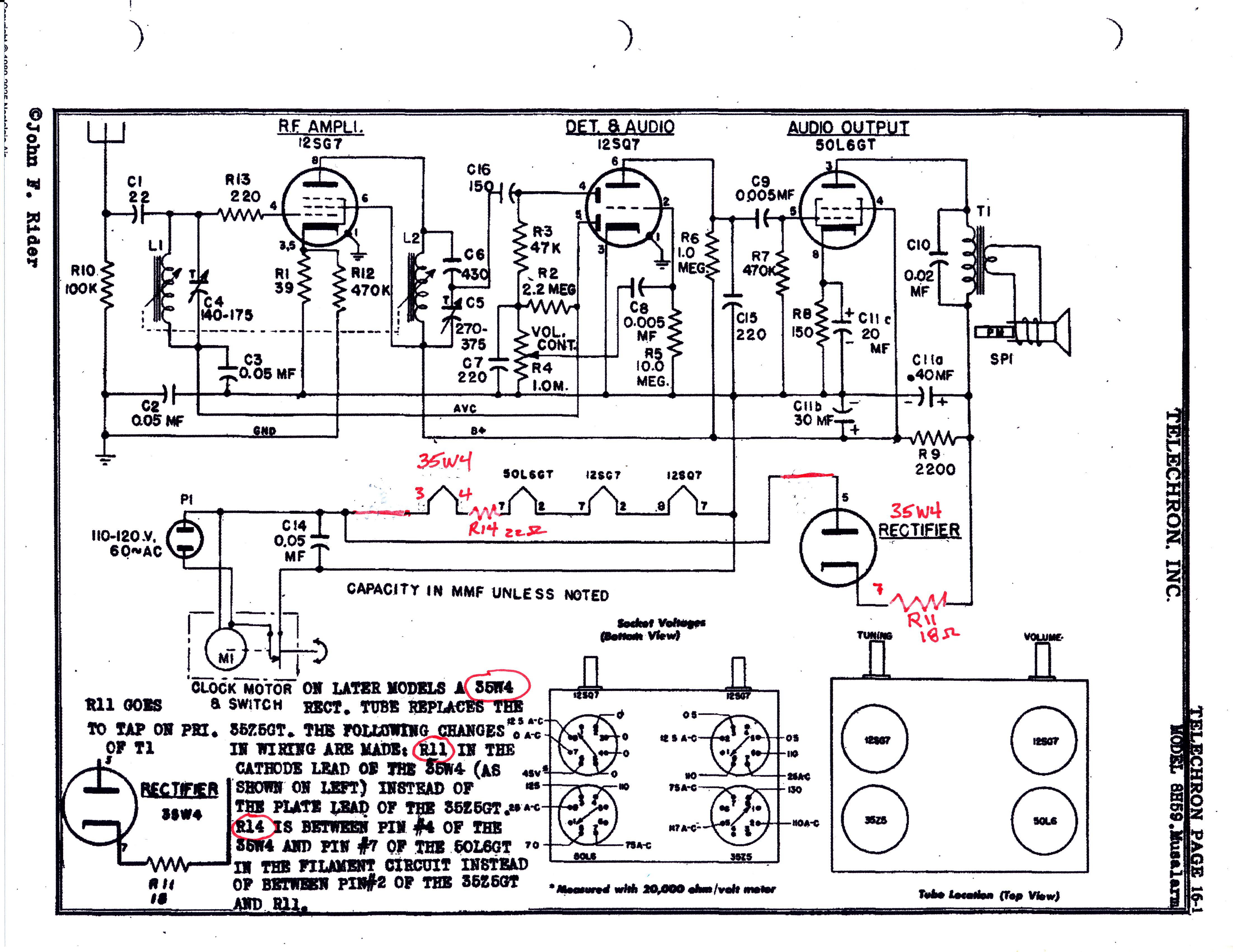

Here's the SCHEMATIC LINK. I did notice that instead of the 35Z5GT rectifier tube specified in the schematic, there is a 35W4GT tube in the radio. Looks factory to me and had to be a modifcation at some point since the Z5 is an 8 pin tube; the W4 a 7 pin and the socket is a 7 pin socket.

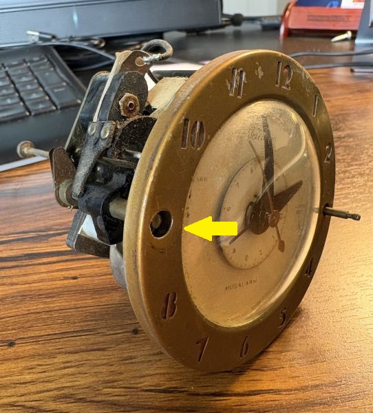

As I mentioned in the "New Years Finds" thread, the Alarm/Radio ON/OFF stem is broken off and the two knobs that go with the clock are missing. After looking around I did find a possible stem fix that may or may not actually work (Renovated Radios has a stem repair kit) but for just a bit more than the price of that plus a couple of new knobs I was able to locate a working Telechron 8H61 alarm switch that I think will be a drop in solution. We'll see once it is here.

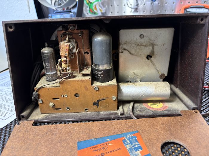

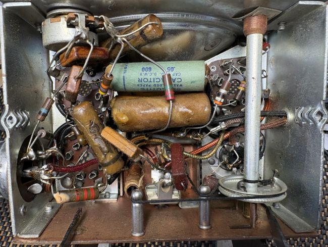

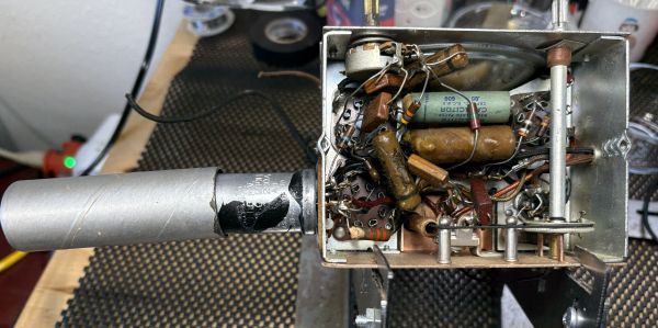

Its a bit dusty inside but I think it will clean up well. Under the chassis is pretty clean although its another tight fit for recapping.

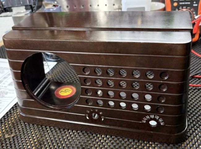

The cabinet came up nicely after a clean and polish.

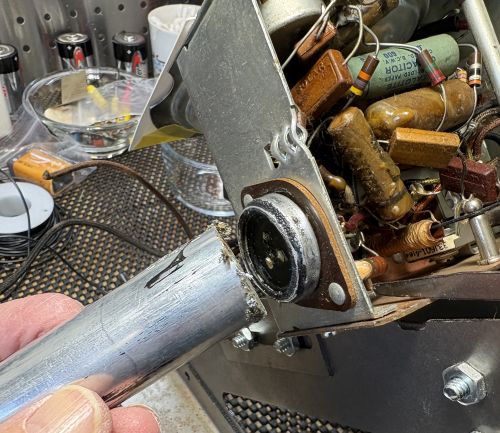

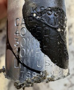

The cardboard cover on the electrolytic can came off with just a little warming and a twist. A hacksaw followed by cleaning out the old capcitor remains at the base of the can and I think it will be easy to rebuild the electrolytics here. Its a 40, 30, and 20 uF multicap.
Bob
Did the cardboard cover a regular twistlock under it?

Yes it did, now that I think about it, I wonder why they put the cardboard on it. I better take a closer look at the can and markings on it and trace the wiring. B- is isolated from the chassis ground by C2 but from the pictures I've take it sure looks like one end of R6 1meg ohm is soldered to the twist lock while the schematic shows it should be on B+ and the Plate of 12SQ7. It always take me awhile to sort out the schematic and I haven't spent enough time with it yet. I did photo the markings on the can for reference.
I had that once. Both the twistlock inside and the cardboard had the capacitances etc marked on them.

Likely the cardboard cover over the twistlock and the twistlock floating from the chassis to meet UL requirements for shock protection if there was no interlock on the back. Apparently, they started to think a little about safety in postwar radios. Later sets had the all-paper "firecracker" jobs which did not hold up the way that the metal ones did.

A pipe cutter makes a clean job of cutting the cap fgor restuffing.

I need to spend more time reading the schematic info before I start posting!  It says right on it that later sets used the 35W4 with slightly modified wiring. I also need my colorblind glasses. That 1meg resistor I thought I saw in the photo is really 10meg and exactly where it’s supposed to be. Brown-Black-BLUE, not green! Tubes are on order along with an an electrolytic I need.

Just to all be on the same page, the corrected or updated schematic is seen below:
There are 3 electrolytics and 6 paper caps in the radio to be replaced. C14 will get replaced with a Y2X1 safety cap. All the resistors seem to be within spec. Because of the small chassis and tight fit, I'll probably remove all the paper caps at the same time to be able to have better access to reinstall them.
