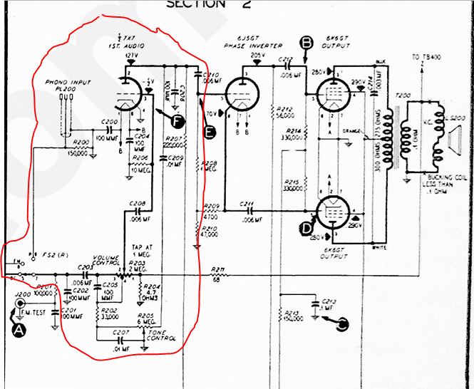

The turntable that you removed has a magnetic cartridge. Does the new turntable have a magnetic or ceramic cartridge?
Magnetic cartridges needed more amplification but generally had much less distortion than ceramic pickups and much, much less than crystal pickups.
I don't think that the transformer is the issue. This set has a "Phono Preamp" stage that is needed for magnetic pickups but would not be used for a crystal or ceramic pickup. You may be overdriving this preamp, as there is no volume control for it. The phono connects directly to this preamp stage. The output of the stage goes to the radio / phono switch.
You may want to eliminate this stage and connect a jack to the radio-phone switch phono circuit instead of the preamp. See the schematic below: If you had a magnetic cartridge (GE RPX, Shure M3D or M7D wired for mono, etc.), then you would use the preamp stage.
Check the turntable on another amp to verify that the cartridge is good. Is this a mono cartridge (2 leads)? If this is a stereo cartridge, make sure that you have it phased correctly. Reversing one channel will attenuate the output unless you were playing Edison records.
Attached below is a partial schematic that I marked up for clarity (or confusion):

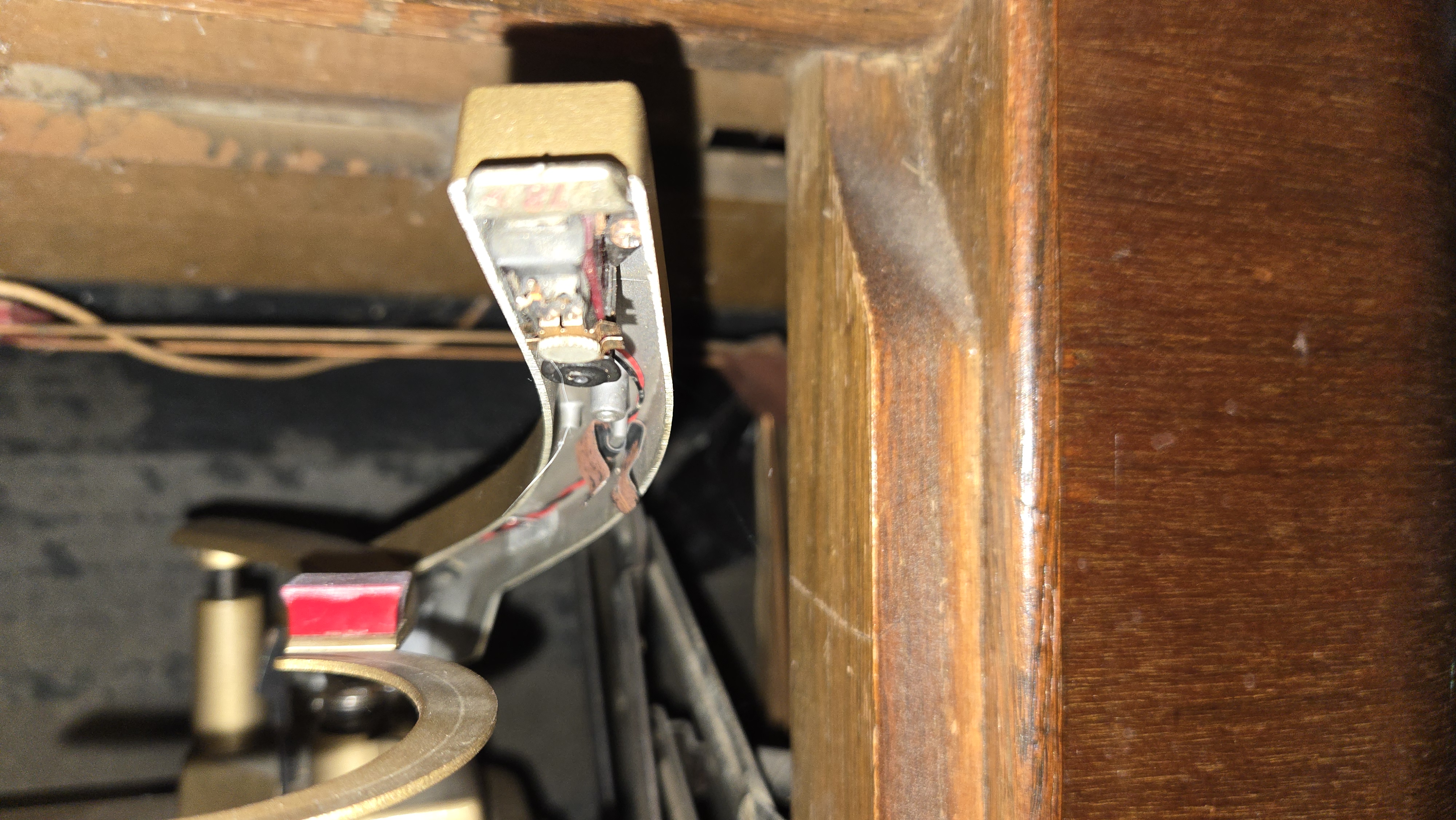

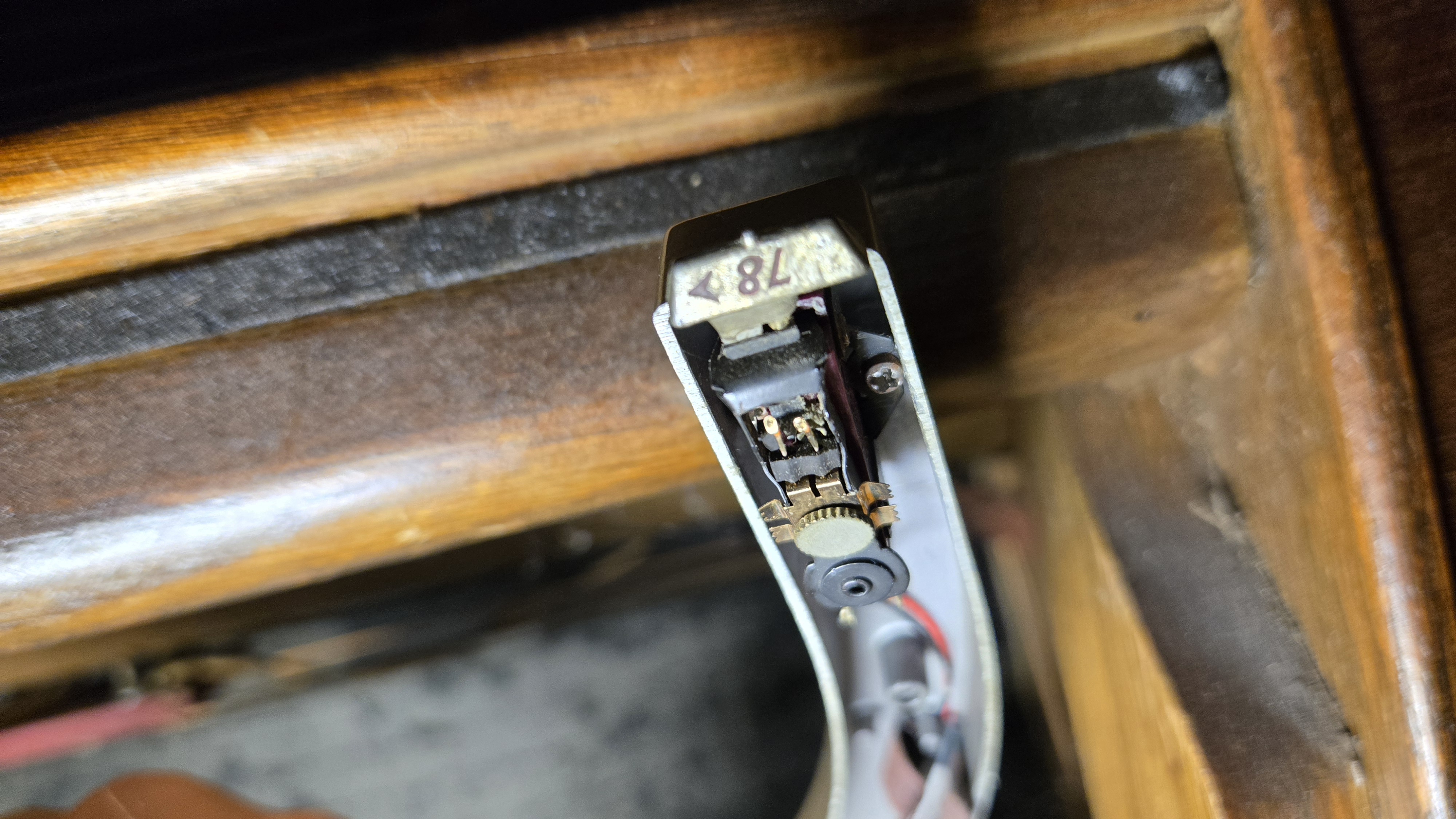

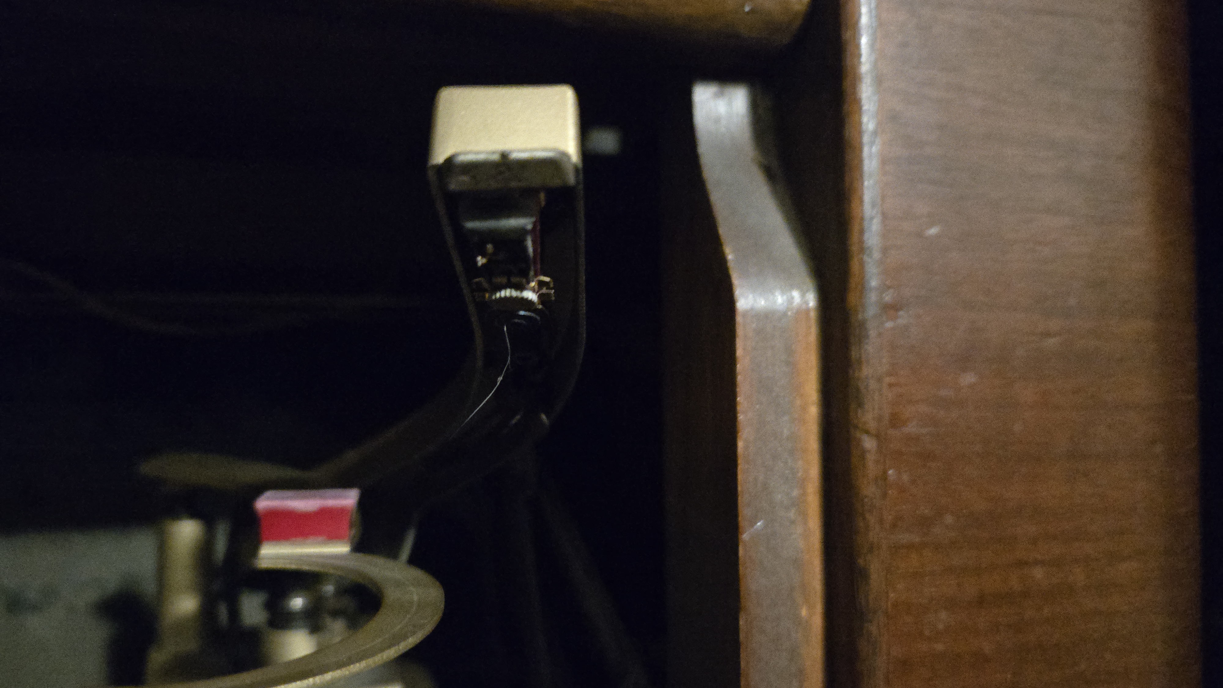

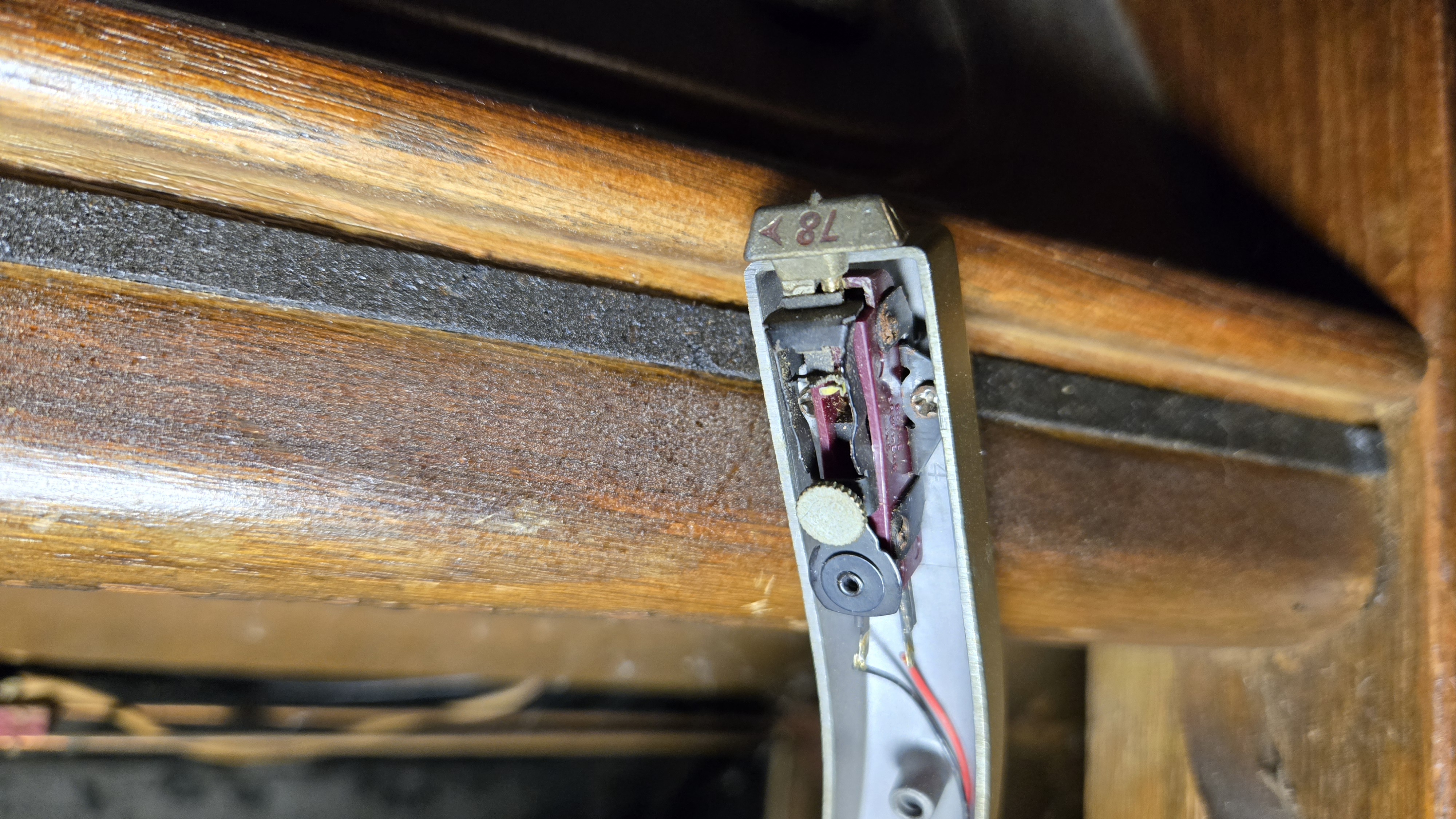

Here are some pictures. I am not certain what it is we're trying to look at, I can take better pictures knowing what to focus on.
Can it be an impedance matching issue?

A clearer picture of the cartridge would be useful. If you can't lift the arm further but can move the arm horizontally, turning the turntable over and moving the arm to the outside of its movement, you may get a good shot. I am most interested is a good pic of the cartridge. I have a lot of questions. Try to answer them if you can and I can give you better recommendations.

The cartridge uses a double stylus and there's a twist knob to switch between the two... But I don't have any 78 rpm records to play on it.
When I was preparing the vm-1200a to be assembled in the radio, I ran tests by connecting it to a 1970s era radio/amp unit for which I can't say the model at the moment (it is in my shed that's currently snowed in, happy winter) and the volume was not overwhelmingly low, the sound very clear. It wasn't as low as what I get on the Philco.

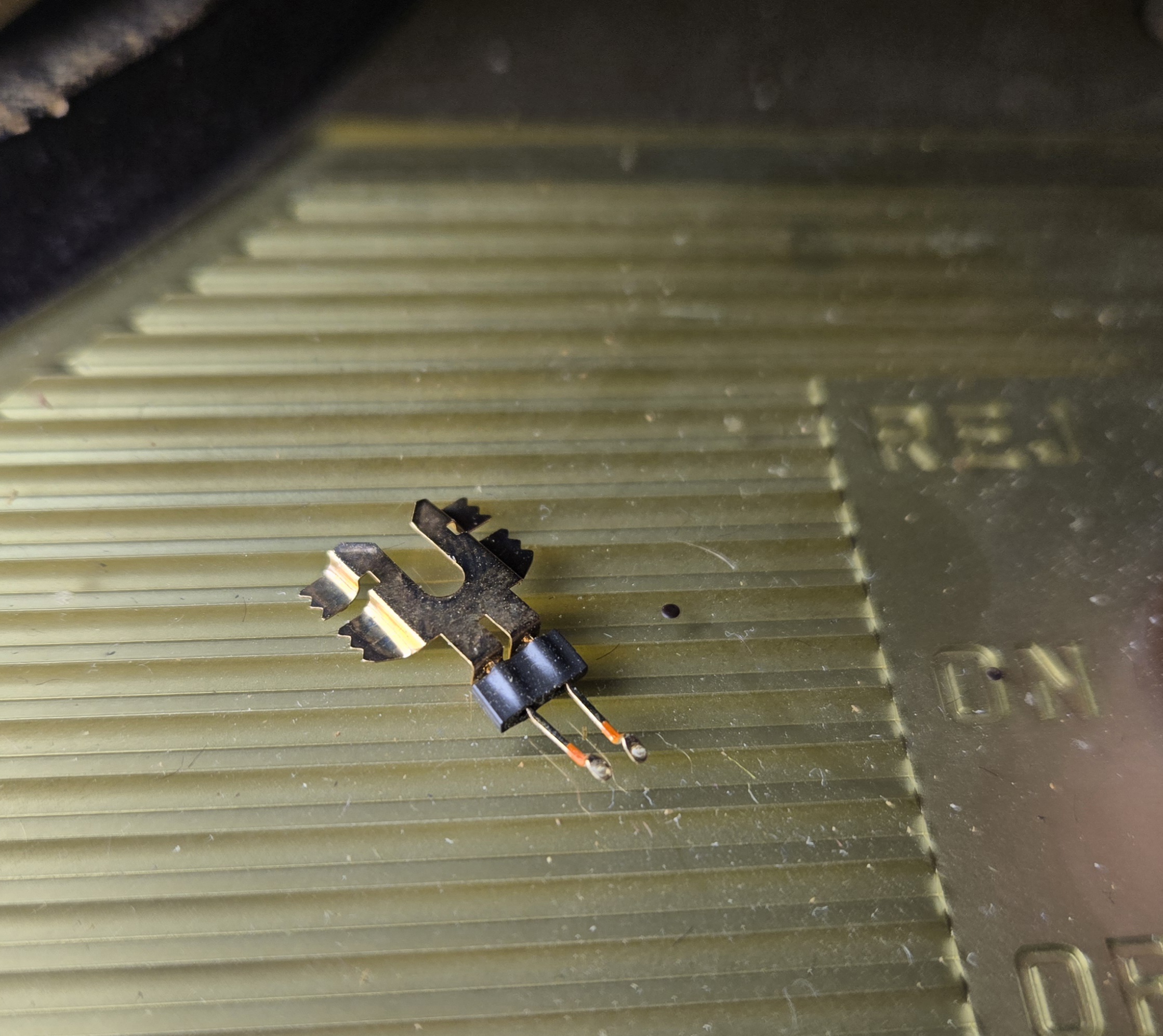

Here is a photo of the stylus, and the cartridge with and without the stylus.
I'm OK to alter the radio, but only in a manner that would make sense for the next guy who will do maintenance in there.
-Mars
