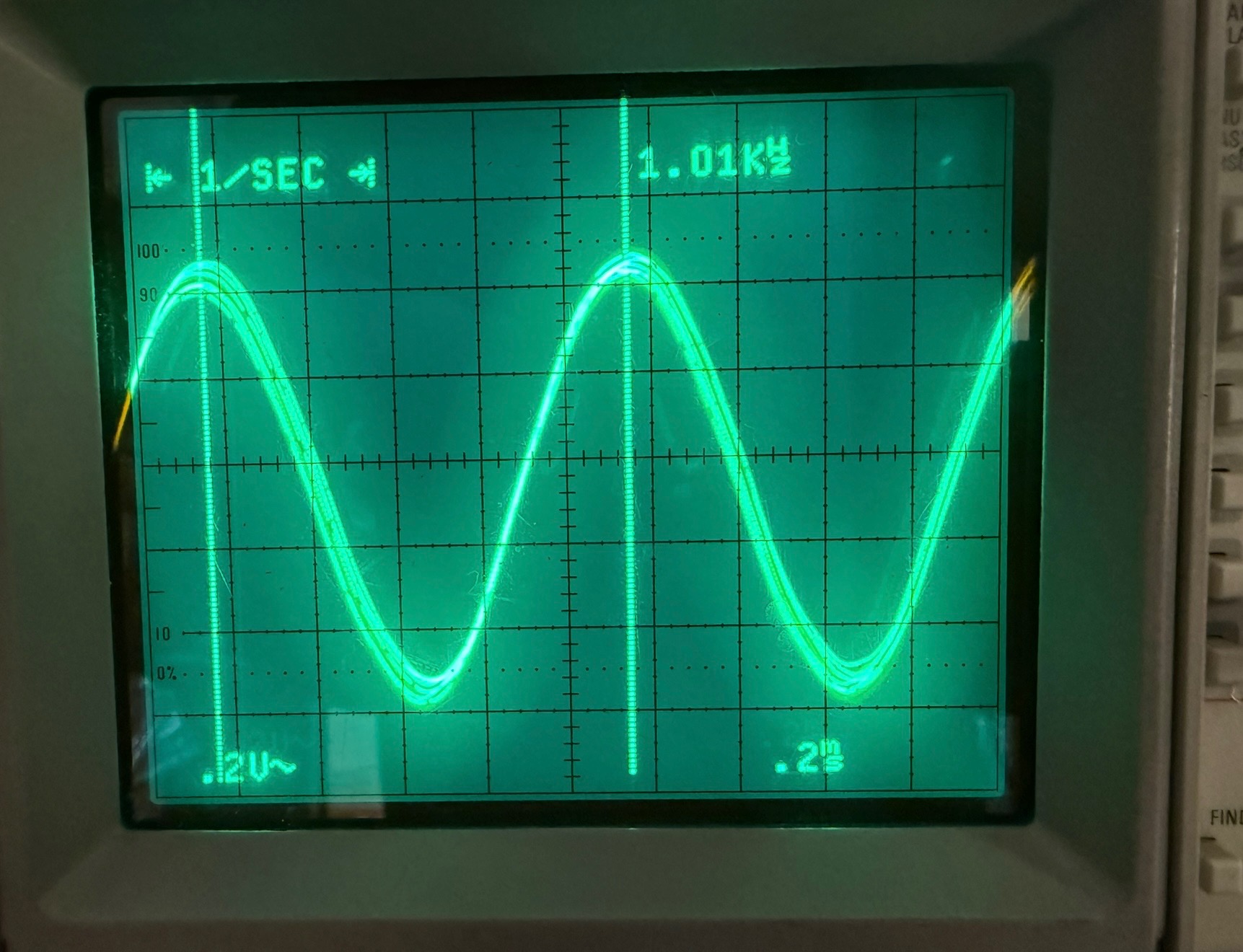

I'm assuming the coils are OK since I can receive so I guess the IFs are OK. I did an alignment following the instructions in the 146B service bulletin and the very clean waveform out of my signal generator is pretty distorted by the time it gets to the plate of the 42 tube.

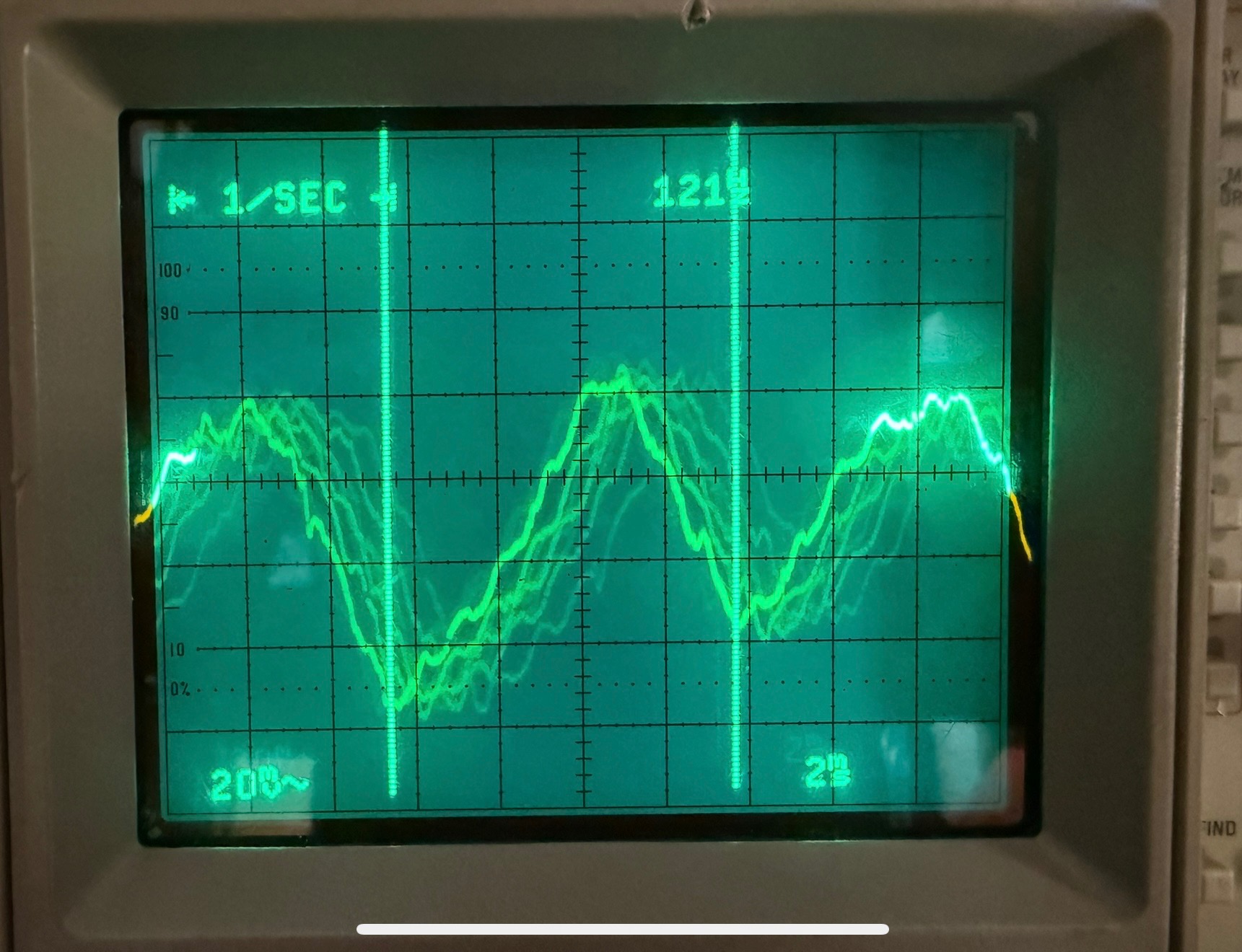

Noise on the plate of the output tube with volume at minimum and no signal applied:
Plate of the 42 tuned in to 1500KHZ:

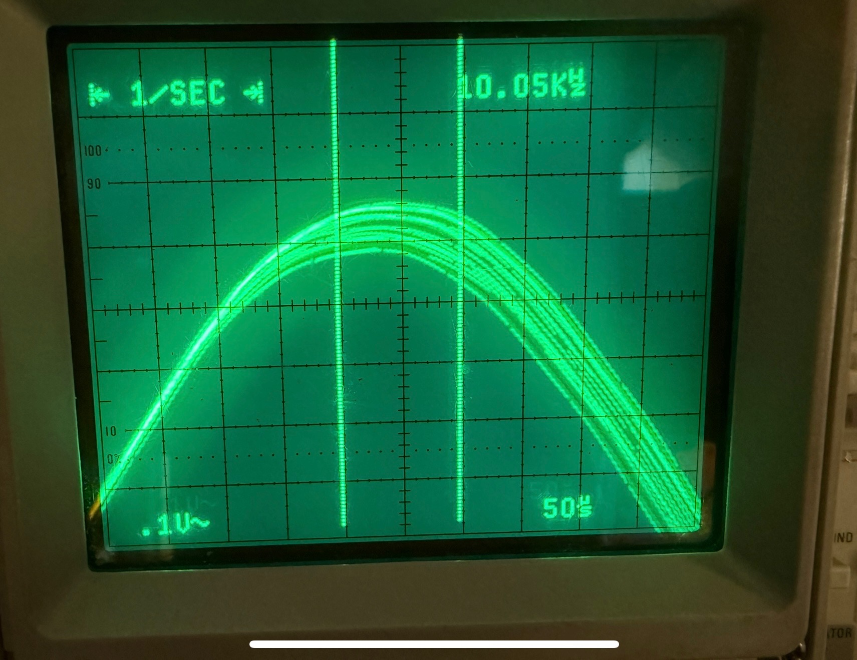

Close up:
Do these waveforms look like anything in particular?

100mV on a 250V output tube plate is not bad.
Many sets of this vintage us rather small capacitors. However, this set has a choke before the output stage, which provides sufficient filtering that a large cap is not needed.
