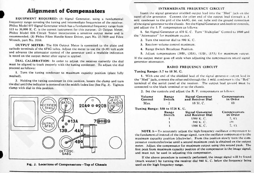

Hello, I'm having a hard time dialing in the RF alignment on this radio. IF alignment has been done with all four compensators peaked. I set the high frequency at 1500 and adjust #7 to peak on the second maximum peak then attempt to do the low frequency #9 at 580 I can't find the tone anywhere. The best I can do is set the gen to 740 then I find the tone way down at 500. I can not adjust #9 to bring it up to 740. The closest I can get is 700. When I go back to 1500 I find it is way off. There is a huge amount of interaction between #7 and #9. I am using an Eico 330 for the gen and a frequency counter to verify I am on the correct frequency. Bottom line is I can't get anywhere close to the low frequency setting of 580.
I have cleaned the 7/9 compensator fins and micas. They were pretty clean as it was.
See note (bottom right) in the alignment instructions.

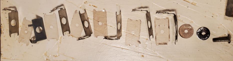

The IF is peaked up nicely. I checked the #10 3500pf cap and it measures pretty close. I don't have one but I do have a 2200pf and 1400pf I could wire in parallel. Would that be close enough? As for cap #14 I believe that is one of the leaves inside the #7 trimmer. This is similar to what is in #20 (the 100pf caps). So if #14 is part of the #7 trimmer wouldn't that cap change value as the trimmer is adjusted along with what ever else is going on in that tree. The parts list says #14 is part of #7. If I start with #7 fully clockwise and back off I can hear the tone multiple times as I back off the screw when the dial is at 1500 some strong and some weak. If I adjust as the note in the instructions say I can't find 580.
General question: As is back off a trimmer is the capacitance increasing or decreasing?
The picture shows what my #7 is made up of.
Dan

Turning the trimmer (compensator) screws CCW (Counterclockwise) lowers the capacitance because the distance between the plates increase. It is a little strange that they have Cap # 14 as part of Cap #7. It is possible that a shoulder washer between C14 and C7 would prevent squeezing the stack from changing the value of C14. Consider reassembly but not putting C14 in the circuit but replacing it with a fixed sealed cap.

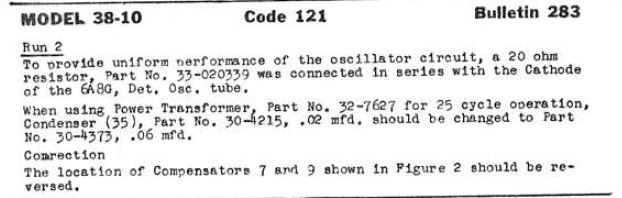

Well well well looky what I found. Read the last paragraph in the picture. Got the radio much closer now but not close as I'd like. My favorite stations, 740 comes in at 710, 800 at 780 and 1180 at 1210. If I dial in 1180 in to 1180, 740 and 800 get weaker. So I guess I'll leave it at that. I'll change the 3500 cap and see if that helps. The lower frequencies seem to get weaker the lower in frequency I go but that might be weather related as it is kind of foggy here. The top paragraph talks about the 20 ohm resistor.
BTW I'm not sure where I found this as I downloaded a changes PDF from somewhere but don't remember where. I guess I just got lucky I found I had this document.
Dan
