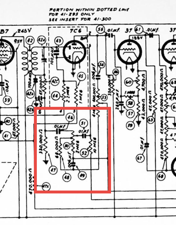

Also, since I think I would like to add an aux in at some point, where would that insert on this one? I know the switch/input goes near the volume control but I'm not confident where.
Typically you disconnect cap 46 from the volume control with a switch then connect the aux input to the top of the volume control. Now you have the audio source either from the radio or the aux input. Sometimes it isn't that simple. You may have to disable the radio somehow when it's in aux mode.

RodB: Thanks. I figured it was 46 or 51 but I really didn't know which.

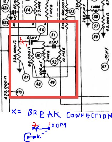

+1 on the Aux input.  Either break the connection between Cap #46 and the "end" of the Volume control, or (I think the netter spot), break the connection at the other end of Cap #46, (the junction between Cap #46, Resistor #47 and the Detector output of the IF transformer #42), connect cap #46 to the common terminal of a SPDT Single Pole Double Throw) switch, Resistor #47 and the detector output lead of the 2nd IF transformer #42 to one terminal, and the Aux terminal to the other terminal.  See the drawing below:
In the above drawing, the "common" of the switch connects to point labeled "1" in red. This is the 0.01 uF cap # 46. One "leg" of the switch connects to point "2" indicated in red on the drawing, the junction of Resistor # 47 and the lead coming out of the IF transformer that carries the output of the detector. The other "leg" of the switch connects to the Aux Jack.. the other connection of the aux jack is connected to chassis ground.
There can be some blead-through of the radio signal when the aux input is used.  To deal with this, either tune the radio to a quiet spot or use a DPDT (Double Pole Double Throw) switch where the output of the detector is shorted to ground when the switch is in the Aux position.

Thank you for the handy diagram, MrFixr55. Familiar enough spot since I just replaced all those components: I guess I'll just need to order the parts. I already replaced #85 with Y2 safety caps which I think is what's meant for that now.
