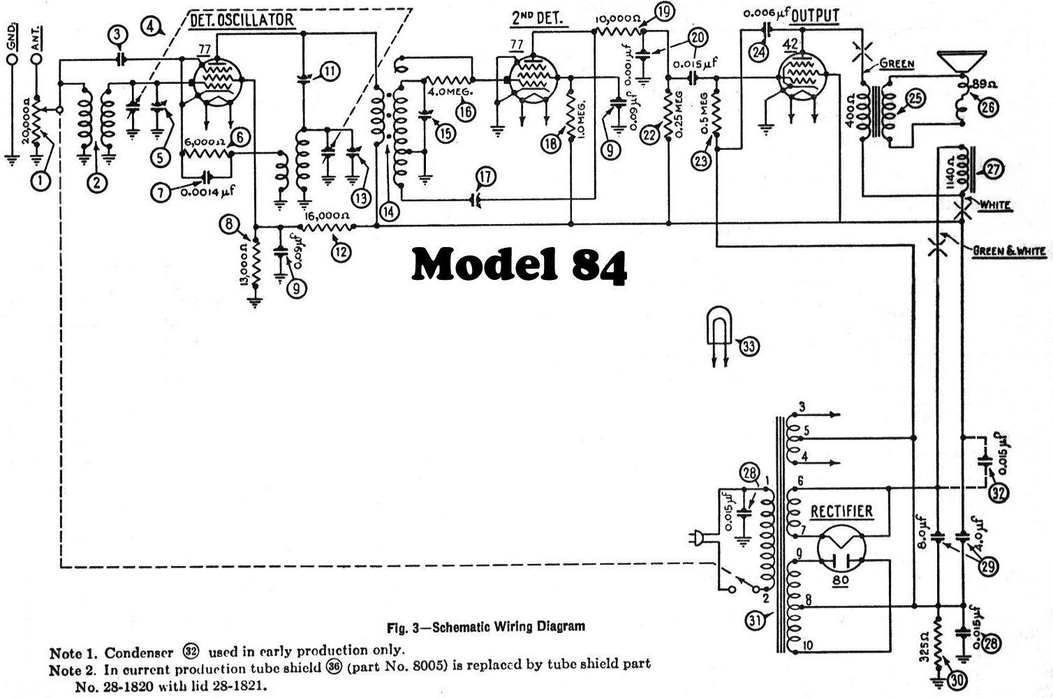

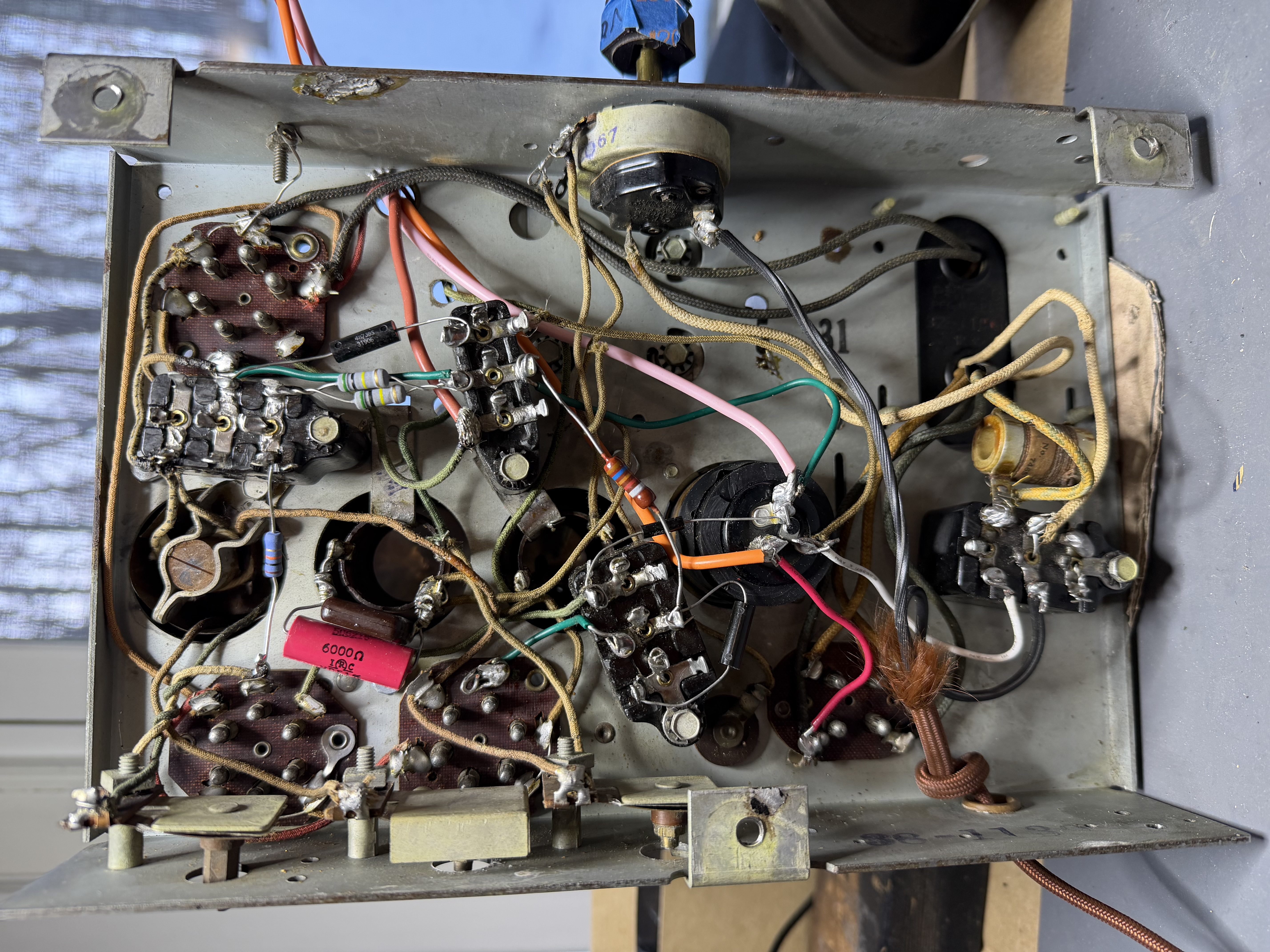

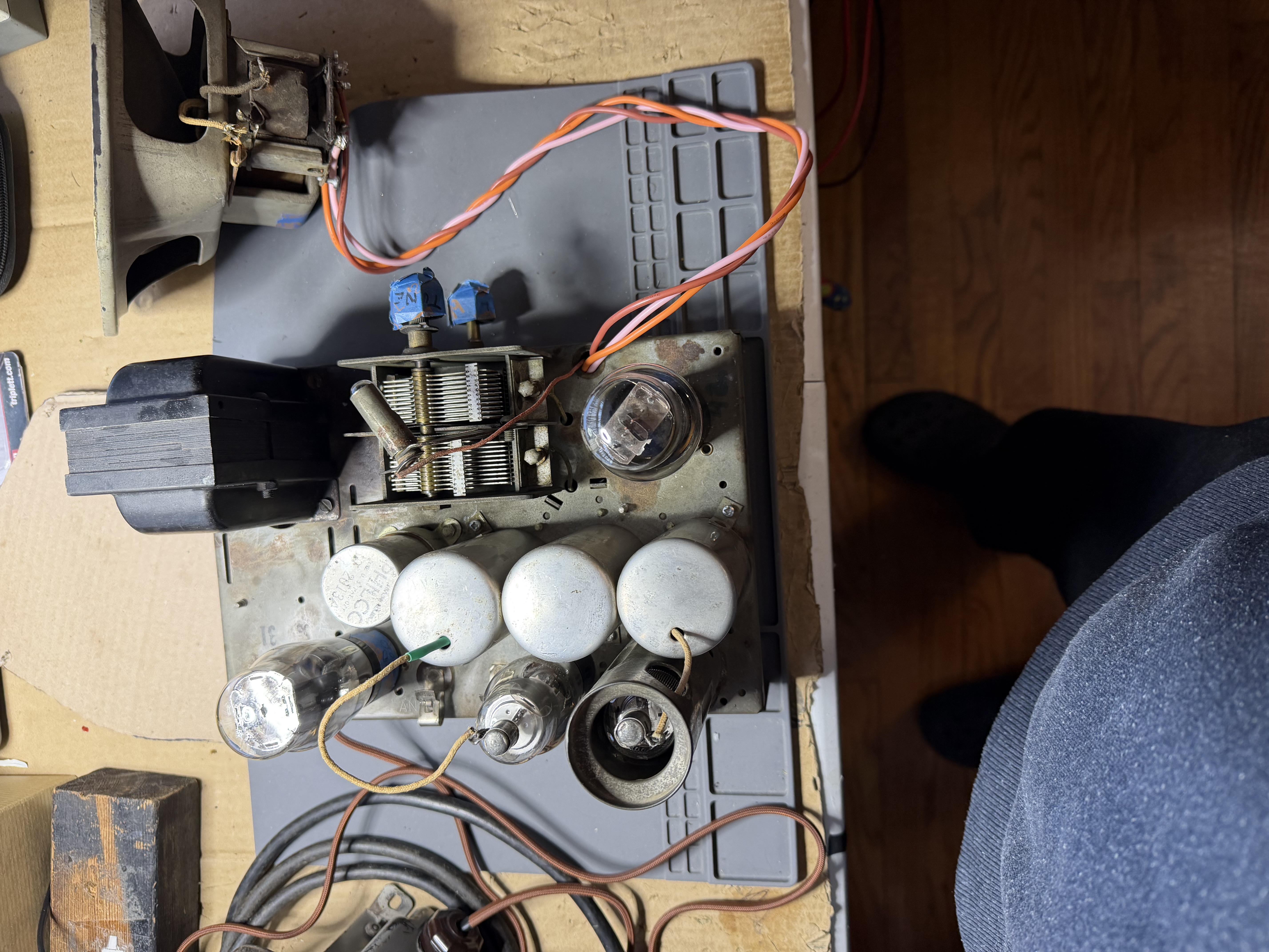

Are there any suggestions on what I should do next on troubleshooting? I do have an oscilloscope and a older signal generator. What areas do you
think I should test. All the vacuum tubes are lit and tested fine on my tube tester. I have attached some pictures and the schematic.
