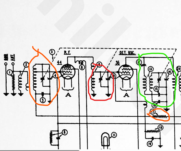

If you have disconnected ALL connections from the tuning cap, there should be NO continuity between rotor and stator OR between different stators.  The rotor is in continuity with the tuning cap (capacitor) frame which is grounded to the chassis.  Review the following link to the schematic:
and the following isolated section of this diagram:
If you are measuring the tuning cap "in circuit", the oscillator section (green circle) would register open circuit, as the coil associated with the tuned circuit has a cap in series with it, therefore you will not see the coil resistance across the stator.  The RF Amp section (orange section) will have a high resistance as there as about 2.5 megohm between the antenna coil secondary and chassis ground (the AVC circuit).
However, the middle section, (red circle) the mixer section will have a very low resistance to ground as the secondary of the mixer transformer (the transformer between the RF amp and mixer) is directly across that section of the tuning cap.
