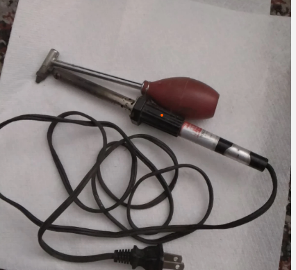

Radio Shack used to make a desoldering iron, about 40 W, tip had an orifice and bulb for vacuuming while heating. One of these days, I will hook up to a vacuum pump.

I used to own an iron which combined a hollow heated tip with a vacuum pump desoldering tool. It was pretty good, but when it died I bought the Metcal.
