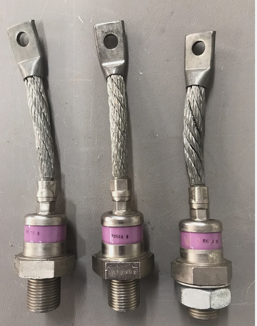

No, no, 1N4148 are good for some small thingies like 80jr.
For a 650 you need these:
Two of them in parallel will just suffice
