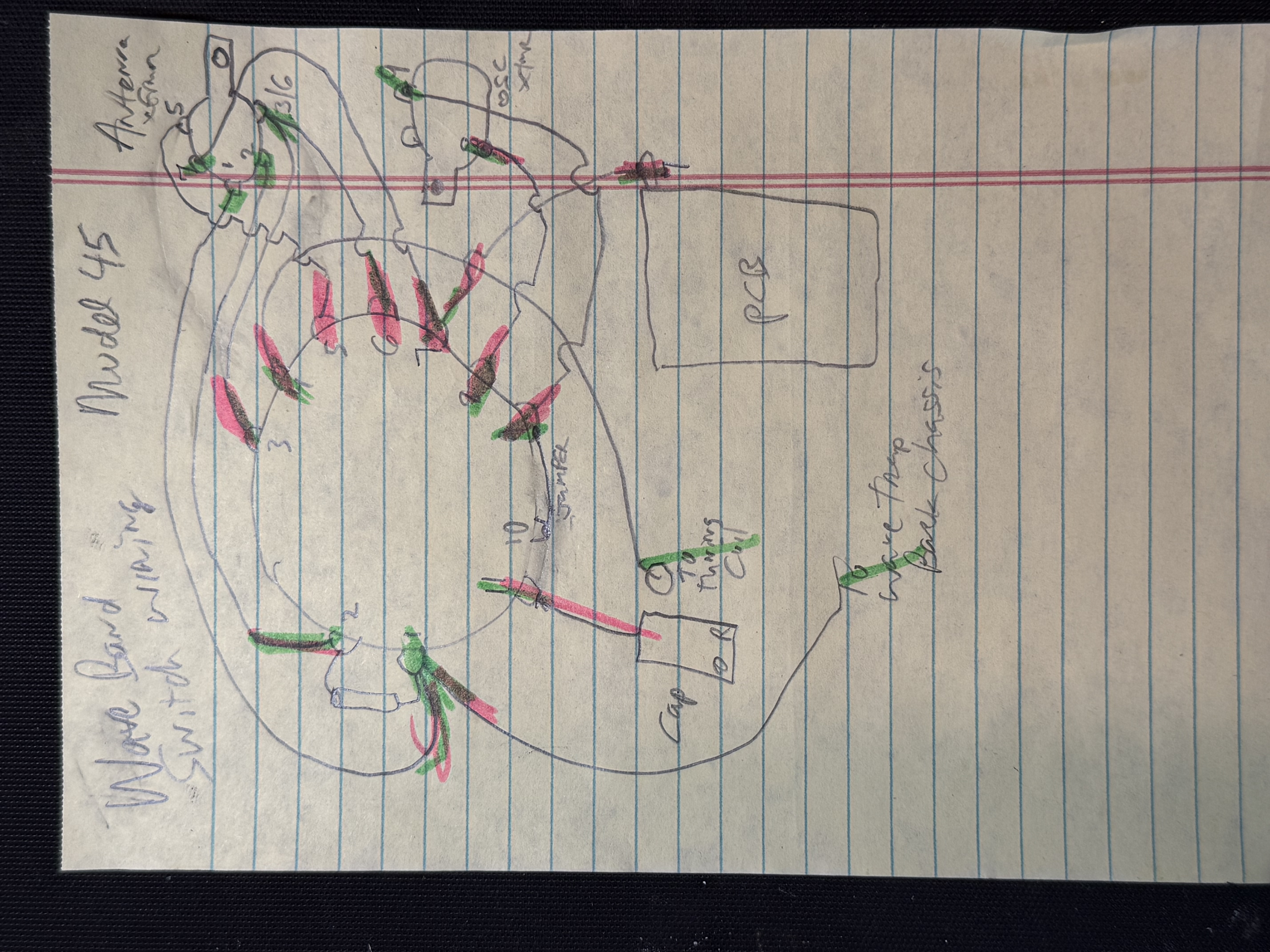

I am working on a model 45 now and I had to replace the band switch.  I have sketches for where the wiring connects if you still need it.
Craftsmanship is an ongoing cycle of learning fueled by patience, persistence, and care, where every project refines our judgment and challenges our skills, in the steady pursuit of the Path to Mastery.
A sketch would be appreciated. I think I have figured it out but verification would be welcome.
Alright, attached is my sketch - forgive the simple approach I took, and let me know if this helps.  I have my chassis still open also so I can take pics of the unit as well.
