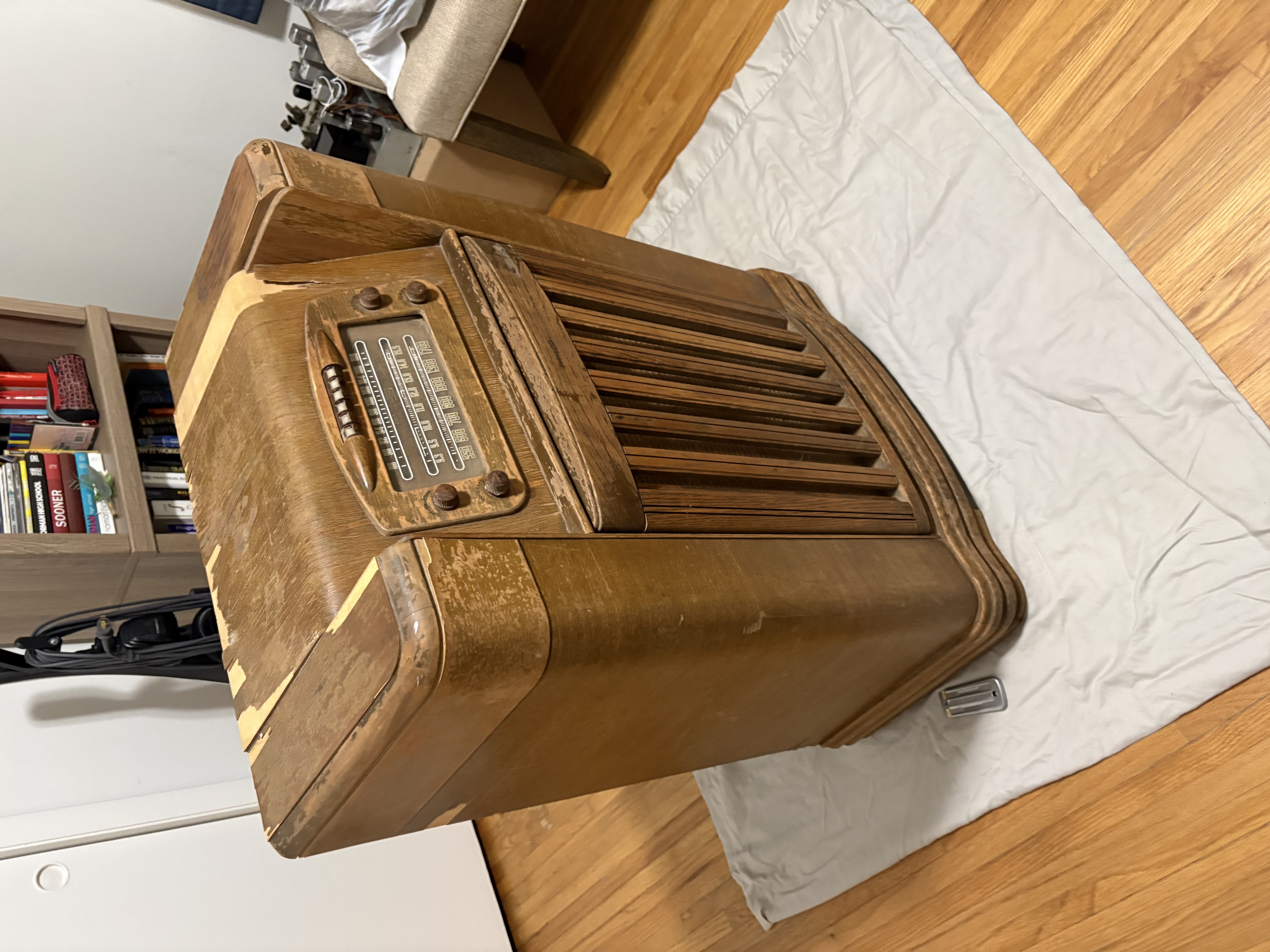

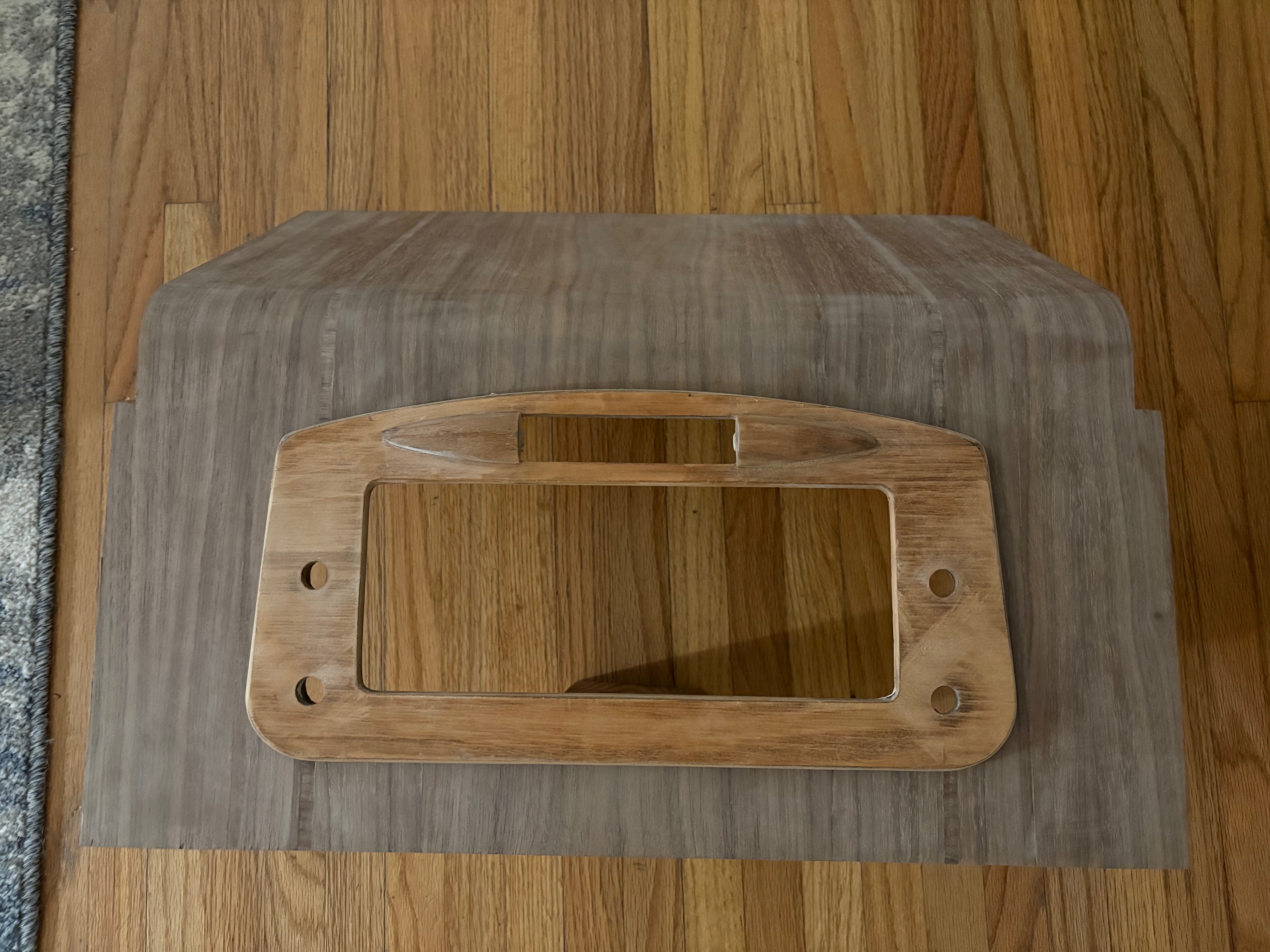

Well, folks. I sure have worked like crazy to restore the front dial panel on this Philco I picked up in Edmond! The veneer on this panel was so damaged that it wasn’t repairable. I opted to remove and replace it. Quite the complex process, because it’s comprised of 16 strips of veneer that have to fit together seamlessly.

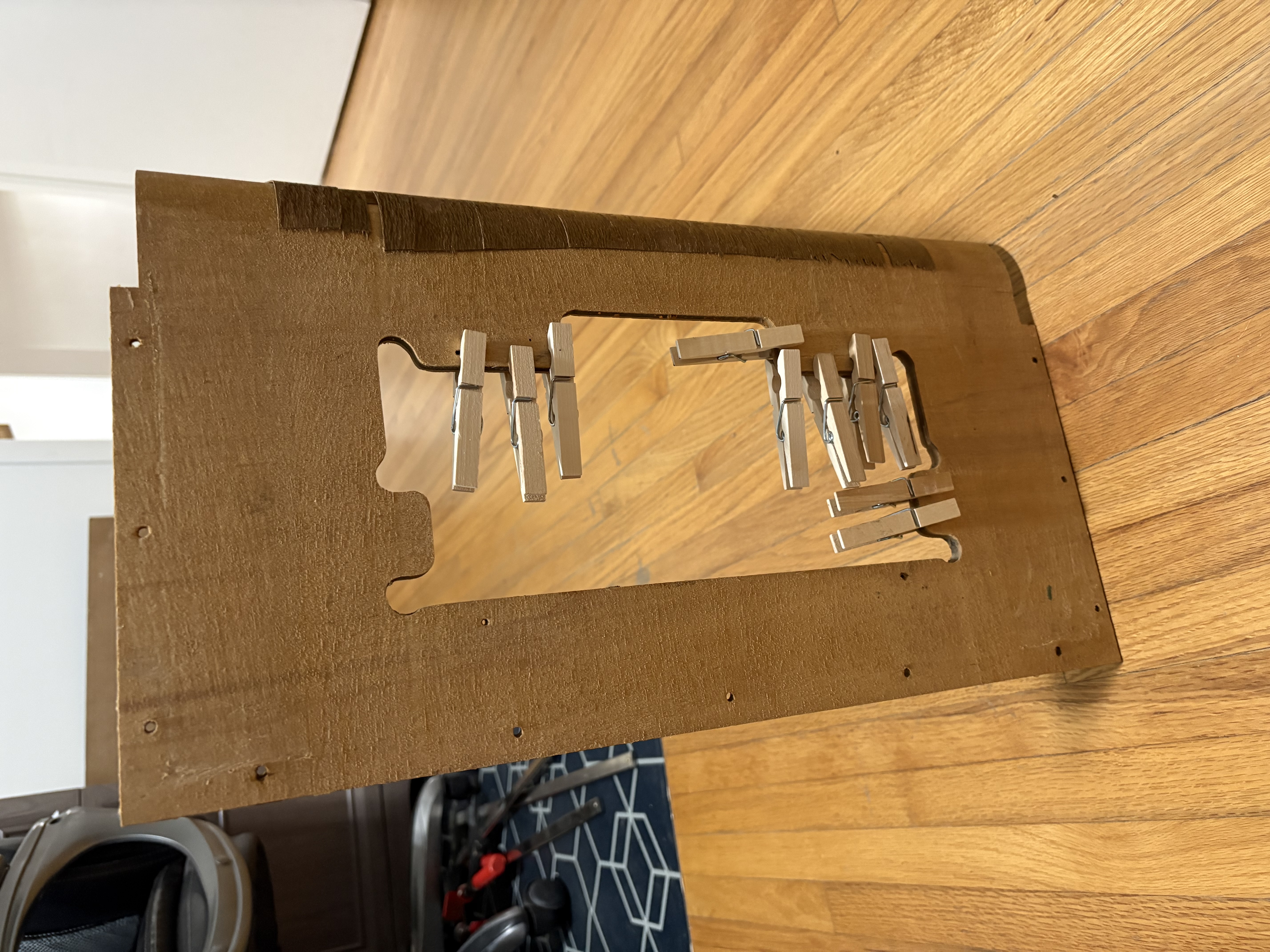

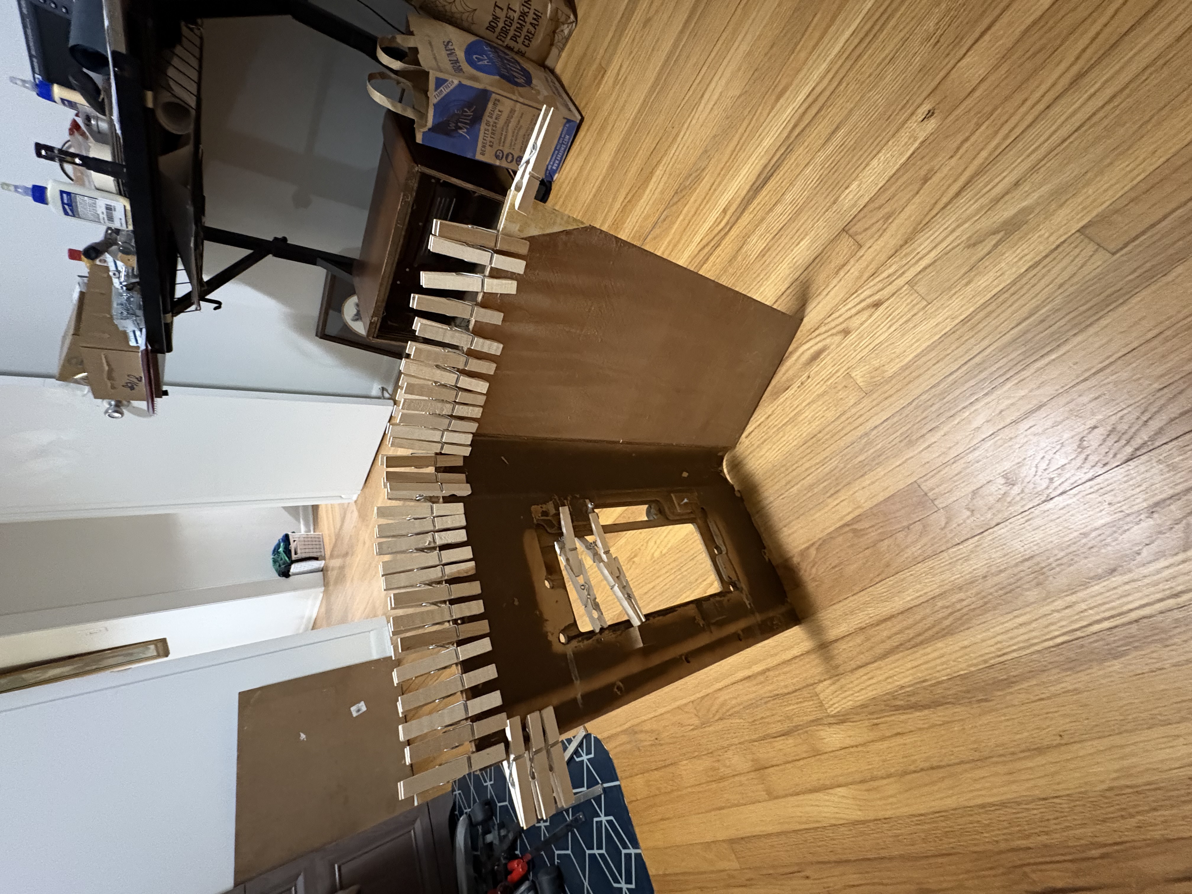

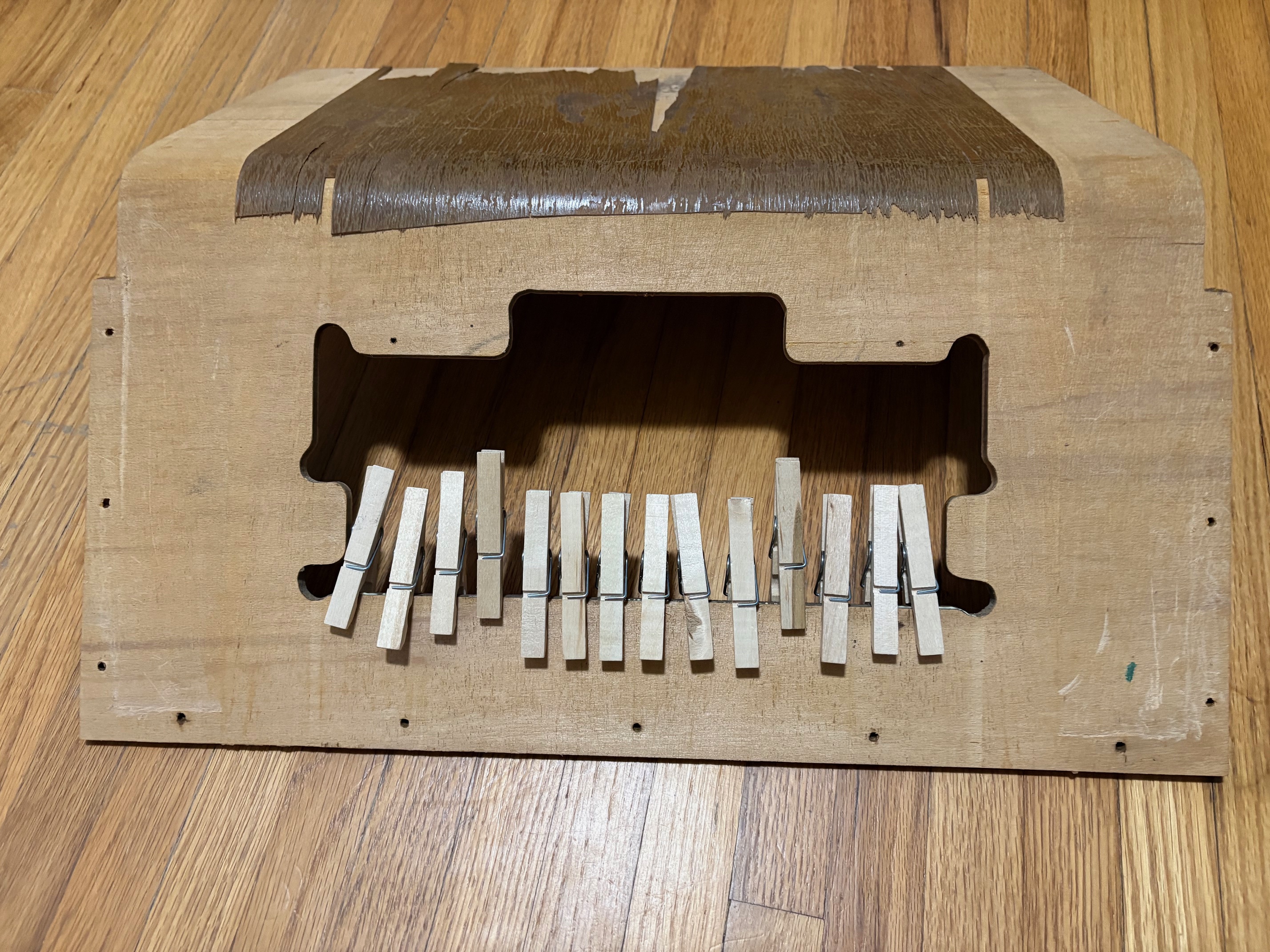

Along the way I had to glue and clamp the underlying plywood in several places, because the layers were delaminating.

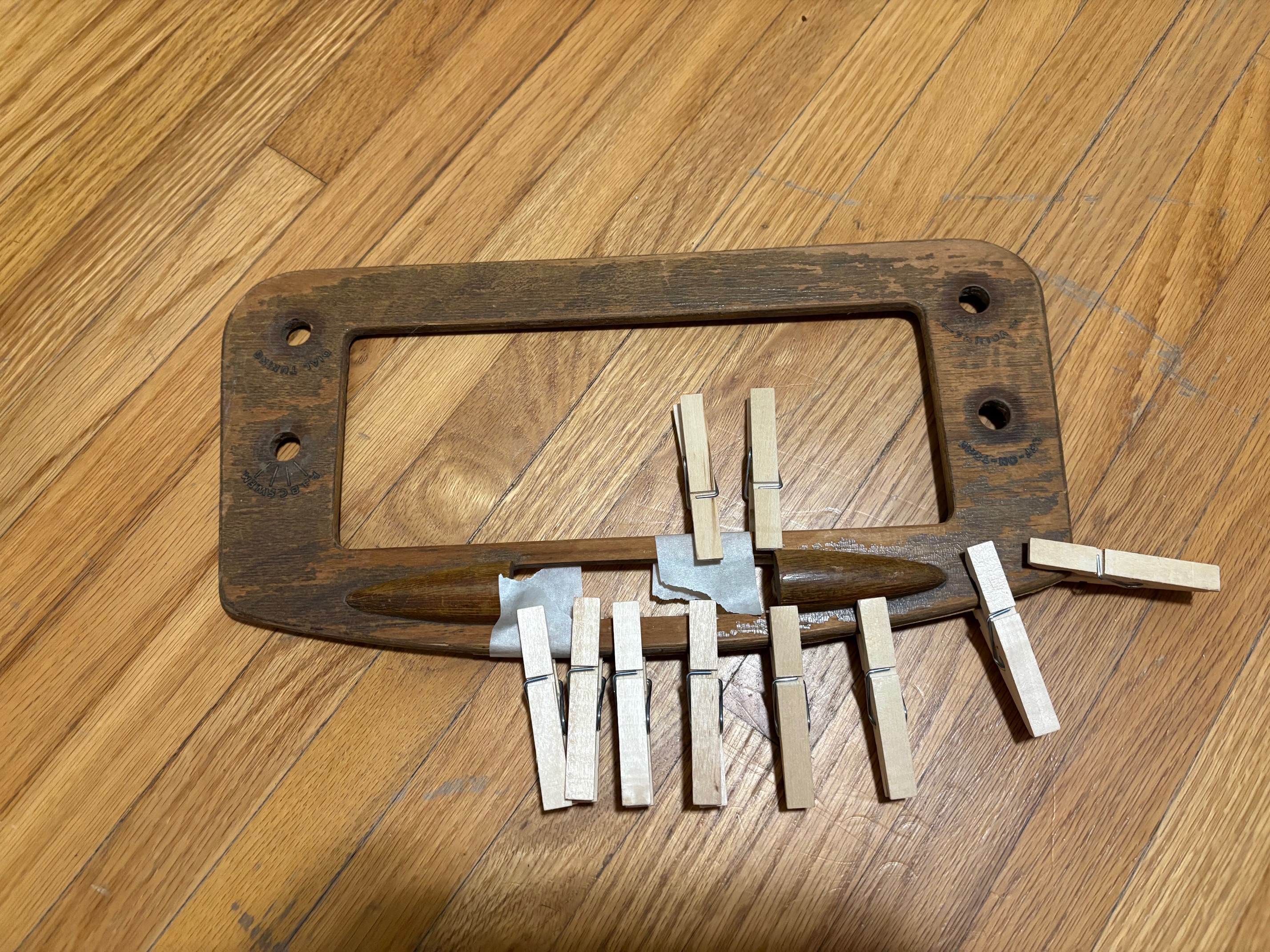

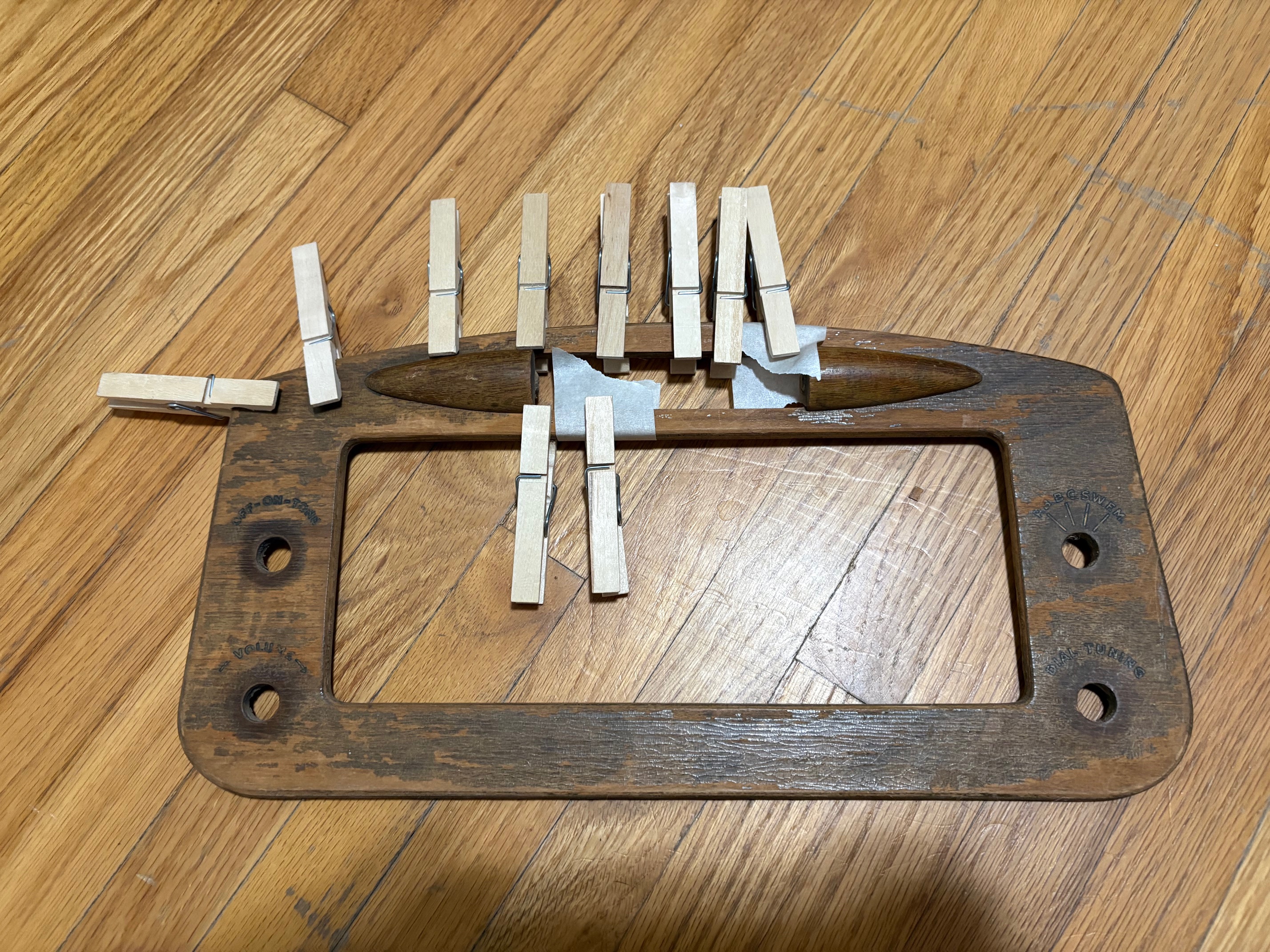

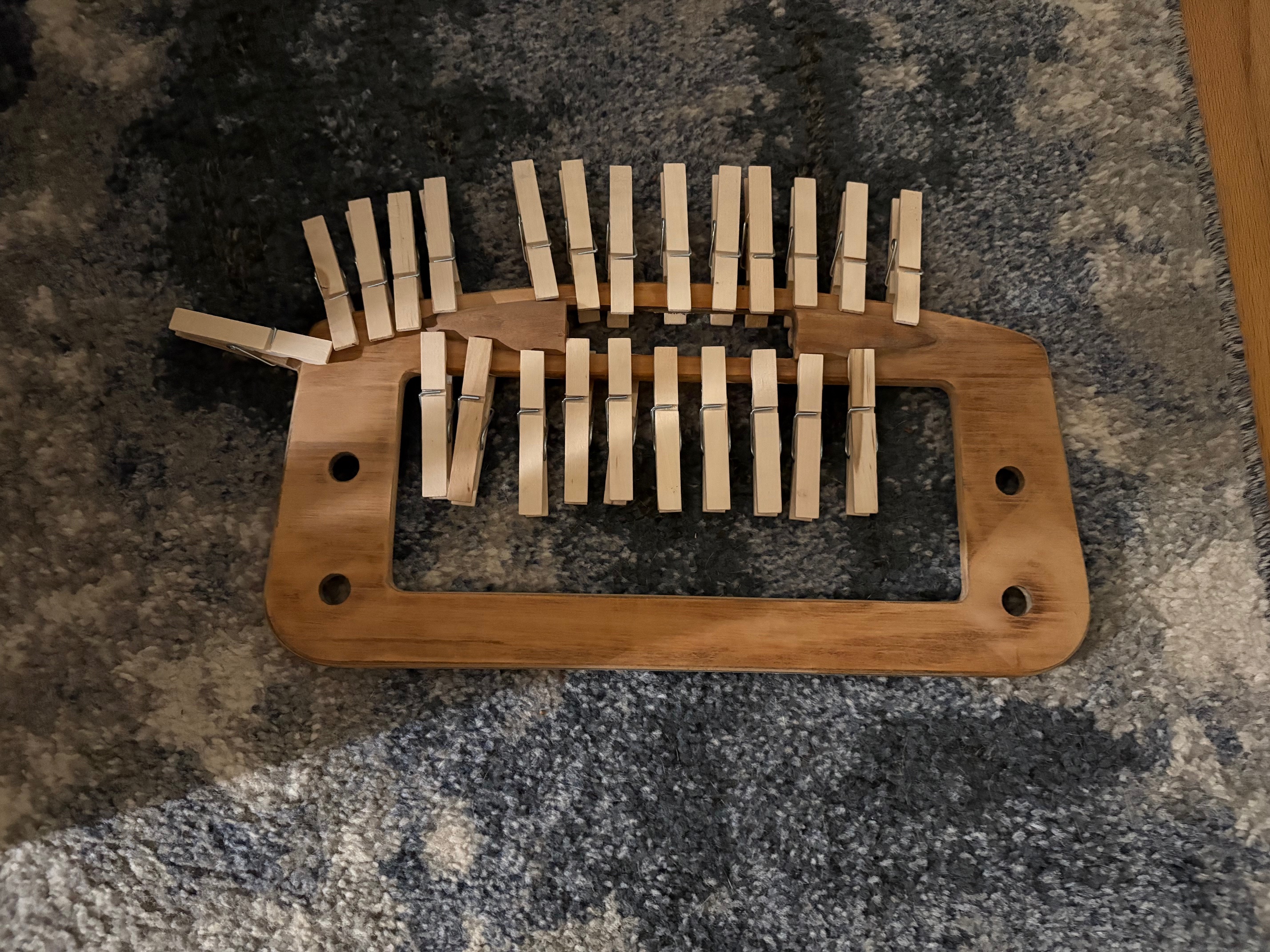

I also had to secure the layers of the dial bezel.

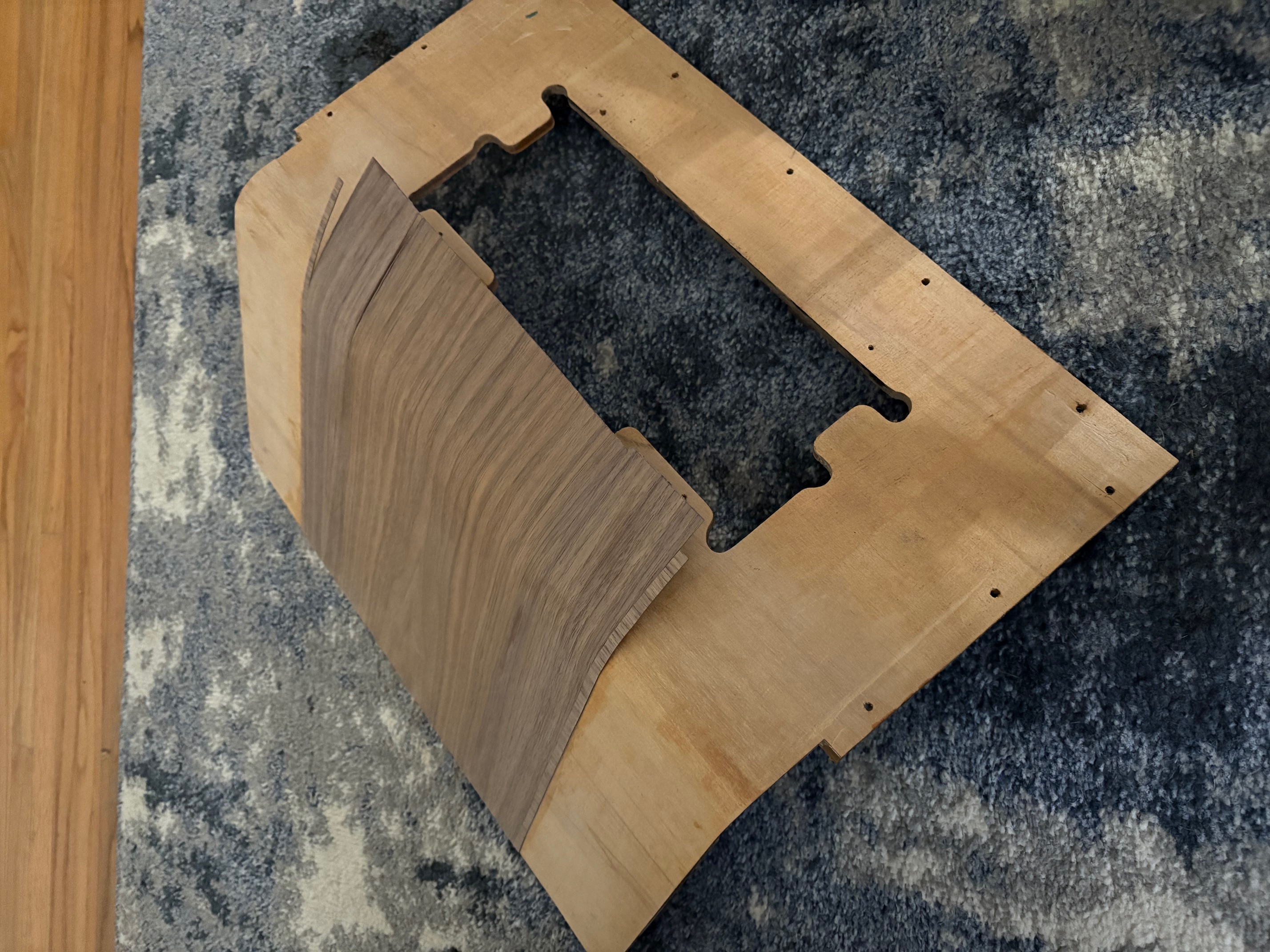

Repairs to the substrate complete, I was able to start replacing the veneer bit by bit.

Goodness, thank you all! Woodworking is certainly a tedious endeavor, but I enjoy the satisfaction when it turns out well. I don’t have any formal training in it, but I’ve always had a couple of projects a year. I can see tremendous improvement from the time when I was in college. Something goes wrong every time, and I take it as a lesson for the next project.

So, is your wife/SO asking where the clothes pins have disappeared to?
Haha, she hasn’t missed them yet!

Ever since we got dryers and stopped putting the linens outside on a wire to dry, the function of the clothespins got redefined.

The veneer scraps from redoing the top should come in handy for patching damage elsewhere on the cabinet. I walked away from cabinet with similar damage, one was a Canadian Westinghouse set that had cracks across the grain on the curve, but the way it was built would have made it harder to take apart and repair then your Philco. I then saw an identical one for sale later with out it, but didn't get to look at it for some reason. Much of the practice I got with veneer was in repairing cabinets from farm battery sets, and sets that were just generally rough, and not worth much.

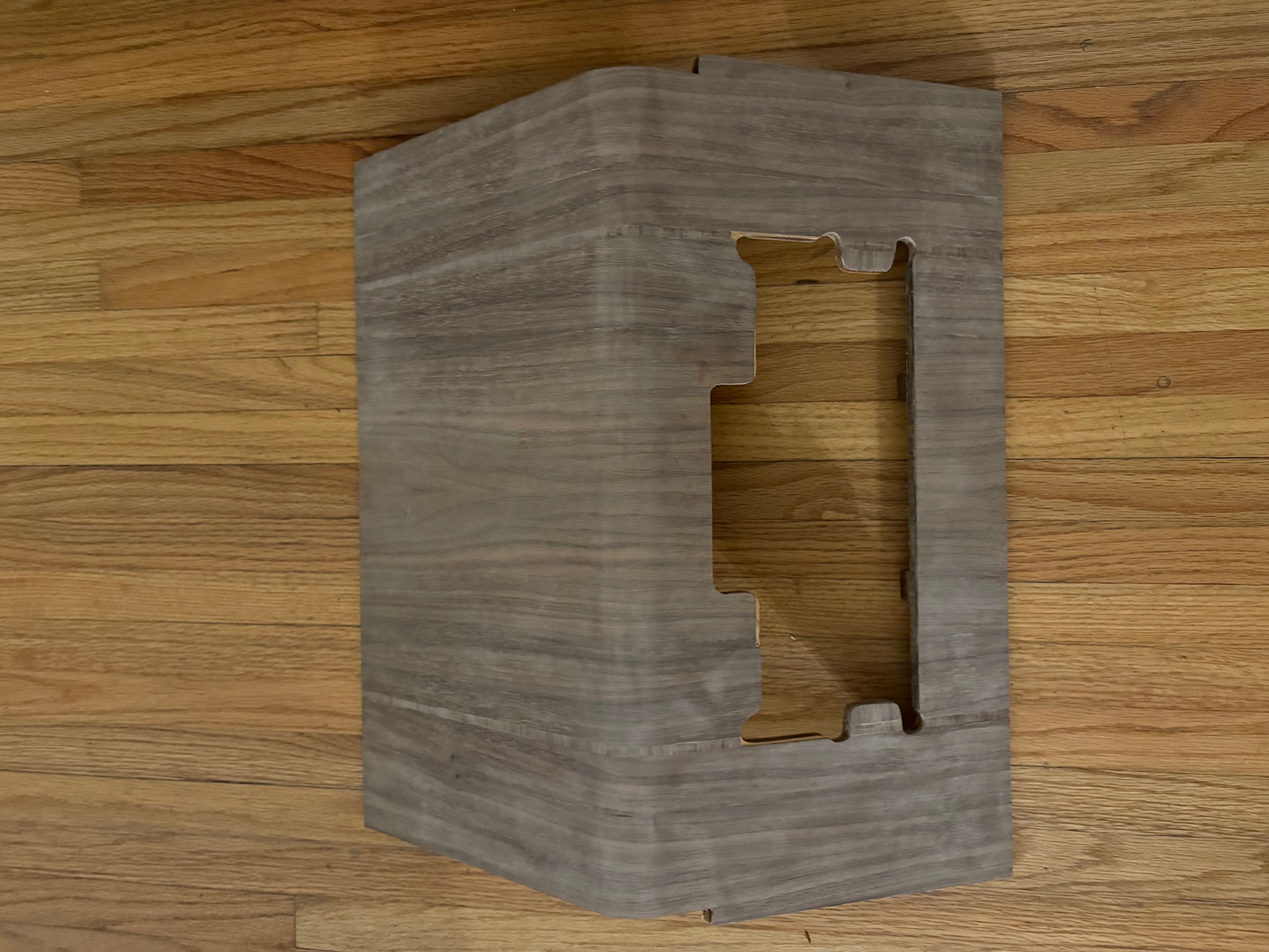

Very impressive Joseph! Icon_thumbup I stand in awe of the work you did. In the last two pictures, is that a one piece of veneer or did you piece it together? I need to be forced by gun point almost to do cabinet work, it’s why I’m selective on what radios I buy. My 37-116 is a perfect example. I restored the chassis when I got it, then the cabinet literally sat for 10 years before I forced myself to refinish it.
